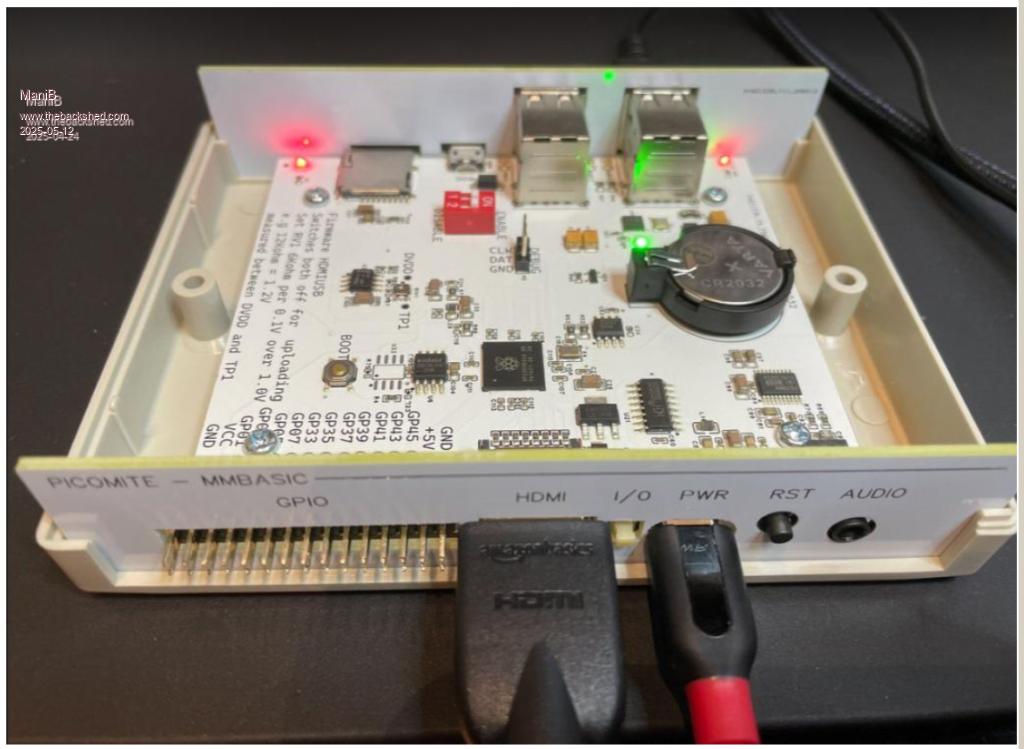

Posts: 12176
Posted: 03:44pm 08 May 2025
This is also an option with a Pico2 rather than a Pico1. OPTION RESET OLIMEX and it is fully configured

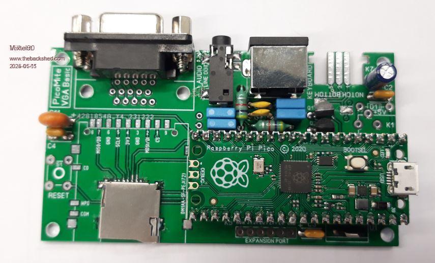

Posts: 9328
Posted: 06:43am 10 May 2025
I've done several weird and wonderful Pico boards. Some, but not all, can be seen by following the link in my sig:
PicoStick jams just about as much as you can onto a stick that plugs into the VGA scket of a monitor.
PicoMite 2X2 gets everything onto a 50mm square board.
PicX is an experimenters board. All the pins are out to connectors and you fit links to use them. There are two small breadboards. The whole thing is 100mm x 100mm to keep it cheap to build.
The list is rather out of date now. I really should put more on. :)

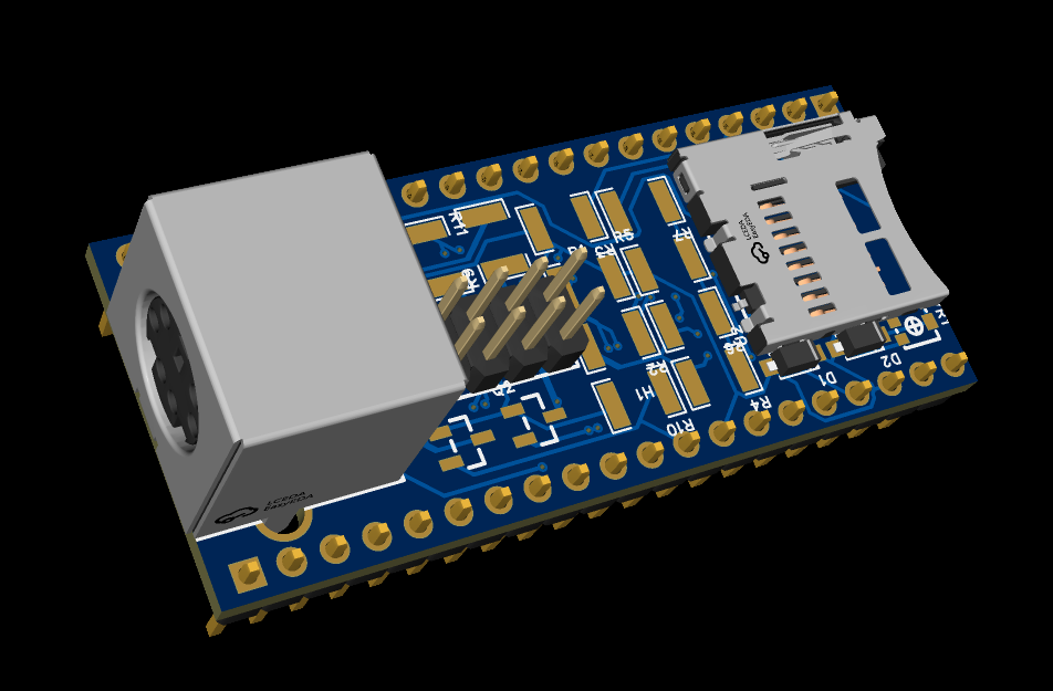

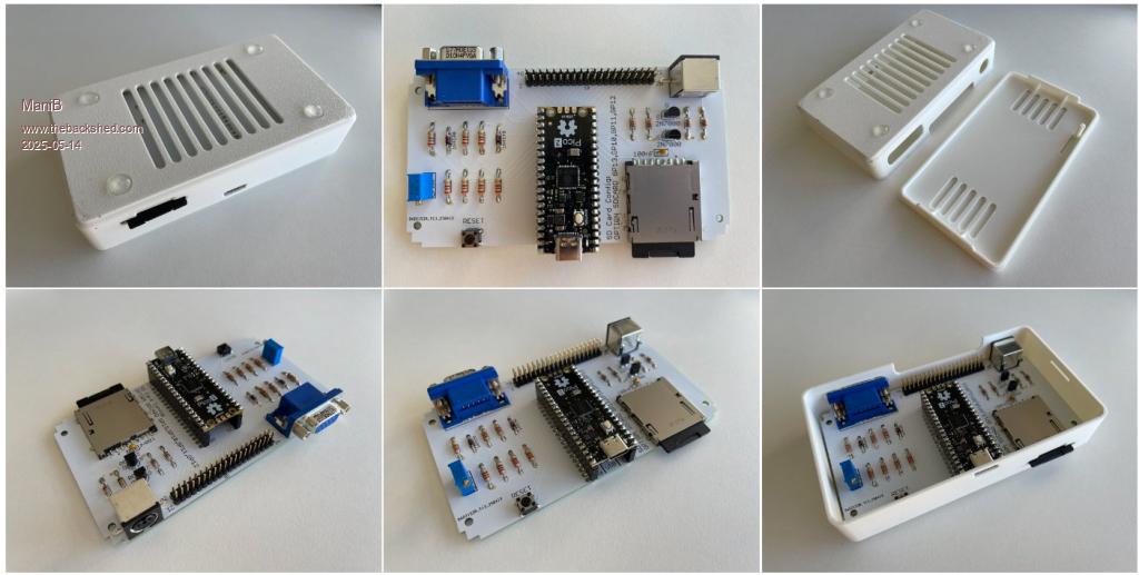

twofingers
Joined: 02/06/2014
Posts: 1785
Posted: 08:59am 10 May 2025
  amiga said  ...Perhaps someone have done this stuff ? ...
Peter designed this; it works well, but it's limited (No keyboard port, serial console only). A case is also available for it. It dates back to the time when RP2350 chips weren't available.
Michael

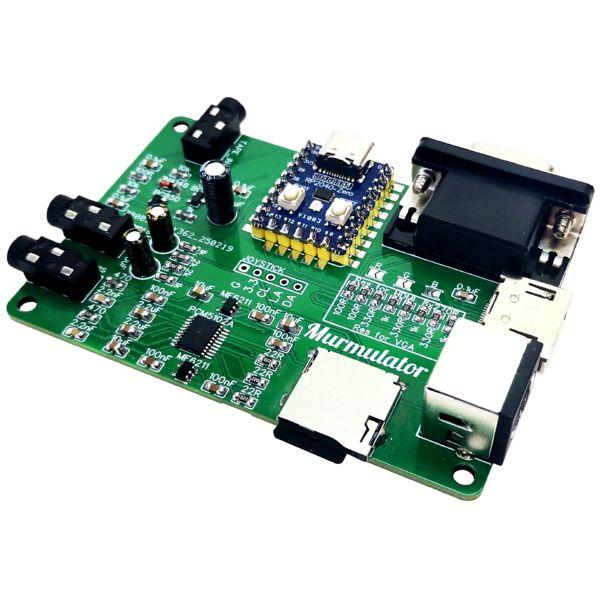

javavi
Joined: 01/10/2023
Location: Ukraine
Posts: 636
Posted: 07:27am 11 May 2025
My PicoMite works great on Murmulator's boards. VGA version on Murmulator 1 boards, and HDMI version on Murmulator 2 boards.

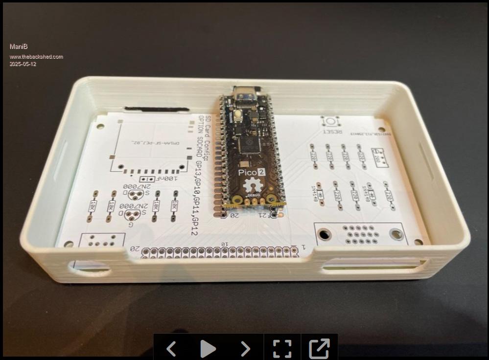

Posts: 9328
Posted: 08:30am 11 May 2025
I still cringe at the idea of DIY using SMD components. I like through-hole and I like to design that way so that I know they will be easy to build. If I'm going to buy a SMD board then that's a bit different. If I had the money then I'd be quite happy with the latest design of CMM2. It blows the PicoMite to pieces in many respects. :)
This works rather well and is flexible. Only PWM audio, but there is a linear regulator.
Having said all that, my latest aquarium controller is mostly SMD, mainly because you can't get really good mosfets with decent power handling in TO92 packages. Not easily available at any sensible price anyway. Such things can be found if you are happy with high postal charges because you can't meet the minimum order quantities.
Hopefully my new soldering iron will help me feel a bit better about SMD work.
While I save up for a hotplate....   ;)
