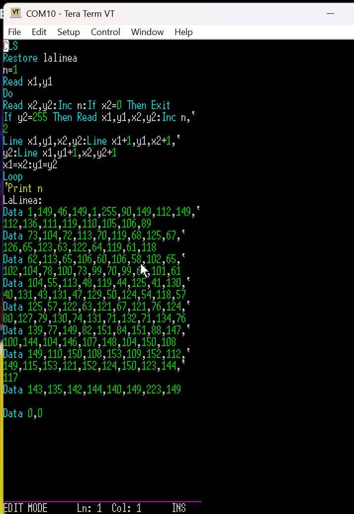

OPTION CONTINUATION LINES ON/OFF/ENABLE/DISABLE
This is a permanent option but doesn't cause a reboot
When enabled it changes behaviour as follows:
The back single quote character chr$(96) is used as a line continuation when it appears as the last character on a line.
The LIST command and EDIT commands will automatically insert line continuation characters when used. This will be inserted at a space or comma character if possible or at the last displayable character as defined by OPTION DISPLAY.
All text in a program will therefore be viewable in the editor
When in the editor you can use the line continuation character to split lines. However, on saving these effectively disappear but are recreated when the program is listed or edited. NB: They may not therefore be in the same place.
When you use EDIT fname$ continuation characters are created as the file loads and then removed again when the file is saved.
The way that this works is that the tokeniser effectively strips the continuation characters out of the program and joins the lines. The normal maximum line length applies. When editing/listing the saved file, the new functionality inserts the line continuation characters as described above.

As it appears in the editor with a line width of 40 characters
