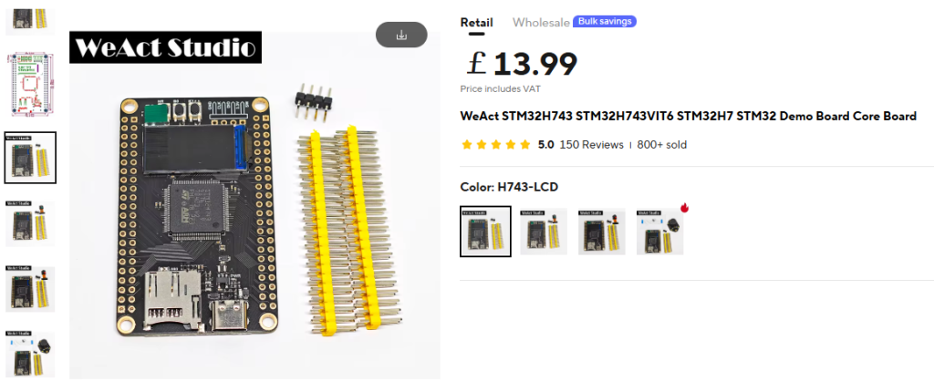

You haven't got 512KB of RAM anyway. A chunk is used for MMBasic operations, including the variables table. Then you have any framebuffers for the video. In fact, the RAM area is so full that at runtime the user program runs from flash. It is only in RAM while it is being edited, at which time it is overwriting the area used for variables.
If you need a lot of space when using MMBasic then the CMM2 is the way to go, not the PicoMite. :)
vincenthimpe
Joined: 14/10/2018
Posts: 86
Posted: 09:02pm 29 Apr 2025
That's not a microcontroller... i want something small, near single chip. don't need video output and usb host.
Think 8051+ft232 small.
Rpi2040 is cheap and small with lots of i/o
That H7 processor is a humongous tqfp.

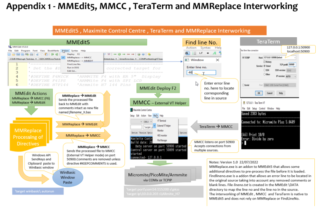

Posted: 10:07pm 29 Apr 2025
Maybe a compiled language such as C.
Or a preprocessor / transpiler - akin to Tom's (thwill).
Or a work-around as posted already.

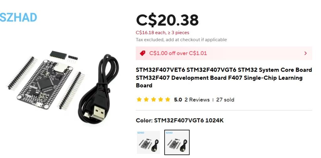

Posted: 11:39pm 29 Apr 2025
  vincenthimpe said  That H7 processor is a humongous tqfp.
Maybe you would want to look at the STM32F407VGT6 Development Board:
https://www.aliexpress.com/item/1005006882009420.html
If you go that way, make sure you order the VGT6 version.
can it run MMBasic ?
Even then. i'm rolling my own board. (there lots of other stuff i need)
Yes
Lots of threads on STM32F4 CPUs and Armmite
Also on https://fruitoftheshed.com/wiki/doku.php?id=start
Various STM32 boards etc are supported.
