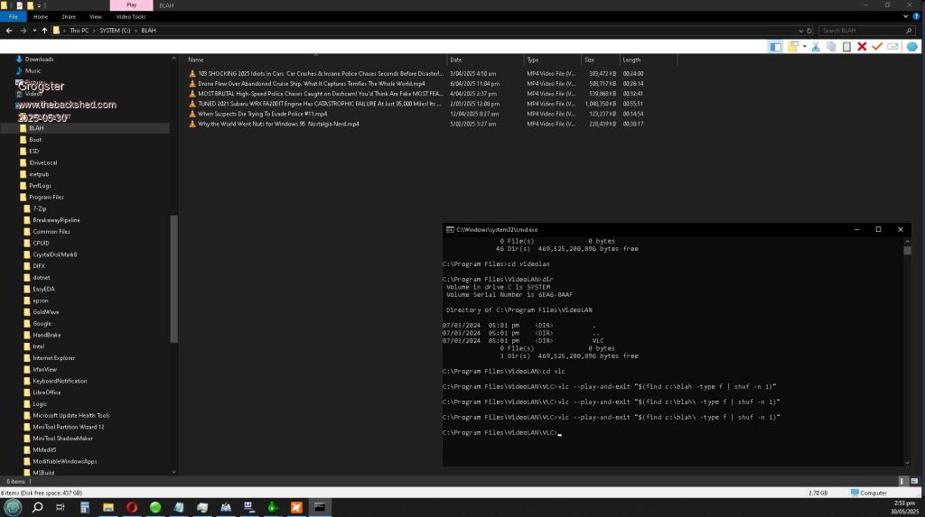

Just following up on this a bit more, and I can't make it work.
I'm back in W10 for this testing, as the PI5 idea does not seem to want to work with video playback, which is a bit of a shame, but I digress.
I do get a quick black window popping up, but then it vanishes again, no error message, no VLC running in the background or anything like that.
I threw a handful of videos into C:\BLAH folder, and tried to point VLC there using the example posted above, but no dice.
I can play any of the files in BLAH, by just double-clicking them as you would expect, and they open and play just fine with VLC, so there is something I am not doing right here.

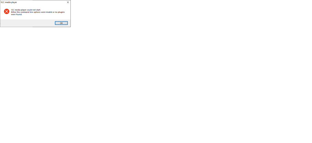

Tried it and also just a blink on the screen. Removed the -and-exit from the command and this error message remained.
"ERROR: VLC media player could not start
either the command line options were invalid or no plugins were found"
