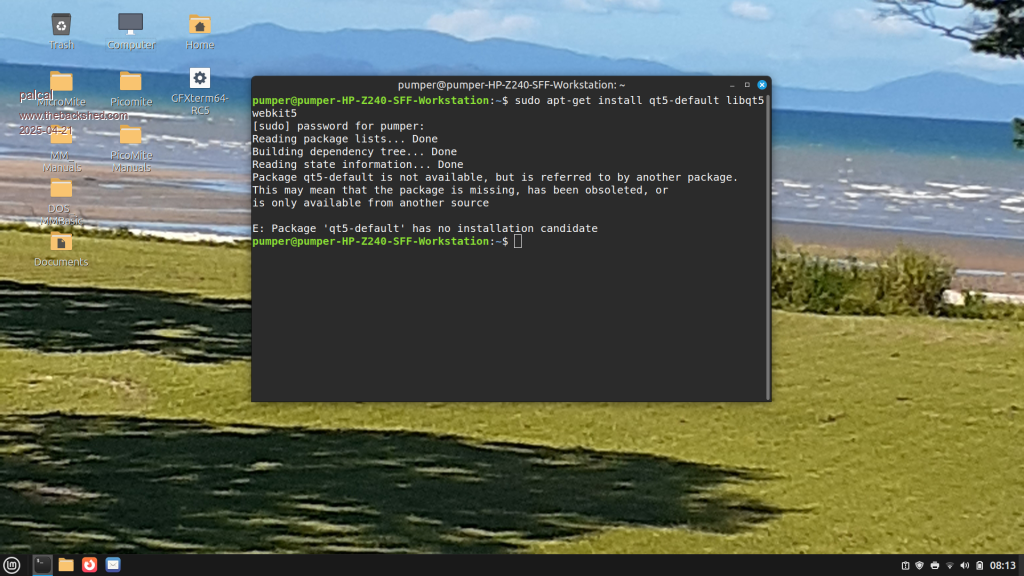

Assuming you have extracted the files from the archive,
Have you run
sudo apt-get install qt5-default libqt5webkit5
if so, were there any errors?
If you don't have qt5 installed, MMEdit will not run.

Jim, This is what I get..

OK, I think that you are running a later kernel so try this:
sudo apt-get install qtbase5-dev
as per the readme.txt file in the main archive.
Linux isn't good for backward compatibility.

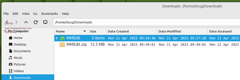

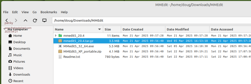

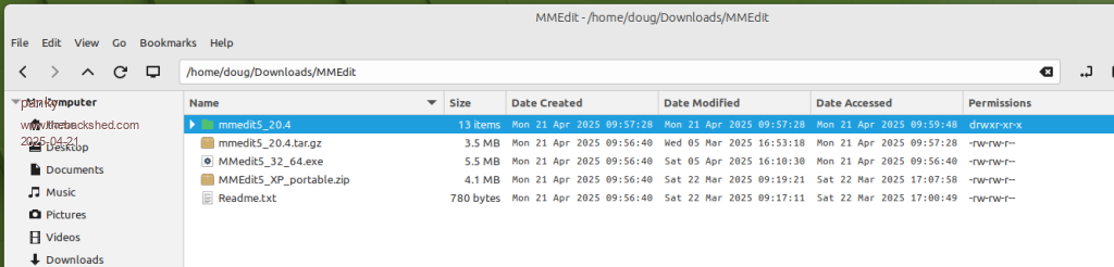

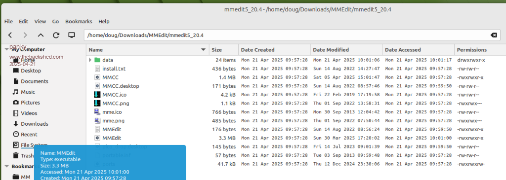

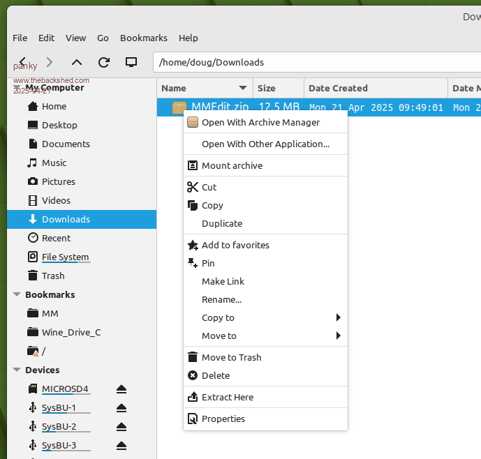

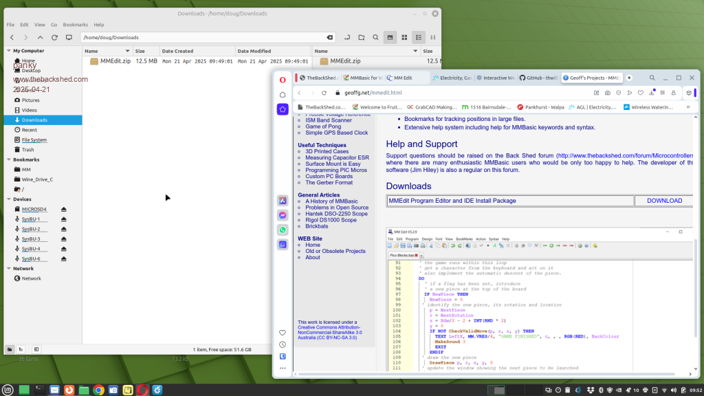

It's a little hard to analyse without sitting beside you but the following is what I did this morning to demo. I am running Linux Mint 20.3. Ensure you do not have MMEdit in your Download folder so this can be a clean install.
1. In a browser, go to Geoff's site  geoffg.net and select MMEdit IDE for MMBasic
This will download the file MMEdit.zip to your Download directory. You now need to extract the Linux version be selecting the file, right click and choose Extract here
You now need to select the .tar.gz file and extract MMEdit5

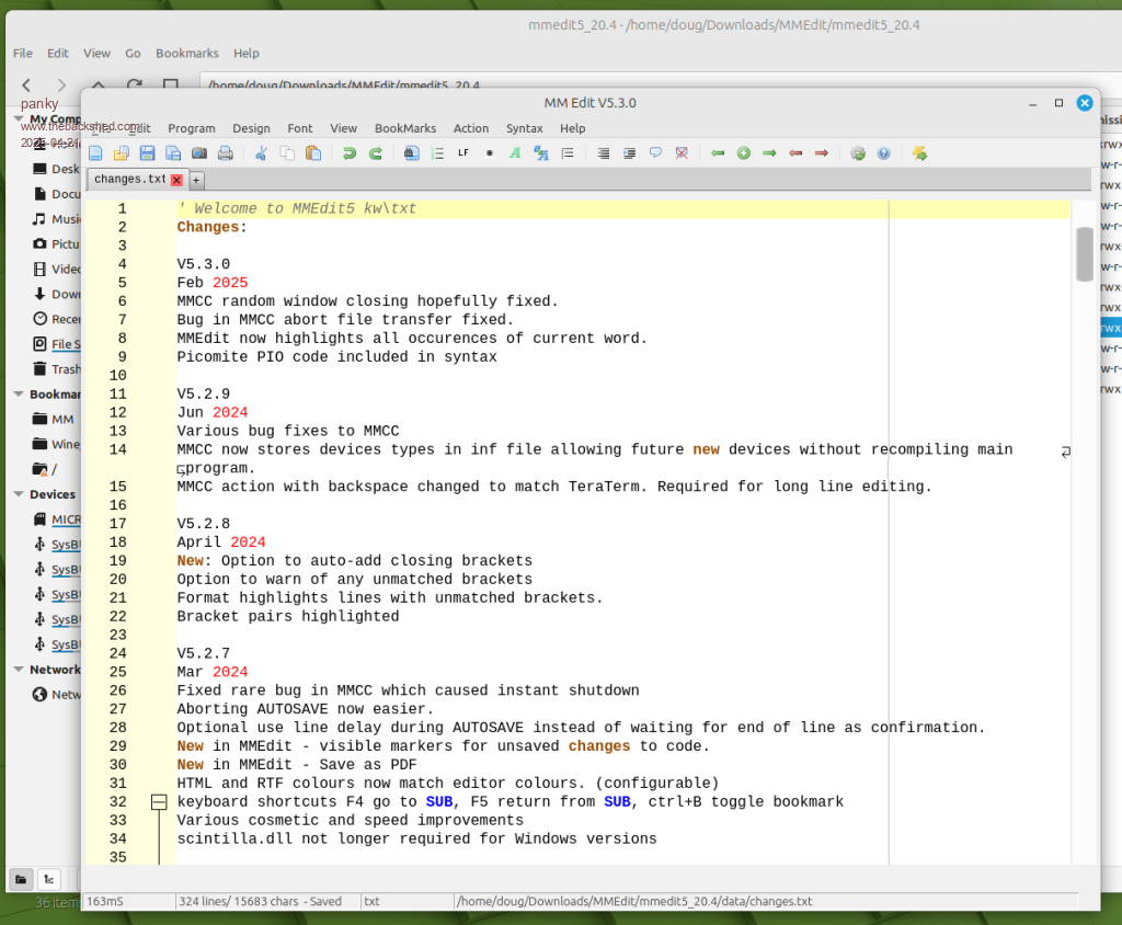

You should now have a folder  mmedit5_20.4  Inside this folder you will find all the MMEdit5 files.
You can now open (or double click to run) the mmedit executable file. Make sure you select the large 3.3MB version. The small 176byte mmedit file is for your desktop (don't worry about this yet - lets just get mmedit going)
This should result in you seeing MMEdit5 on your screen!

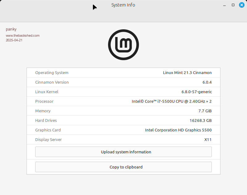

Posted: 01:27am 21 Apr 2025
Paul,
A slight update - I am running Linux Mint 21.3 not 20.3 - unsure as to what impact this may have. Can select System Info from your main menu as shown below to provide complete details of your version?

Jim,
    Linux Mint Cinnamon 22.1

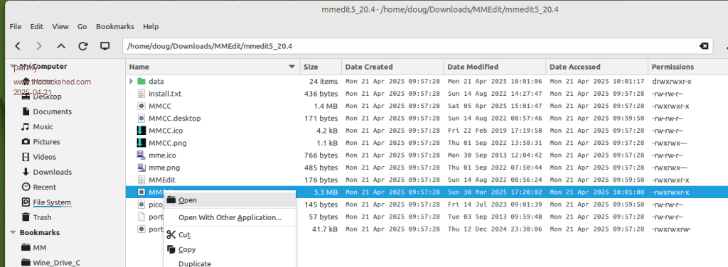

Posted: 02:04am 21 Apr 2025
Also ave the same problem,
In the drop down list it has Execute, not RUN like the picture above.
Distro: Linux Mint 21.3 Virginia base: Ubuntu 22.04 jammy

@ Revlac,    I can't see where you mean.
Revlac
Joined: 31/12/2016
Posts: 1310
Posted: 02:32am 21 Apr 2025
Right click on MMEdit and see the list...Sorry cant get a screenshot like the one above...

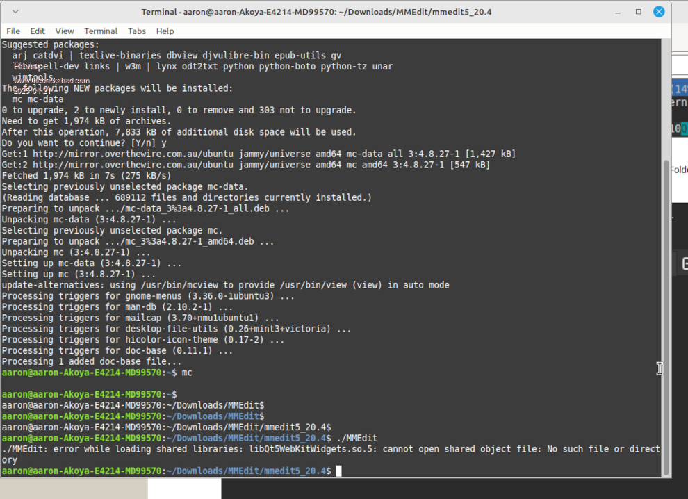

Let's take a step back and install Midnight Commander (https://midnight-commander.org/), which is a Norton Commander clone for Linux. It will allow you to easily navigate your system as well as being a huge help in maintenance and troubleshooting.
To install mc open a terminal and type this:
sudo apt-get install mc
Once completed, type mc in your terminal and hit enter.

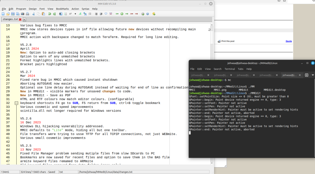

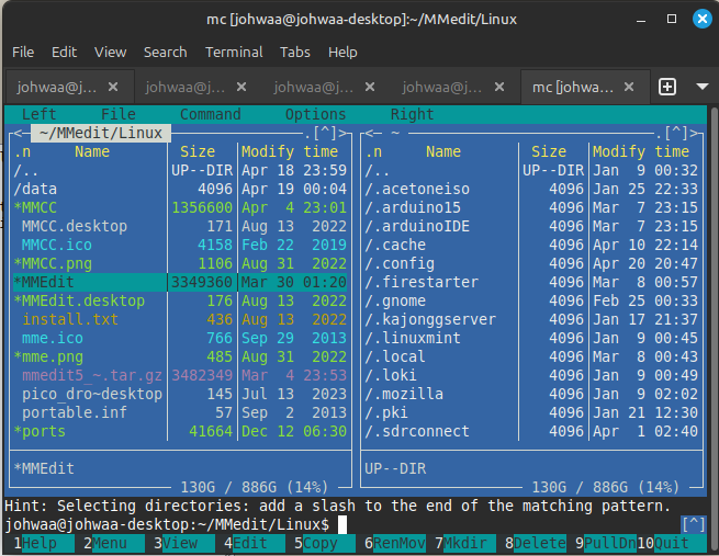

If you haven't already unpacked MMEdit, please do so. I put mine here:
Then hit Control-O to toggle to the terminal display (hitting Control-O a second time will bring you back to the Folder/Default view). It (will shortly) look like this:

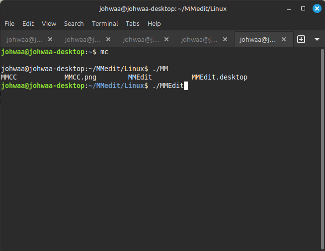

Type in ./MMEdit (or as I did ./MME and then I hit the TAB key). Please note that you need the preceding ./ for bash to find MMEdit since this folder is not included in my PATH.
So please do that and hit enter. This is what you are not likely going to get:
Your terminal will now act as a connector to MMEdit, and any error messages should be displayed in the terminal before MMEdit crashes and closes. Please show us what it is complaining about.

Posted: 03:20am 21 Apr 2025
Thanks  SimpleSafeName
That MC is nice,
Didn't see this before,
libQt5WebKitWidgets.so.5
Will check back later have other work to do now
