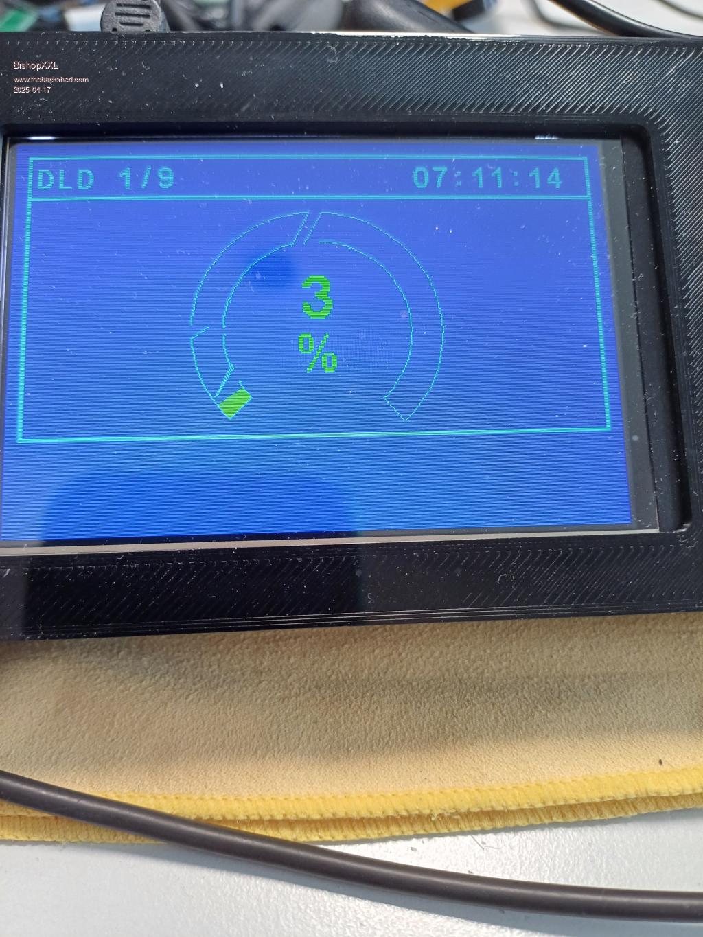

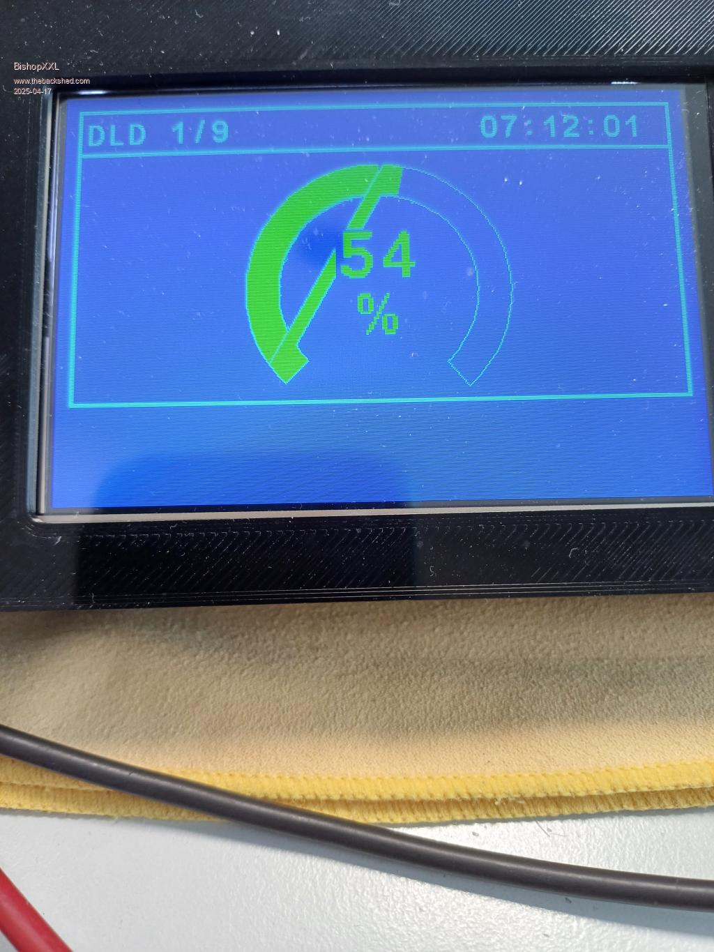

I have a small error in my "GUI Gauge."
Has anything changed in the syntax?
"GUI Gauge 13,240,160,100,RGB(Cyan),RGB(Blue),0,100,0,"%",RGB(Green),RGB(White)"
Or is the GUI no longer a relevant component?
I'm grateful for any advice!

Works fine on a Waveshare ILI4488W display and standard ILI9488 under RC15

I have a "Cheap Chinese Red 4-inch TFT" from Amazon.
That could be the problem.
If you're using a 3.5-inch TFT, I'd get one of those.
What surprises me is that the identical source code runs on
V6.00.01 and not on V6.00.02RC15.
The error is often between chair and keyboard
I'll try something out.
And if it doesn't work, I'll go back to V6.00.01.
or buy a Waveshare....
THX!!!

This is serious problem. This has nothing to do with how the display is connected to the pico, nothing with high and low levels. Data in RAM (or in flash) is corrupted.
Bishop, we need your full program (assuming you did not type this GUI line from the commandline). Did you do clear/nuke the flash before you programmed and configured RC15 ? Do you have anything in a flash slot, or the library of the pico ? Note that tokens have changed, and your code could therefore be corrupted when in flash or library.
You could try to restart the pico, and type the same line from the commandline, and see if you have the same result.
The screen size should not have any impact on this. It looks like coordinates of segments of the circle are corrupted, or wrongly calculated. And why ? Did you use the temporary function OPTION TRIG FAST ?
Since the display is not a vector display, individual pixels are send to the display. This type of error does not come from the display, it is math error, or memory corruption.

I've managed to reproduce but only on the RP2350. There is no change in any of the relevant code but there was a change to the Pico sdk. I need to investigate further in the meantime I would avoid this command. The implementation of GUI gauge is somewhat clunky so it could be a floating point overflow issue which could explain the difference between the RP2350 (H/W FP) and the RP2040. Other massively complex programs with FP calculations do not exhibit any differences and MMBasic commands are protected against overflow/divide by zero etc. so I'm not concerned about a generic issue.
The MMbasic ARC command is a much better implementation so I may just recode GUI GAUGE but that is quite a big task

This is very strange. It looks like a bug in the sdk sinf and cosf functions on the RP2350 in the latest sdk (these are the single precision versions). The sin and cos functions work fine

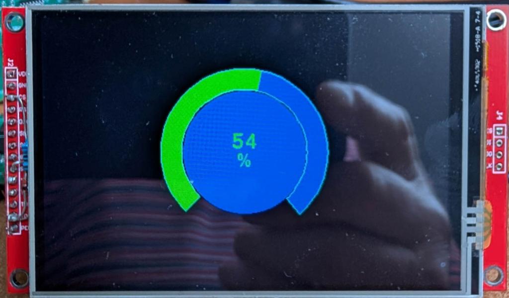

@Peter,
Now I am stupid of coarse...
But I tried above GUI GAUGE on a Game*Mite that I modified with a 2350A.
Running RC15 (yes, just to duplicate the issue, curious).
And it is exactly the same on the ILI9341
Gui Gauge was not detailed out in the 6.00.01 user manual. Is it supported at all ?
I found something in the CMM2 manuals... Now I know how it works.. Sorry for the confusion.
