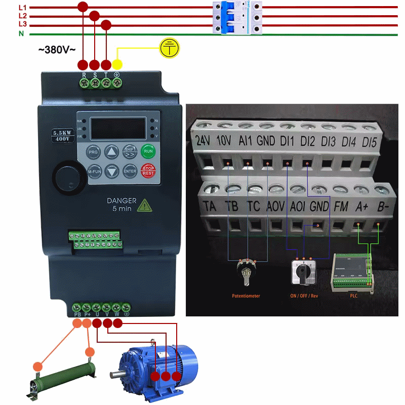

Just an FYI:
I noticed that VFDs are insanely inexpensive on AE and so I grabbed a 2.2KW unit to play with. Hooked it up to an old Bridgeport knee-mill spindle-motor and I am totally impressed.
So many possibilities with these devices. They also have a flux-vector mode and so I think I'll grab another one and mount an incremental encoder on the motor-shaft to see how the PicoMite can perform at closed-loop position control. This was <£50 delivered.

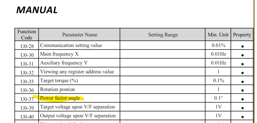

I just found this in the manual but no explanation of how to use it. I have sent them a message.

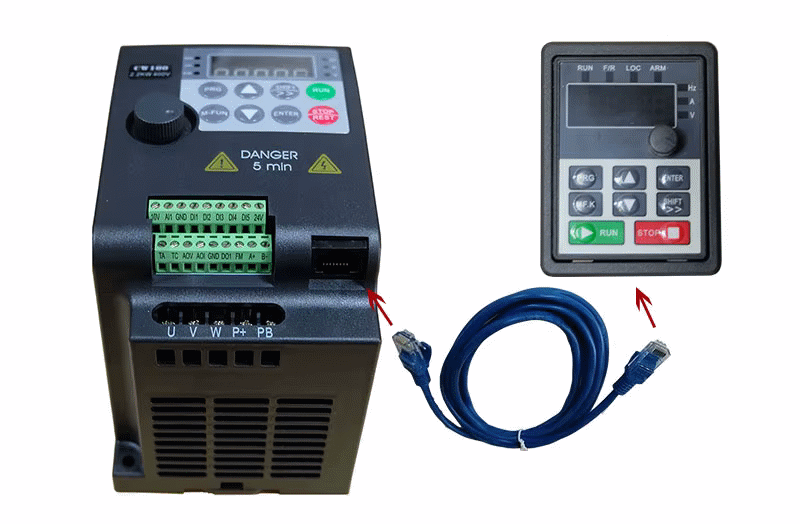

LANDRIVE CW100
I also went with the remote controller

Posted: 01:09pm 15 Apr 2025
What does "Danger 5 min" (below the screen and control buttons) mean or refer to?
(This stuff is beyond any use I will ever have, but I do like seeing it explored.)

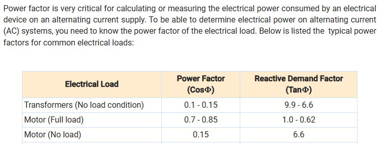

Hi Harm,
Glad you brought-up the Power Factor thing
So the item in the table is an actual monitor and I'm seeing 78° lag
Power Factor = cos(78°) ≈0.2079
Bit horrified at this but I checked typical Power Factors for DOL (direct-on-line) induction motors:
My tests are also "no load" as I can't test under-load just yet.
Source

  lizby said  What does "Danger 5 min" (below the screen and control buttons) mean or refer to?
I think it means it contains hazardous voltages for 5mins after power off?

Yeah, capacitors
