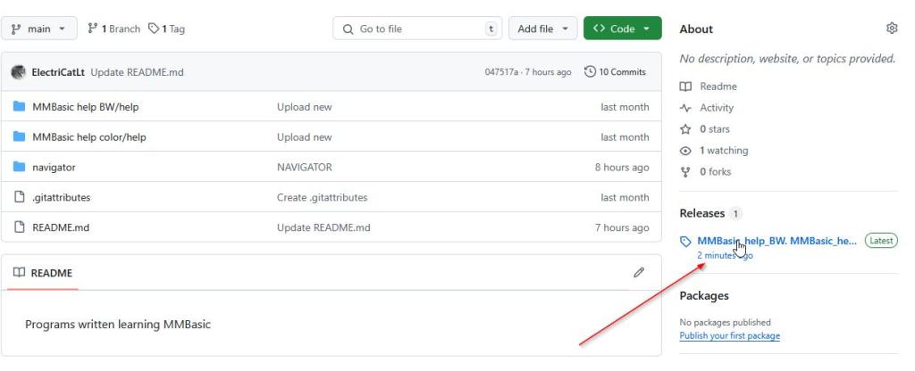

I just checked my signature 'My MMBasic 'sand box'' from another browser without github logins, and all seems to be downloadable. Please report if something wrong.
Posted: 12:23pm 14 Apr 2025
I also could not download from github (until I went up the tree to ElectriCatLt/MMBasic).

Oh..
I added releases for more easy download.

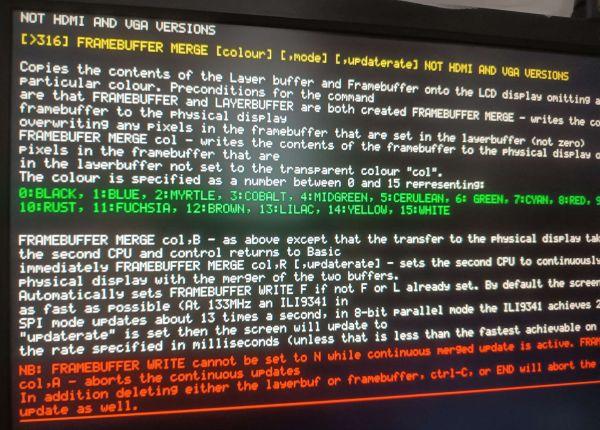

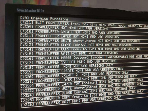

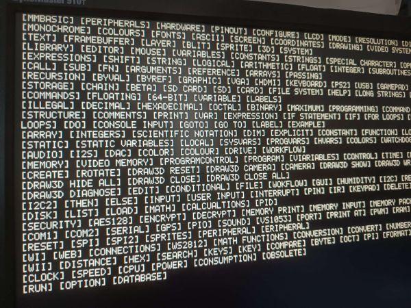

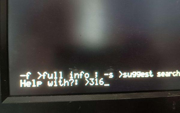

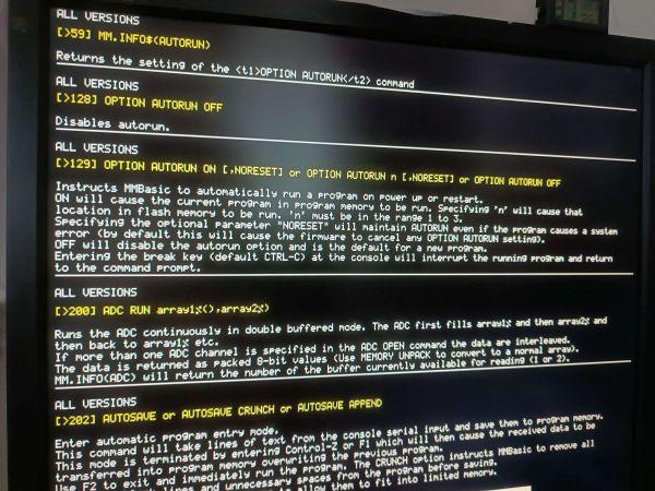

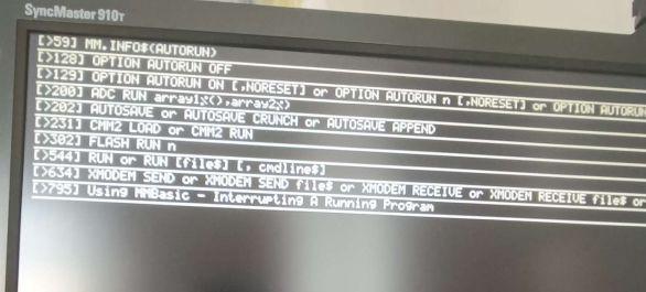

I wanted to capture how it works, but went into focusing problems, so some screenshots here.
effect if entered RUN as search keyword without any keys
search with key -f (lists full info)
BW version. Ok.. not totally BW, all BW except short description
Effect if entered search keyword FRAMEBUFFER (fithout -f key)
and you can read more detailed on topic entering >316
Colour version of >316
effect of just key -s
if there is no ideas what you are looking for

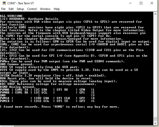

but unfortunately it doesn't work so well for me yet ... RC14 !
> help
ready
[>1] Predefined Read Only Variables
[>4] Using the I/O pins. DIGITAL, ANALOG, COUNTING Inputs. DIGITAL Outputs.Pulse PWM. COMMUNICATIONS INTERFACES (Serial, SPI and I2C).INTERRUPTS.

I found more records. Press 'HOME' to refine; any key for more.
> help display
Error : Argument list
> help "display
> help
[LIBRARY] Dim INTEGER PICOMITE=1
Error : PICOMITE already declared

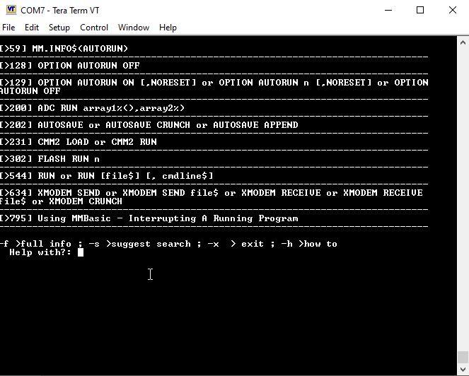

There is no reaction here in particular:
"I found more records. Press 'HOME' to refine; any key for more."
Only Ctrl-C helps here via Console (I have no keyboard, only a mouse connected for testing!)
The correct output on the console (e.g. TeraTerm) would also be ingenious. Unfortunately, it appears confused.
But I love the idea!

- There is quick terminal/ headless/RP2040 compatible version
So output to VGA screen would be quite ugly, while somehow usable still.
help_console_RP240_headless_20250416.zip
- Now all keyboard sents should work ok through terminal (no need external keyboard)
Will not return path however. Have no any ideas how to do it, yet.

 If usr$="-x" Or usr$="-exit" Or usr$="-e" Then
  Chdir ".."
  Drive backupDrive$
  Chdir backupCWD$
Yes it helps
Matthias
electricat
Joined: 30/11/2020
Location: Lithuania
Posts: 299
Posted: 03:33am 17 Apr 2025
I added at the wery begining
Dim remember_path$=Cwd$
but then returned paths on first ESC as if I was making corrections in my other project 'navigator'. Made it tits up
       Loop Until pkey$ <> ""
 If pkey$=Chr$(27) Then
       Close #1
 Chdir remember_path$
       End
       End If
Paths sure were not returned, so I just decided things will not work that way.
Anyways You pointed it right. We need remember working drive too
Another thing is, I wanted it work from command line like in linux or something, from the very begining. So it would remember what was entered also. But for me typing in "" e.i. "searchkeywoard" ruined it all.
How clean it would be if it would be posible to make it accept from cmd line something like
-h array
