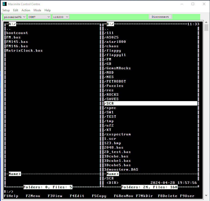

If I may make 1 suggestion for PicoMite VGA/HDMI: In MMCC filemanager, when you open the filemanager, send "MODE 1" before you start the interaction with FILES and XMODEM.
When the VGA mite is in mode 2 (40 columns width) all filenames are wrapped to the next line.
MMCC Similar for "Send Listing To Editor", lines are wrapped with terminal (screen) width. If you would send "MODE 1:FONT 8" prior to the transfer no line wrapping would occur.

MMCC does change to MODE 1 but the decision if to change needs some work to allow for the new modes.
I don't have a working VGA or HDMI unit to test with and even if I did, I am well behind the current thinking.
I will get there eventually.

There were a few hard-coded types in MMCC which I will correct in a day or two.
That will fix the failure to switch to MODE 1 when starting the file manager.

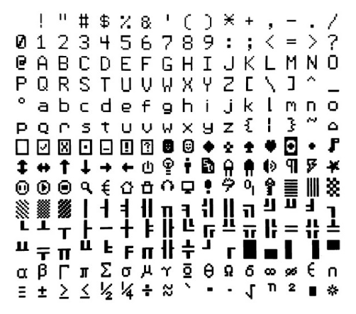

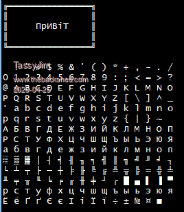

Jim,
Is it possible to create such a font so that your MMCC terminal could correctly display all the symbols of the PicoMite VGA/HDMI FONT 1 encoding?
And if such a font already exists, how can it be configured?
Thank you.
Posted: 04:48am 05 Apr 2025
  Quote  Is it possible to create such a font so that your MMCC terminal could correctly display all the symbols of the PicoMite VGA/HDMI FONT 1 encoding?
Possible, Yes.
Easy, No
I haven't had much experience creating TrueType fonts but you could start with a font that has the line drawing characters.
Ubuntu Mono is a good start as I think it is not under copyright.
If you aren't concerned with copyright, Courier New has more of the other characters.
Once you have chosen your font to copy,
move the other characters that exist in the font to the correct character position for the MMfont. A lot of the MMfont characters are in many fonts, just not in the correct position.
You can then search the unicode library looking for the rest of the characters. Some will not be found.
Then you are left with the characters that need to be drawn by hand.
Easier would be to create a bitmap font but it would need a number of sizes to be of much use.
MMCC allows any TT font and Windows style bitmap fonts.
Setup menu
Terminal font...
Most other terminal programs let you change font.
FontForge is one Windows font program. It works but I don't like the interface much.

Hi pwillard,
We need a font for a Windows computer with the same character encoding as PicoMite VGA/HDMI. If we have such a font, it can be selected as a font in the terminal program for the correct display of PicoMite VGA/HDMI program characters and on the PC console.

Well, the glyph mapping would be a concern beyond the normal letter/number/symbol assignments. (meaning anything after the 'tilde' character.)
Though, this does have a lot of overlap with the DOS 437 font.

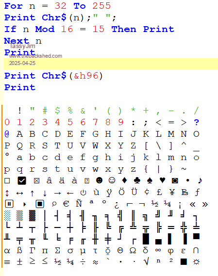

Installing the Perfect_DOS_VGA_437 font partially solves the problem of displaying the pseudographics symbols of the PicoMite encoding.
For some reason the font is displayed with a line break
Perfect DOS VGA 437.zip
