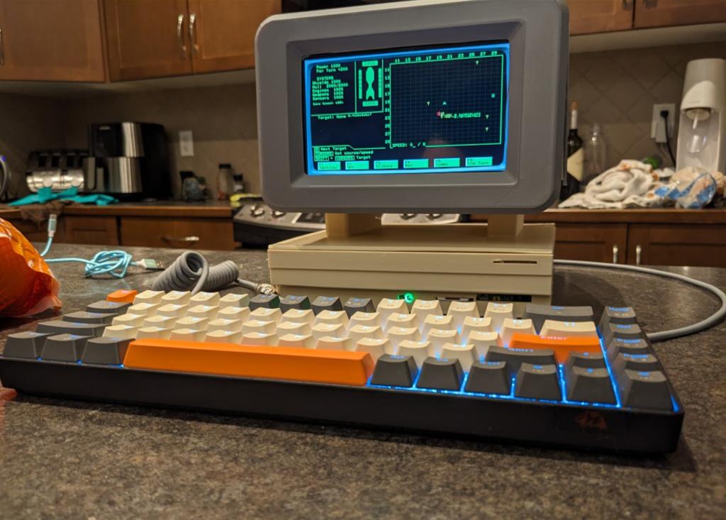

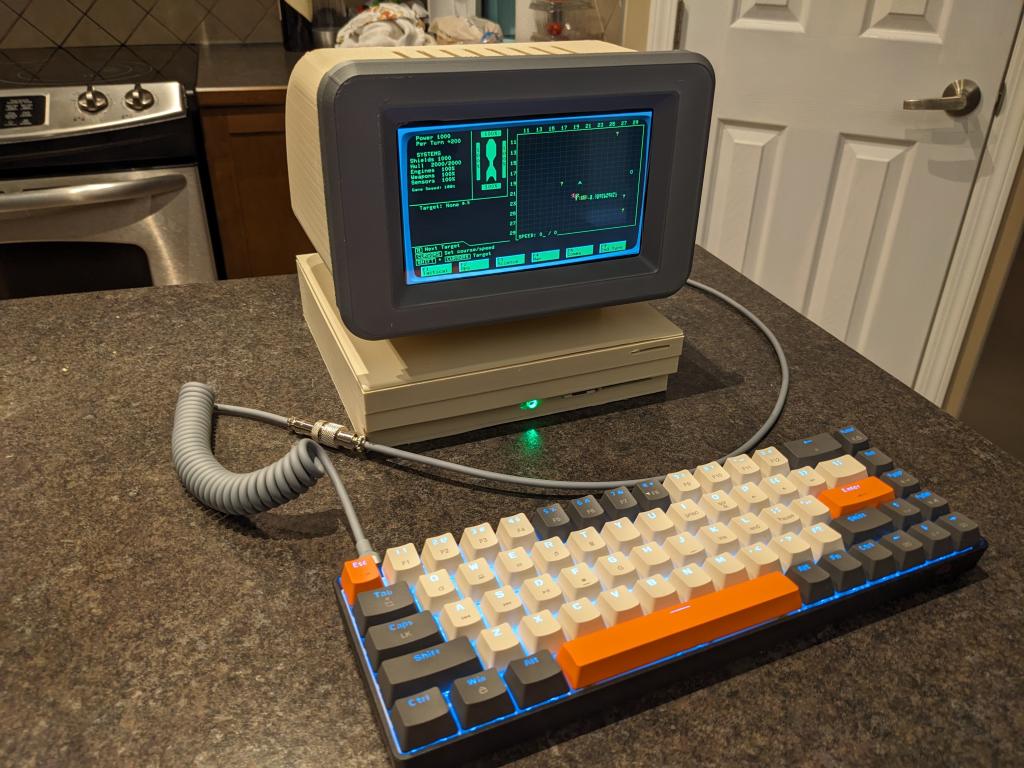

I know I'm a bit late on the band-wagon, but I finally got myself one of those new fangled 3-D printers, and decided what better way to learn Fusion 360 than to design myself a case for the CMM2.
Mistakes were made. But I learned A LOT!
I'm very happy with it for a first attempt. I did go back and tidy up the model to correct some of the issues - but I probably won't print it all out again. I will sand and paint it though.

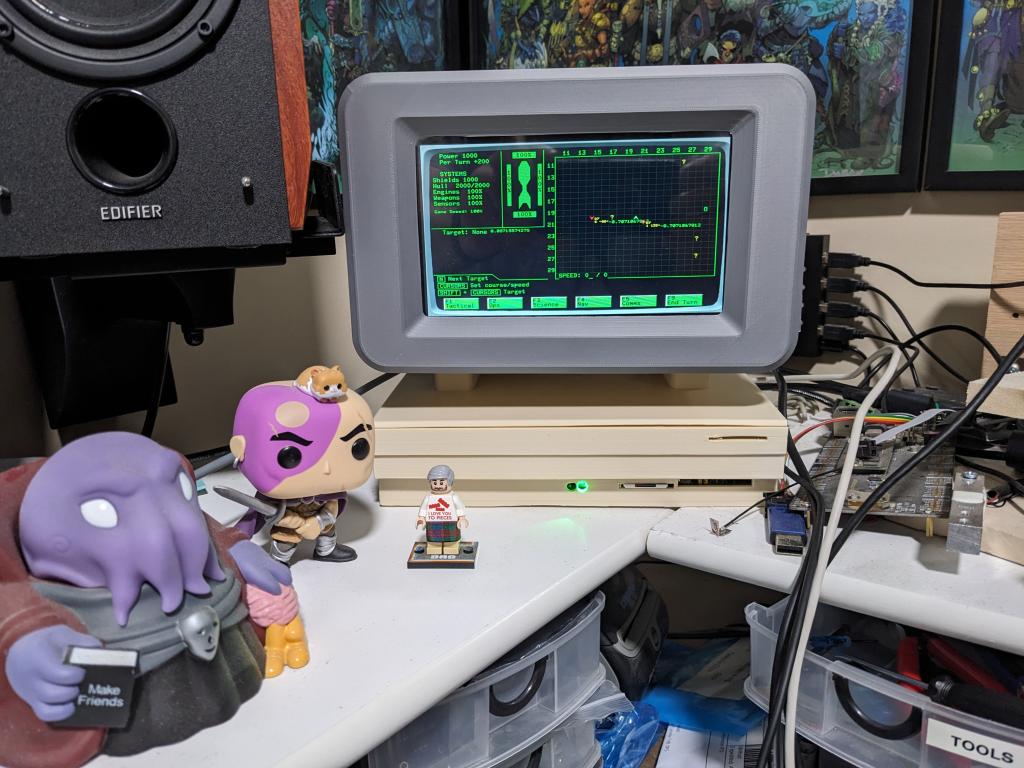

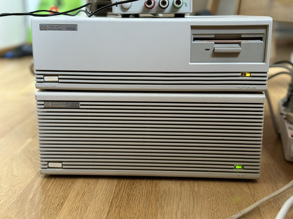

I took my inspiration from the HP-9845 workstation, which always wowed me with it's cable management, where the cables went up the two monitor legs. So I did the same thing here. The image below shows the two monitor legs, and nary a connecting cable in sight.

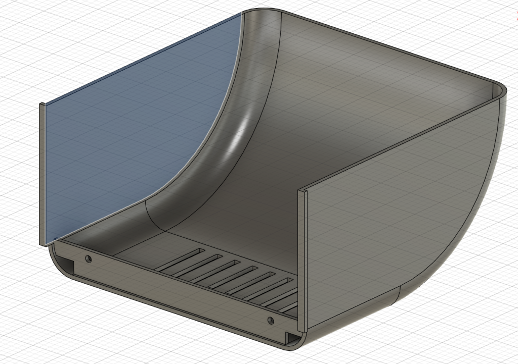

A view with the monitor cover off showing the internal cable routing.

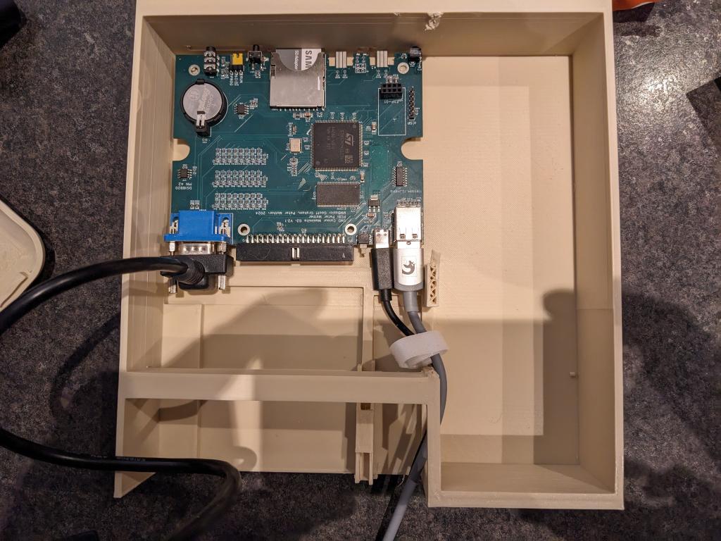

And here's a shot inside. I wanted enough space to put a breadboard in there for future projects.
If anyone wants to try it out for themselves - or improve upon it. here are the Fusion 360 files and a .3mf file.

WOW, that is so good
BarryH
Posts: 2998
Posted: 05:04am 03 Apr 2025
Really brilliant work
Is it simply held together with what look possibly like built in ‘clips’?
And what size screen are you using there?
Nice keyboard too by the way!!

  BarryH said   WOW, that is so good
Thank you very much!
  WhiteWizzard said  Really brilliant work
Thank you as well.

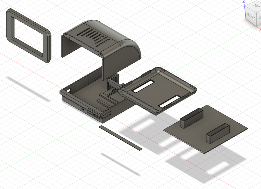

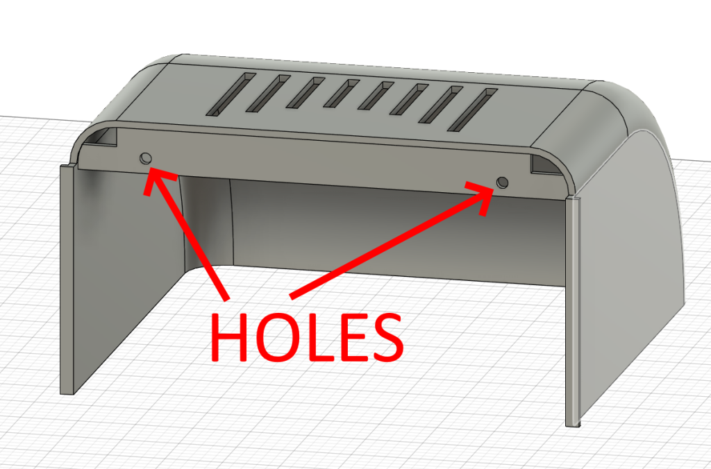

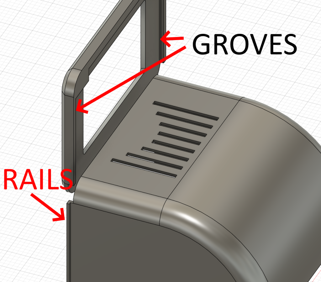

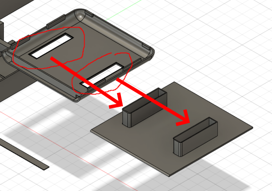

It's mainly held together by clips. Two parts are glued together, the bottom of the monitor and the top of the case. I could have printed these as one, but it was quickest to print them separately without needing supports during the print.
The monitor bezel is a friction fit (i.e. it slides one from the top and is held in by grooves). But I made all of them too tight (both the slot and the groove). So I updated the model to give a bit more tolerance.
The LCD is a 7-inch 1024x600. It has an HDMI input, so I've got a VGA to HDMI connector hidden inside the monitor part. It's nice and bright - and (surprisingly)  easily large enough to program and game on.
As for the keyboard, it's very nice, but I made the fatal mistake of buying one that didn't have separate Function keys - which makes it a bit of a pain for using with the CMM2. But not to worry, this case has emboldened me and I have another classic HP computer case project in mind that might make use of this keyboard!

Because of the HDMI and power connectors being on the side on the monitor, I did also buy 90 degree HDMI and USB power adapters - (and a very flexible short HDMI cable).
Power, was provided by an unpowered (i.e. just USB cable power - no external transformer) USB hub inside the monitor (which powers both the display and the VGA to HDMI adapter). My original intention was to have the CMM2 also powered by this hub - but the power draw proved to be too much. A powered USB hub may work better - I was just using what I had to hand.

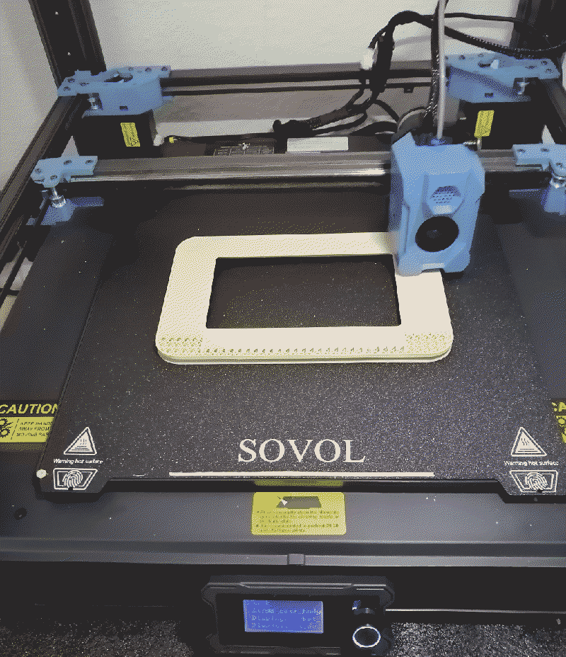

  dddns said  Got a chamber for your printer?? And what material did use use?
No chamber - it currently just sits on my office floor (awaiting a permanent move into the basement). I used a Neptune 4 MAX with the standard Elegoo PLA.
You will need at least a 320x320 bed, as some bits are quite large.
It does need sanding on the larger curves and I suspect I will paint the light beige bits, but I was very happy with the dark grey bezel for the monitor.

  dddns said  My experience is, that sanding PLA is no fun as it melts so early and it can easily look ugly :)
Thanks for the advice. I'm just starting out with 3D printing and learning the limitations/pitfalls. If I was designing it again, I'd use more subtle curves. It's the large curves on the monitor that really show up the layering. Having said that - I could probably tweak the settings on the printer to do a better job of smoothing them at the time of print.

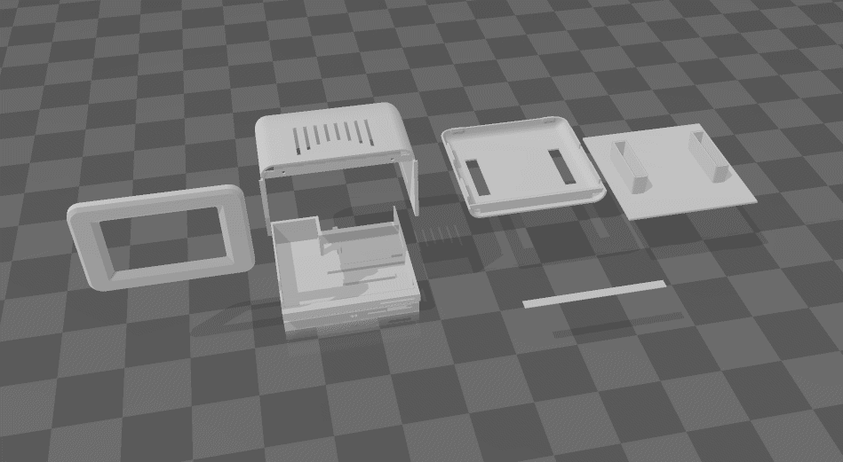

Unfortunately, I’m having trouble opening the .f3d and .3fm files.
Would it be possible for you to save and share the model as STL files instead?
That would be super helpful – thanks a lot

  Martin H. said  ...Would it be possible for you to save and share the model as STL files instead?
Of course.
Here you go:
CMM2 Case STL.zip
Cheers,
Pete
