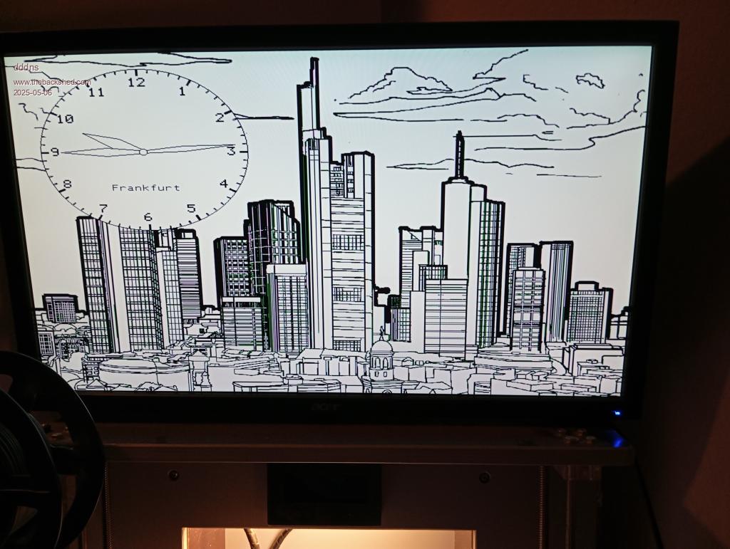

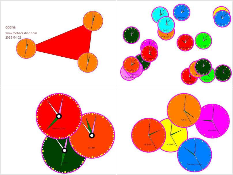

Hello World :))

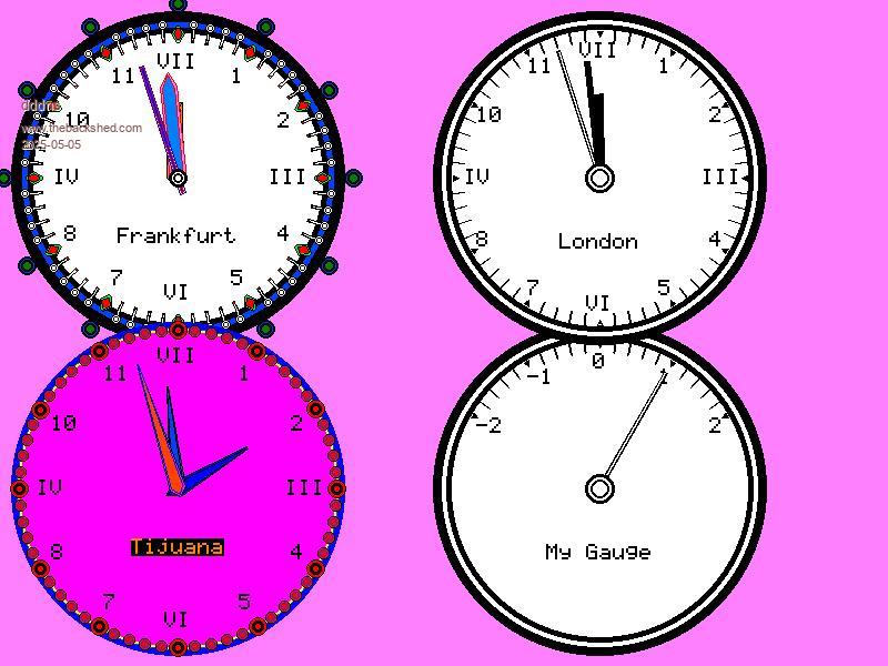

My first basic program! A few days ago I setup my first VGA PicoMite and was so taken, I couldn't stop. Have fun!
I tried to make really everything configurable and no end of ideas in sight :)
They move, change colours, can be static with favorites etc.. have a look
I tried my best to comment it so everybody can modify it as easy as possible.
VGAclocks_RC1.bas.zip

hi dddns,
I am running a RP2040 platform, and it does not support mode 3.
I made some small changes to make your program work on mode 2.
VGAclocks_mode2.zip
Running as a background right now.

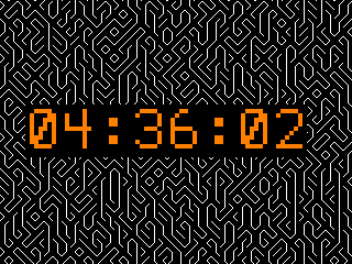

Posted: 09:53am 02 Apr 2025
Const Mode.N=2
Const Font.N=1
Const T.Scale=4
Const T.Size=Len(Time$)
MODE  Mode.N
Const X.Res=MM.HRES,Y.Res=MM.VRES
Font  Font.N
Const X.FSize=MM.Info(FONTWIDTH)
Const Y.FSize=MM.Info(FONTHEIGHT)
Const X.Offset=X.FSize*T.Scale*T.Size\2
Const Y.Offset=Y.FSize*T.Scale\2
Dim integer X.Dir=1,Y.Dir=1
Dim integer X.Pos=MM.HRES\2,Y.Pos=MM.VRES\2
Dim Clr(15)=(0,1,2,3,4,5,6,7,8,9,10,11,12,13,14,15)
Colour Map Clr(),Clr()
FRAMEBUFFER LAYER 0
FRAMEBUFFER WRITE L
Font 9
Print @(0,0);
For n=1 To (X.Res\8)*(Y.Res\8)
 Print Chr$(32+Int(Rnd*3));
Next
Blit READ  1, 0,0,MM.HRES,1
Blit 0,1,0,0,MM.HRES,MM.VRES-1
Blit Write 1, 0,MM.VRES-1
Blit Close 1
Pause 20
FRAMEBUFFER WRITE N
If C=0 Then C=Int(Rnd*15)+1
Text X.Pos,Y.Pos,Time$,"CM",Font.N,T.Scale,Clr(C)
Inc X.Pos,X.Dir:Inc Y.Pos,Y.Dir
If X.Pos-X.Offset<0 Then X.Dir=1
If X.Pos+X.Offset>MM.HRES Then X.Dir=-1
If Y.Pos-Y.Offset<0 Then Y.Dir=1:C=0
If Y.Pos+Y.Offset>MM.VRES Then Y.Dir=-1:C=0
FRAMEBUFFER WRITE L
Loop While Inkey$=""
DefineFont 9
04200808
80402010 08040201
01020408 10204080
08080808 08080808
End DefineFont

One single object is now possible and favorite font & scale is implemented.
VGAclocks_RC2.bas.zip

I never typed that much in my life :)) My lost cost cherry keyboard is lost..the cursor keys

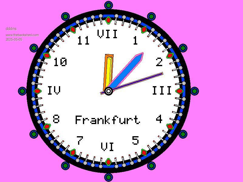

So here it is, my first real MM Basic program. I couldn't comment it yet but I thought somebody might want to play already. I tired my best, it shows a picture..
VGAclocks_V1.bas.zip
have fun :)
> list
Option explicit
Option console serial
VGAclocks(5,"INIT")
VGAclocks(2,"SET_TIMEZONE",2,,,1)
MODE 3 : Font 1
FRAMEBUFFER create
FRAMEBUFFER write f
CLS RGB(white)
Dim integer count
 For count = 0 To clk_amount
   VGAclocks(count) 'draw the clock
 Next count
 FRAMEBUFFER copy f,n
 FRAMEBUFFER write f
 CLS RGB(white)
Loop
'VGAclocks library starts here
Sub VGAclocks(clk_object,clk_init_action$,clk_draw_scale,clk_source,clk_dest,clk_debug,clk_base_UTC
_time$)
 If clk_debug <> 0 Then
   Print "VGAclocks for PicoMite MMBasic"
   Print "Version 0.1"
   Print "published at https://www.thebackshed.com/forum/ViewTopic.php?FID=16&TID=17822"
   Print "clk_draw_scale = ";clk_draw_scale
   Print "clk_object = ";clk_object
   Print "clk_init_action$ = ";clk_init_action$
   Print "clk_source = ";clk_source
   Print "clk_dest";clk_dest
   Print "clk_debug = ";clk_debug
   Print "clk_base_UTC_time$ = ";clk_base_UTC_time$
   Print :Print
 End If
It's completely encapsulated and need nothing before init, runs with explicit option. I hope that this is how it should be for a library, but I don't know. One of my favorites is to re-invent the wheel, so this is done with zero knowledge.
(technical)comments are very much appreciated!

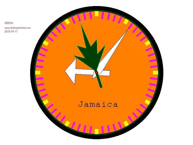

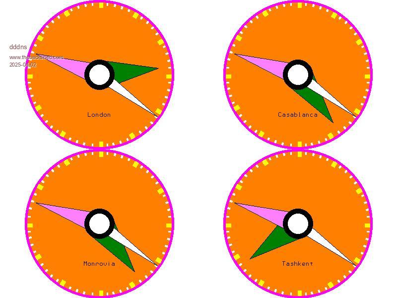

dddns
Joined: 20/09/2024
Posts: 925
Posted: 02:58pm 11 Apr 2025
This is VGAclocks Version1
VGAclocksV1RC1.bas.zip
This is a library to draw in a convenient way clock objects.
A clock object consists of parameters stored in a database at the end.
Variables and their content are dynamically created during INIT.
> list variables
DIM CLK_TIMEZONE$(5)
DIM INTEGER CLK_AMOUNT
DIM INTEGER CLK_COLOURS(15)
DIM INTEGER CLK_FACE_5MIN_COL(5)
DIM INTEGER CLK_FACE_5MIN_LENGTH(5)
DIM INTEGER CLK_FACE_5MIN_LW(5)
DIM INTEGER CLK_FACE_BC(5)
DIM INTEGER CLK_FACE_FC(5)
DIM INTEGER CLK_FACE_LW(5)
DIM INTEGER CLK_FACE_SEC_COL(5)
DIM INTEGER CLK_FACE_SEC_LENGTH(5)
DIM INTEGER CLK_FACE_SEC_LW(5)
DIM INTEGER CLK_HAND_BC_HR(5)
DIM INTEGER CLK_HAND_BC_MIN(5)
DIM INTEGER CLK_HAND_BC_SEC(5)
DIM INTEGER CLK_HAND_COVER_BC(5)
DIM INTEGER CLK_HAND_COVER_FC(5)
DIM INTEGER CLK_HAND_COVER_LW(5)
DIM INTEGER CLK_HAND_COVER_RADIUS(5)
DIM INTEGER CLK_HAND_FC_HR(5)
DIM INTEGER CLK_HAND_FC_MIN(5)
DIM INTEGER CLK_HAND_FC_SEC(5)
DIM INTEGER CLK_HAND_LENGTH_HR(5)
DIM INTEGER CLK_HAND_LENGTH_MIN(5)
DIM INTEGER CLK_HAND_LENGTH_SEC(5)
DIM INTEGER CLK_HAND_WIDTH_HR(5)
DIM INTEGER CLK_HAND_WIDTH_MIN(5)
DIM INTEGER CLK_HAND_WIDTH_SEC(5)
DIM INTEGER CLK_POS_X(5)
DIM INTEGER CLK_POS_Y(5)
DIM INTEGER CLK_RADIUS(5)
DIM INTEGER CLK_REGION(5)
DIM INTEGER CLK_RING_BC(5)
DIM INTEGER CLK_RING_LW(5)
DIM INTEGER CLK_RING_RADIUS(5)
DIM INTEGER CLK_SCALE(5)
DIM INTEGER CLK_TEXT_COL(5)
DIM INTEGER CLK_TEXT_FONT(5)
DIM INTEGER CLK_TEXT_XOFF(5)
DIM INTEGER CLK_TEXT_YOFF(5)
DIM INTEGER CLK_UTC_OFFSET(5)
DIM INTEGER COUNT
LOCAL CLK_BASE_TIME$
LOCAL CLK_INIT_ACTION$
LOCAL FLOAT CLK_DEBUG
LOCAL FLOAT CLK_DEST
LOCAL FLOAT CLK_DRAW_SCALE
LOCAL FLOAT CLK_OBJECT
LOCAL FLOAT CLK_SOURCE
The command has the syntax:
VGAclocks(clk_object,clk_init_action$,clk_draw_scale,clk_source,clk_dest,clk_debug,clk_base_time$)
Draw:
VGAclocks(clk_object,"", clk_x_pos, clk_y_pos, clk_draw_scale,clk_base_time$, clk_debug)
targets for init_action$: INIT, SET_Timezone, SET_SIZE, SET_COLOUR
max objects are 30
object count starts from 1
parameters can be omitted except clk_object
I hope I got the parsing right as this work is directly published and not tested
Have fun

Data  "Canberra","Guam","Hobart","Magadan","Vladivostok","Srednekolymsk","Guadalcanal","Anady","Auckland","Fiji","Tongatapu","Apia",""
Lclk_timezone_offset:
Data -12,-11,-10,-8,-7,-7,-7,-7,-6
Data -6,-5,-5,-6,-5,-5,-4,-45,-3,-3
Data -4,-4,1,-4,-25,-3,-3,-3,-2,-3
Data -3,-2,0,-1,1,1,0,2,2,2
Data 2,2,2,3,3,2,3,3,2,3
Data 3,3,2,2,3,3,3,3,3,3
Data 35,4,5,4,4,4,4,4,5,5
Data 5,55,55,6,6,6,6,65,7,7
Data 8,8,8,8,8,8,9,9,9,105
Data 95,10,11,10,11,10,10,11,12,13
Data 12,13,14
'Data Area
'Labels for object 1 - 10
'Dimensions:
Lclk_ring_radius1: Data 50,100,150,200,200,100,100,100,100,100
Lclk_hand_cover_radius1: Data 7,30,20,20,30,15,15,15,15,15
Lclk_ring_lw1: Data 3,3,5,3,5,10,5,5,5,5
Lclk_hand_cover_lw1: Data 2,2,2,1,3,3,3,3,3,3
Lclk_face_lw1: Data 1,3,3,5,5,10,10,10,10,10
Lclk_face_sec_length1: Data 5,10,10,20,20,5,5,5,5,5
Lclk_face_5min_length1: Data 10,20,20,30,30,10,10,10,10,10
Lclk_face_sec_lw1: Data 1,2,3,4,4,4,4,4,4,4
Lclk_face_5min_lw1: Data 1,2,3,8,10,7,7,7,7,7
Lclk_hand_width_sec1: Data 2,10,5,8,5,5,5,5,5,5
Lclk_hand_width_min1: Data 4,15,15,20,20,30,10,10,10,10
Lclk_hand_width_hr1: Data 6,10,30,35,25,15,15,15,15,15
Lclk_hand_length_sec1: Data 46,90,87,100,85,85,85,85,85,85 'clk_ring_radius() - clk_ring_lw() - clk_face_lw()
Lclk_hand_length_min1: Data 25,55,65,85,65,65,65,65,65,65 'clk_hand_length_sec() - 20
Lclk_hand_length_hr1: Data 25,40,45,70,40,40,40,40,40,40 'clk_hand_length_min() - 45
'Colours:
Lclk_ring_bc1: Data 0,0,0,0,0,0,0,0,0,0
Lclk_face_bc1: Data 0,0,0,0,0,0,0,0,0,0 '1,1,1,1,1,1,1,1,1,1
Lclk_face_fc1: Data 12,7,10,9,1,11,6,2,2,2
Lclk_face_sec_col1: Data 9,8,7,6,3,3,3,3,3,3
Lclk_face_5min_col1: Data 5,4,3,2,1,4,4,4,4,4
Lclk_hand_cover_bc1: Data 14,13,6,9,5,5,5,5,5,5
Lclk_hand_cover_fc1: Data 6,6,6,6,6,6,6,6,6,6
Lclk_hand_bc_sec1: Data 0,0,0,0,7,7,7,7,7,7
Lclk_hand_fc_sec1: Data 8,9,10,11,8,8,8,8,8,8
Lclk_hand_bc_min1: Data 0,0,0,0,9,9,9,9,9,9
Lclk_hand_fc_min1: Data 10,3,3,1,10,10,10,10,10,10
Lclk_hand_bc_hr1: Data 0,0,0,0,11,11,11,11,11,11
Lclk_hand_fc_hr1: Data 12,1,2,11,12,12,12,12,12,12
'Text colour
Lclk_text_col1: Data 3,2,15,8,8,12,10,12,15,0
'Text font
Lclk_text_font1: Data 1,1,1,1,1,1,1,1,1,1
'Text xoffset
Lclk_text_xoff1: Data 0,0,0,0,0,0,0,0,0,0
'Text yoffset
Lclk_text_yoff1: Data 20,50,80,130,70,30,20,20,20,20
'Static Positions
Lclk_pos_x1: Data 150,550,150,550,550,550,250,550,250,550
Lclk_pos_y1: Data 150,150,450,450,450,520,520,520,520,320
'Velocities
Lclk_vel_max_x1: Data 2,2,2,2,2,2,2,2,2,2
Lclk_vel_max_y1: Data 2,2,2,2,2,2,2,2,2,2
'Timezones
Lclk_region1: Data 99,11,22,33,44,55,66,77,88,99
Lclk_UTC_offset1: Data 0,1,2,3,4,5,6,7,8,9
'Scaling
Lclk_scale1: Data 100,100,100,100,100,80,70,50,20,100
'Labels for object 10 - 19
'Dimensions:

Posted: 04:49pm 16 Apr 2025
Hello :)

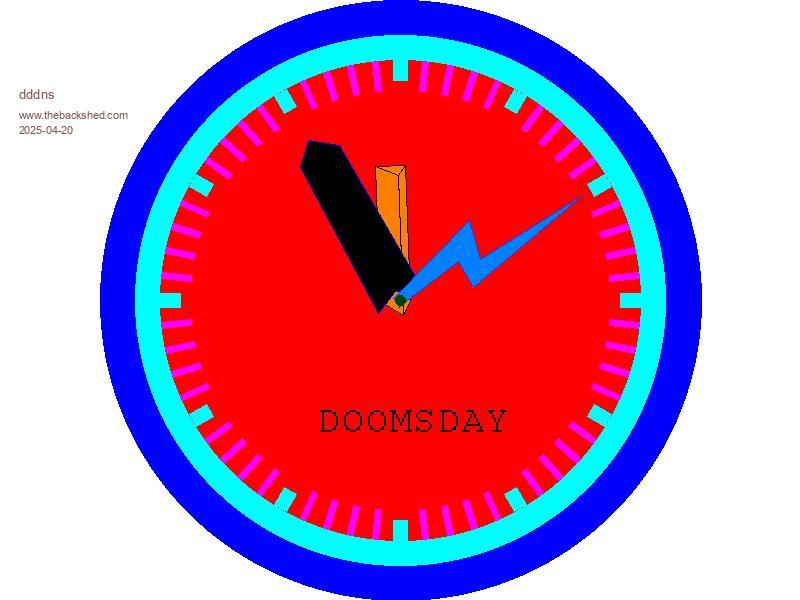

I am happy for taking the next big step.
VGA_clocks_V1RC4.bas.zip
Everything is drawn with polygon, circle or arc.
Polygon is such a fantastic command and must be written by a genius.
A line drawn with a polygon looks simply the best. You can achieve any possible line width, by simply scaling the coordinates.
So VGAclocks draws objects, which can seamlessly be scaled.
Every and each element that an object consists of can be configured in terms of colour and size. You can initialize up to 30 objects.
The polygon can have up to 16 corners and is individual for every object and for every clock hand.
The minute/second drawing is now also an polygon.

Forgot to say, that I didn't find the time to build sense making coordinates for the clock hands as I am doing nothing but getting the frame done.
dddns
Joined: 20/09/2024
Posts: 925
Posted: 05:09pm 16 Apr 2025
Coordinate section for the clock hands look like this example for the second of the first then objects:

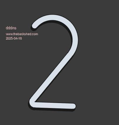

This is how I plan to vectorize the numbers. Very simple and hard coded coordinates.
Number 1 would need 1 polygon and 2 arcs. If you store these numbers in an array, you can scale them with one command.Its calculated 1:1 in 8x12 and it will look brilliant scaled. finally hand this array to polygon. arc radius x scale for linewidth
Edited 2025-04-17 08:14 by dddns

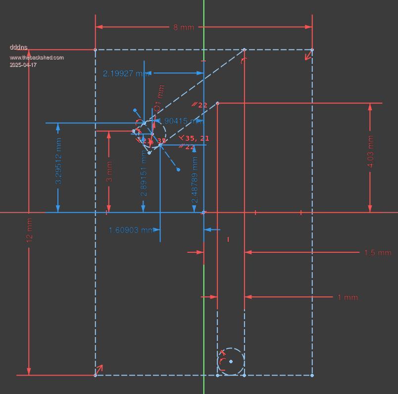

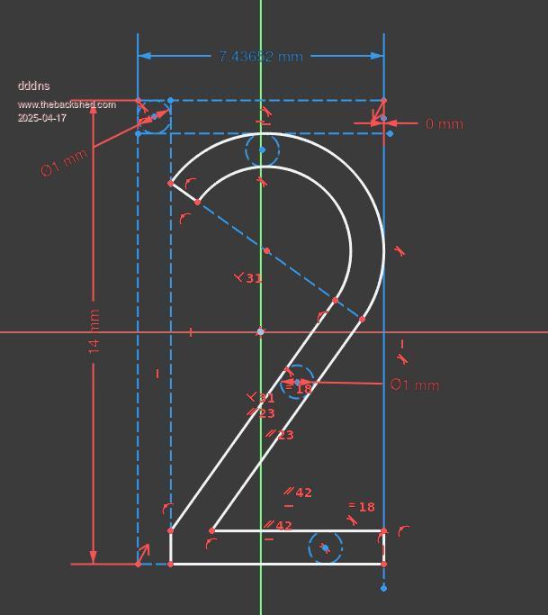

Posted: 12:38pm 17 Apr 2025

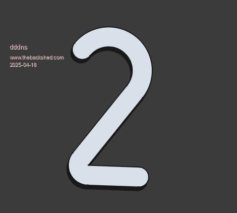

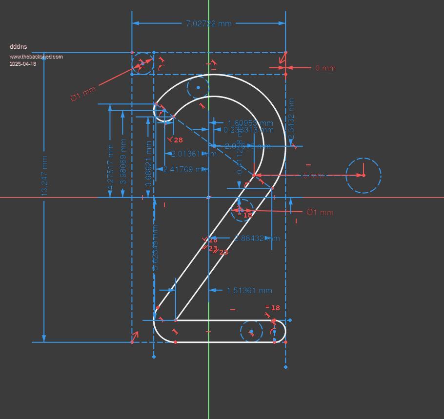

I think this is how its possible to print number 2 with few lines of code scalable and rotatable. Brainstorming work as this is all out of thin air.
Here is an Freecad sketch in which only the red constrains need to be changed and the whole gets scaled. Variables are diameter for line width and upper left for spacing.
The other constrains in this drawing are just geometrical.
freecad.zip
dddns
Joined: 20/09/2024
Posts: 925
Posted: 02:27pm 17 Apr 2025
This one is nice. Just grab the right circle in the middle with the mouse and you can design the 2 within the constrains and move the center of 2'S arc.
All blue values get updated just in time.
edit: of cause I wanted to say constrainTs!
freecad.zip
with line width = 1
with line width = 2
Edit:Final layout sheet for number 2 with freecad. Its very stable now and doesn't crash freecad at all. You can really freely design the shape now.
freecad.zip
Edited 2025-04-18 01:50 by dddns

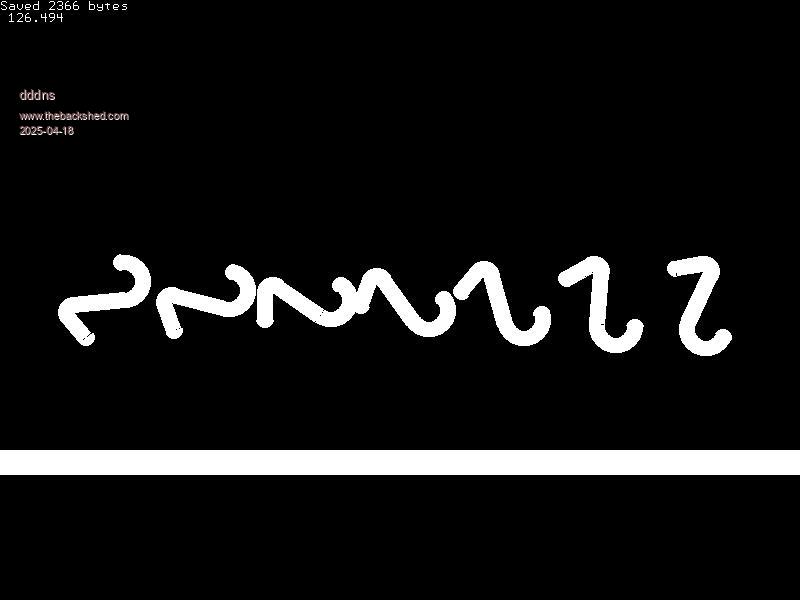

option explicit
Option angle degrees
Dim integer x = MM.HRES / 2
Dim integer y = MM.VRES / 2
Dim integer arcs_x(3)
Dim integer arcs_y(3)
Dim integer arcR1(3)
Dim integer arcR2(3)
Dim integer arcA1(3)
Dim integer arcA2(3)
Dim integer arct_x(3)
Dim integer arct_y(3)
Dim integer polyt_x(6)
Dim integer polyt_y(6)
Dim integer arc_R1t(3)
Dim integer arc_R2t(3)
Dim integer count,count1,count2
Dim float scale = 1
Dim float angle = 30
arcs_x(0) = 0
arcs_y(0) = -29.5
arcR1(0) = 11
arcR2(0) = 26
arcA1(0) = 302
arcA2(0) = 126
arcs_x(1) = -15.4
arcs_y(1) = -40.4  'upper left
arcR1(1) = 0
arcR2(1) = 7.5
arcA1(1) = 125
arcA2(1) = 304
arcs_x(2) = -7.9 'bottom left
arcs_y(2) = 28.4
arcR1(2) = 0
arcR2(2) = 15
arcA1(2) = 180
arcA2(2) = 314.18
arcs_x(3) = 18.6 'bootom right
arcs_y(3) = 35.8
arcR1(3) = 0
arcR2(3) = 7.5
arcA1(3) = 0
arcA2(3) = 180
Dim float poly_x(6) = (  9.2, 21.6,-7.9,18.6,18.6,-7.9,-20.3) 'from upper left
Dim float poly_y(6) = (-23.3,-14.5,28.3,28.3,43.3,43.3,19.9)'to bottom left clockwise
Timer =0
For x = 100 To 700 Step 100
Inc angle,20
'MATH SCALE in(), scale, out()
Math scale arcR1(), scale, arc_R1t()
Math scale arcR2(), scale, arc_R2t()
Math scale arcs_x(), scale, arct_x()
Math scale arcs_y(), scale, arct_y()
Math scale poly_x(), scale, polyt_x()
Math scale poly_y(), scale, polyt_y()
'MATH ADD in(), num ,out()
Math ADD arct_x(), x, arct_x()
Math ADD arct_y(), y, arct_y()
Math ADD polyt_x(), x ,polyt_x()
Math ADD polyt_y(), y ,polyt_y()
'Math V_ROTATE x, y, a,xin(), yin(), xout(), yout()
Math V_ROTATE x, y, angle, arct_x(), arct_y(), arct_x() , arct_y()
Math V_rotate x, y, angle, polyt_x(), polyt_y(), polyt_x(), polyt_y()
'ARC x,y,r1,[r2],a1,a2[, c]
For count = 0 To 3
 Arc arct_x(count),arct_y(count),arc_R1t(count),arc_R2t(count),arcA1(count)+angle,arcA2(count)+angle
Next count
'POLYGON n, xarray%(),yarray%() [, bordercolour] [,fillcolour]
Polygon 7, polyt_x(), polyt_y(), RGB(white), RGB(white)
Next x
Print Timer
Edited 2025-04-18 14:30 by dddns
dddns
Joined: 20/09/2024
Posts: 925

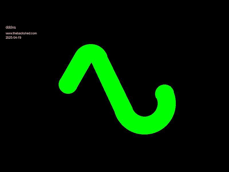

Posted: 06:58pm 18 Apr 2025
Hello :)
I posted the above at 6 in the morning sitting 18 hours non stop in fron of my PC doing that. I must be crazy but I think it was worth it.
MM Basic is so incredible superb I cant find words. Thank you!
This is the skeleton of the library I will use. Have fun let the 2 scroll and scale with your cursor keys :)) Here we go:
