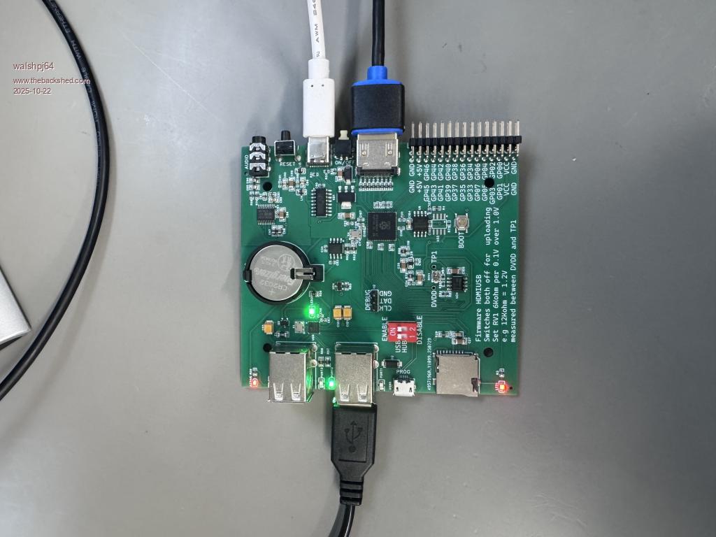

Hi, I also purchased a pre assembled board from SC for $81. RP23500B chip already soldered in. I used the firmware PicoMiteHDMIUSBV6.00.01.uf2 from SC which worked ok. Also set the DVDD volts to 0.1V above the 1.0V as stated.
The only problem i had was there was no HDMI output. Console was OK. Eventually tracked it down to Setting  OPTION HDMI PINS 1, 3, 5, 7  The wiring of the new on board to the HDMI was different from the old board with the plugin pico. Don't know if there will be a revised firmware for newbies like me. At least i have found this forum which is great.

Posts: 12175
Posted: 11:01am 22 Oct 2025
Please post a picture of the board so I can help further.

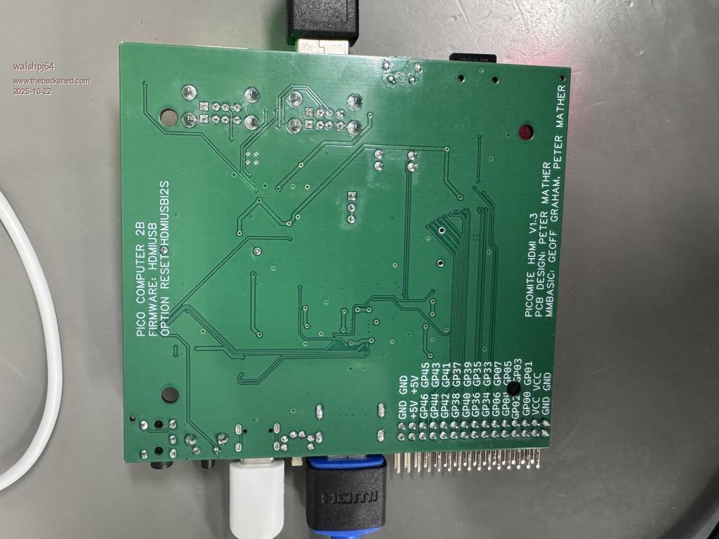

Posted: 11:08am 22 Oct 2025
Hopefully the pics are OK.

Posts: 12175
Posted: 11:23am 22 Oct 2025
Upgrade to a later version of the software. V6.01.00RC4 that I have just posted seems robust so try that. Then do the OPTION RESET HDMIUSBI2S and you should get

walshpj64
Joined: 21/10/2025
Posts: 6
Posted: 11:58am 22 Oct 2025
Just found the USB problem. Programming cable was still plugged in. Now All good Much appreciated.
Posts: 12175
Make sure you have unplugged the micro-usb and plugged in a USB-C to provide power. Also make sure the switches are both set to on
