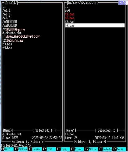

This is a branch of the main File Manager thread.. This isn't about a finished program, but rather about developing a simple file manager that only requires a terminal program (like Teraterm) and a Picomite. Criticism and suggestions are welcome. However, only requests of general relevance can be fulfilled. For example, the display size and the screen saver timeout can easily be adjusted in the source code to suit your needs.
The important thing to remember is the settings in the Terminal program: the screen display must be white on a black background, and the font should be "Terminal."
Have fun!
This is the VT100 console version of Vadim's (Javavi) FM (still beta!). It's functionally equivalent to my last test version for HDMI/VGA. I've optimized the display of selected files for VT100.
fm-vt100-noVGA1-02020.zip
What's missing?
It needs to be cleaned up. There's a lot of junk, and optimizations are possible. The code should run reasonably reliably and stably, as no complaints have been posted so far. I'll probably integrate the disk info module and the calendar into my private version. The ASCII module helped me a lot with conversion and could continue to do so. I've converted the color table to a test page for VT100 color codes. This is useful during development.
- The WDISKSELECT() function should be revised (Requires a Pico with an SD card!).
- There are minor cosmetic or display errors in some places.
- I'd also like to have a way for the file cursor to jump to a specific initial letter.
- There also seems to be a bug in the Deletedir() routine. It works adequately, but not as expected. I'll investigate ...
- We should also look at Vadim's new ideas and adopt them if necessary.
But I'm actually very satisfied.

Hi Michael,
I like 2020. Will be spending some time on it this weekend. My main feedback atm is that the <alt>F1 (alt and function keys) do not work as expected when running in a Teraterm terminal screen. So you can not change drive.. A key aspect.
How do we align ? If both of us hack at the same code at the same time, it's going to be a mess. I propose that you are the project integrator. And I will deliver clearly marked blocks with changes, so they can be ported into the main code easily.
Agree ?
My first focus would be to make the drive change work again (find either an alternative to <alt>F1, or make <alt>F1 work). This may require some reverse engineering with true serial ports.
EDIT: According to your wiki page, <alt>F1 would be <esc>[11;3~.. let's see...
This also gives me an idea how to improve the screensaver (the "fade(x)").
When done, I plan to remove the audio en picture viewers.

  Volhout said  ...I like 2020. Will be spending some time on it this weekend. My main feedback atm is that the <alt>F1 (alt and function keys) do not work as expected when running in a Teraterm terminal screen. So you can not change drive.. A key aspect. ...
Hi Harm,
a temporary solution to the <alt><F1> problem has long been found. The Backspace key (chr$(8)) works for me as a replacement. Please test it yourself.
  Volhout said  ... How do we align ? If both of us hack at the same code at the same time, it's going to be a mess. I propose that you are the project integrator. And I will deliver clearly marked blocks with changes, so they can be ported into the main code easily.
Agree ?
hmm, I was hoping someone else could do it... If necessary, I'd take over for a while.
  Volhout said  ... When done, I plan to remove the audio en picture viewers.
IMHO, audio could be retained; there are so many conceivable hardware platforms where it could work. I haven't used audio myself yet. As a replacement for displaying images, I've built in a "nonsense" routine — more for fun.
As test platforms I have normal PicoMites (2040), Pico2 (2350) and Peter's HDMI-Pico2 with SD and two examples of the reference design.
I just discovered that defining the VT100 colors as constants consumes about 5KB of heap memory. This is terrifying.
I've already fixed it.

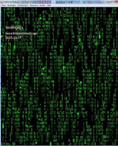

Here is a new screensaver. It is based on 256 color implementation in the terminal program. Looks a lot closer to the original...
It is tested on Putty.
I will see if TeraTerm works on monday.
'SCREEN SAVER - Matrix
Sub SSMatrix
Local matr(CHR),clr,x,fade(CHR),e$=chr$(27)+"[38;5;"
dim ink$(7) length 10 =(e$+"16m",e$+"16m",e$+"16m",e$+"22m",e$+"28m",e$+"34m",e$+"40m",e$+"46m")
For x=1 To CHR:matr(x)=CVR*Rnd:fade(x)=int(rnd*15):Next
 For x=1 To CHR
   Print ink$(int(fade(x)/2));
   Print @(x*FW-FW,matr(x)*FH)Chr$(Rnd*223+32);
   If matr(x)>CVR  Then matr(x)=0 Else Inc matr(x)
   inc fade(x),-1:if fade(x)<0 then fade(x)=15
 Next
 Pause 20
Loop While Inkey$=""
Print Nc$;
End Sub
P.s. the strings are 9 characters long, so bothe 2040 as well as 2350 could define them as constants…
Edited 2025-03-17 01:27 by Volhout

why wait until Monday? I think it looks good! (But the screensaver isn't that important to ME.) It's a good exercise!
I was  wondering about whether certain patterns could shine (as black) through. Something like a skull or something similar.
