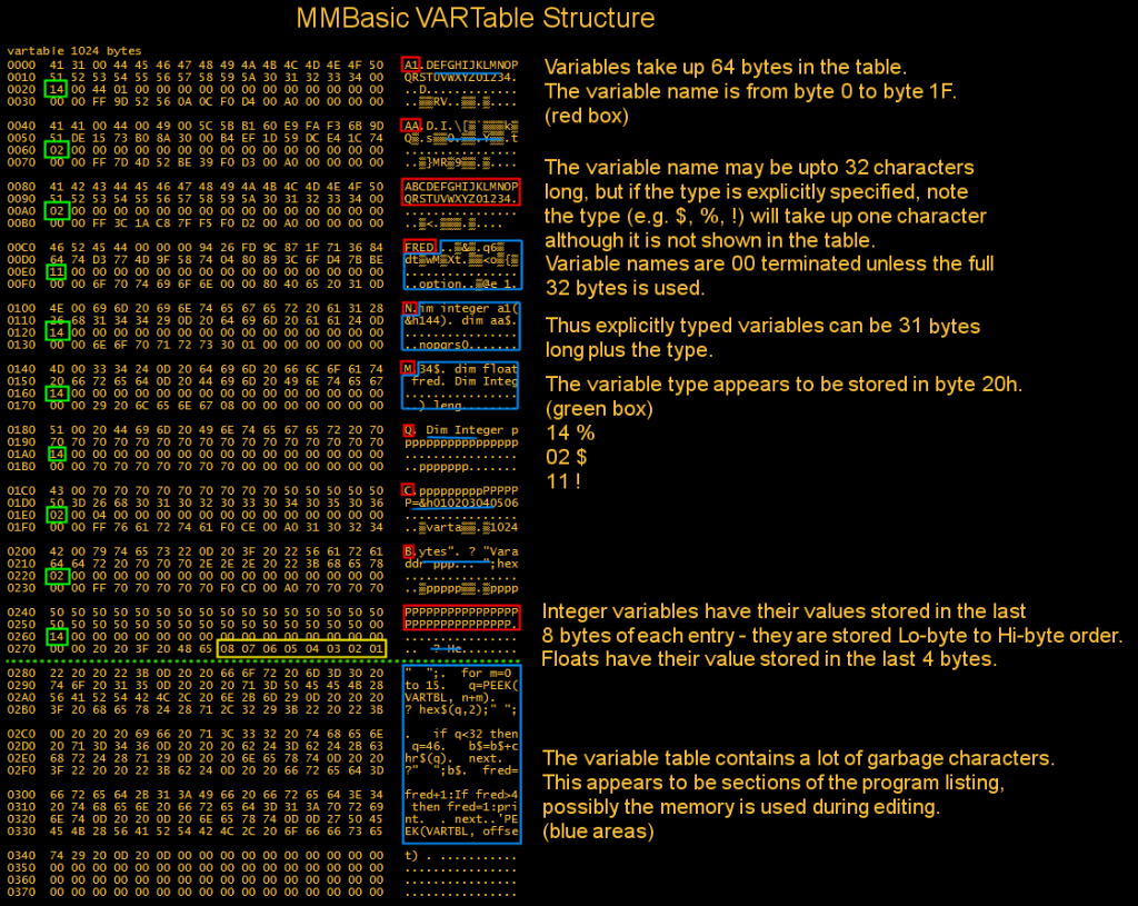

MicroMite: Unless this is peculiar to SUB, this must be a change (possibly to do with hashed variables). My code for SPLIT() routine ERASEs and DIMs an array in a FUNCTION()
h
Posted: 07:39pm 10 Mar 2025
  electricat said
Recently I was interested in varaddr etc. manipulations but I failed to find in documentation more detailed info how vars are stored.
My work was aimed at MicroMites and so I don't think it will be useful to you. I did a lot of work on this to come up with my UBOUND() function
for interest's sake...
and some code that helped
option base 0
dim a$(9)
dim integer fred
const bim=99
fred=1
for n=0 to 511 step 16
b$=""
? Hex$(n,4);"  ";
for m=0 to 15
q=PEEK(VARTBL, n+m)
? hex$(q,2);" ";
if q<32 or q>126 then q=46
b$=b$+chr$(q)
next
?"  ";b$
fred=fred+1:If fred>4 then fred=1:print
next
erase a$
fred=1
b$=""
? Hex$(n,4);"  ";
for m=0 to 15
q=PEEK(VARTBL, n+m)
? hex$(q,2);" ";
b$=b$+chr$(q)
next
?"  ";b$
next
dim bb$(5), a$(2)
fred=1
b$=""
? Hex$(n,4);"  ";
for m=0 to 15
q=PEEK(VARTBL, n+m)
? hex$(q,2);" ";
b$=b$+chr$(q)
next
?"  ";b$
next

To be clear about this - my point of reference for all this is Micromite Mk2 (PIC32MX170-based). The graphic above shows the VARTBL memory layout for that 'mite, which does not use hashed variables and is unlikely ever to do so - being considered "finished" and updates to the firmware are for serious bugs only. Each variable there takes 64 bytes in the table - I can account for around 50 of them so not that bad at all and a small price to pay to keep things a nice "CPU-sized" number.

Posts: 6253
Posted: 12:06pm 11 Mar 2025
Integers and floats are 64 bits (8 bytes).
For integers and floats a reserved memory block is used (28kbyte) that is not part of the dynamic heap.
A string up to 8 characters fits inside 64bits, and could become part of this reserved memory block (so it is not part of the dynamic heap).
That is pefectly in line with Captains vatrtable analysis above (March 10 post).
