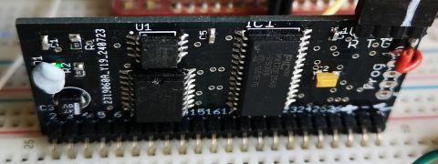

years ago, I made my own little board just so I could drop a mite in where needed. It has several iterations with improvements and mistakes. This has now settled on my SIL "compute module" which I can just drop into anything where it needs a bit of "brains" for something - it doesn't need to be mounted on a bord or anything - just dangling on a connector on the end of some wires will do if necessary. This is currently in design for a Mk2 which will include add-ins like breakable link for diode on a serial multi-drop (allows RS485-like addressed multi drop but without the 485 driver)
I aim for "fit n forget" solutions and the above combo delivers that.

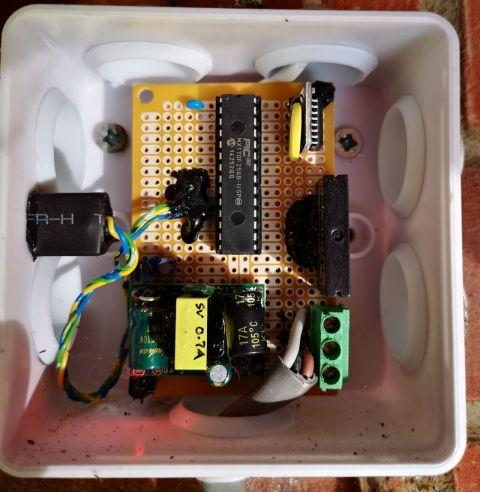

prototype Dusk2Dawn controller for exterior(?) lights. still in use, just looked at the code running - 2017 without a hiccup - this is why I love the '170+MMBasic 5.04.08 (don't judge - I have my reasons) it really can be relied upon for outrageous uptimes.

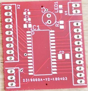

my 170 MM2

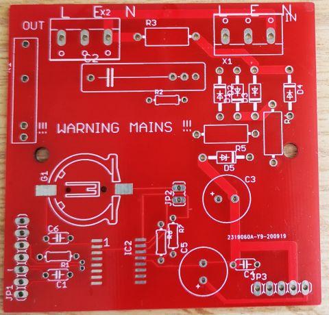

became this bright little thing with RTC and 8MB flash on-board, multi drop serial, multi <18V supply - very capable combo

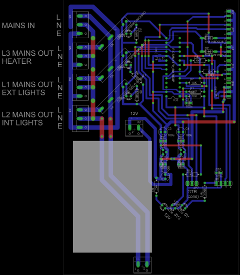

garage controller that does the roller door, the interior and exterior lights, keeps a cold water pipe warm (had two bursts over the years) with bluetooth and it's own Android App
which became this (spot the bug)
My daily drivers are a MMX with tiddly VGA monitor and a SIL compute module where I play MMBasic and use them to test software and solve daily tribulations.

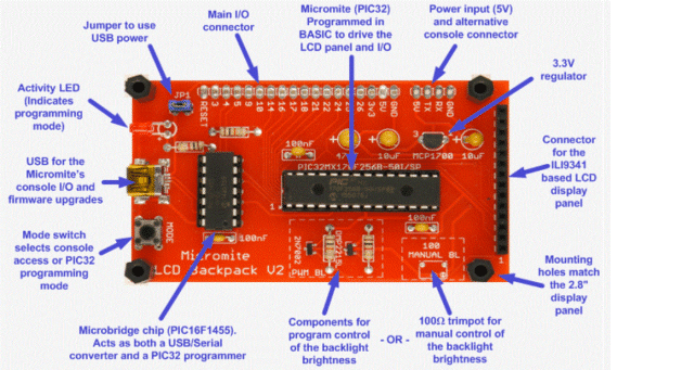

Another MX170 PCB referred to by @jwettroth is Geoff's LCD Backpack:
Documented here
I downloaded the Construction Pack from that link, pulled out the gerbers and zipped them, and sent them to JLCPCB. The boards were rendered correctly, but the size was given as 100mm by 100mm and the price was increased from $2 to $4, so (as suggested in the documentation), the drill file (or something) was not fully in accordance with JLCPCB's requirements. I did not complete the order.
@CircuitGizmos also had MX170 PCBs I believe, but his site is http not https, and I don't know if it is currently supported, so I didn't look there.

  lizby said  Please do hog away, Cap'n. Beautiful work. Gerbers available for any of them? In particular, the SIL version?
not as beautiful as some I have seen but all very practical, but thanks anyway
I can make the SIL gerbers available but there is a better version on its way (lots of improvements). Haven't done much to it for a few months but I will re-double my efforts and see if I can't get it up soon. I must say is it just a mega useful board and upto 16MB of storage is really useful - of course you don't *have* to have the flash or RTC - all depends on application
Posted: 08:08pm 09 Mar 2025
Cap'n--please do make the SIL gerbers available. At $4.?? for 5 boards from JLCPCB, I'm not very much hurt if I replace with the "better version" at a later date (looking forward to that).

I’m surprised JLCPCB had any problems building the LCD Backpack V2 board, because I ordered 5 boards from them in 2019 and built one up and it works  just fine. I think I paid $5 plus slow shipping. I had a question about the LCD backlighting, which was quickly answered on this forum. It was a fun build.
Posted: 03:16am 10 Mar 2025
  al18 said  I’m surprised JLCPCB had any problems building the LCD Backpack V2 board
I'm not sure they would actually have had problems, since the board rendered ok in the images they provided. However, since they changed the price and considered that the board would be 100mm by 100mm, I didn't pursue it.
Do you remember if you had any interaction with them to clarify any issues?

Meanwhile, I revisited Geoff's MX170 Backpack, and this time JLCPCB had the price as $2, not $4, and the image rendering looked right so I placed the order.
