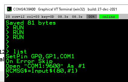

Posts: 10105
Posted: 03:25am 08 Mar 2025
Have you set the pins for COM1?
Manual page 175, Appendix A...
I get the same error, until I comment-out the ON ERROR SKIP command.
I suspect you have forgotten to assign the COM1 port pins.
The code then skips opening the port(cos it can't as the pins are not assigned), and executes the next line, which is you trying to suck data from the buffer - at which point the interpreter falls over and moans that the port is not open.

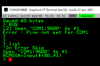

Posts: 10105
Posted: 03:31am 08 Mar 2025
Please comment out the ON ERROR SKIP command, rerun the code, and see what error message you get...
If I set the COM port pins, and use your exact code, it runs without issue....
Edited 2025-03-08 13:35 by Grogster

Posts: 10105
Posted: 03:40am 08 Mar 2025
THAT is weird..
It's telling you both that the port is NOT open, and also that it is.....
