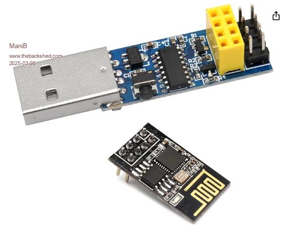

The Colour Maximite 2 User Manual describes on page 10: "ESP-01 Module
There is a footprint on the PCB for connecting an ESP-01 WiFi module to COM2. Version 5.07.00 and later of the firmware allows COM2 to be used as a serial console so if the correct USB/UART code is loaded into the ESP-01 it will be possible to access the console of the CMM2 remotely.
At this time MMBasic does not include any Internet functions using this device in but communications can be established using the normal serial communications protocol included in MMBasic
What is not mentioned, however, is what exactly this “correct USB/UART code” means.
Probably another topic that I should actually know about, but unfortunately I don't have a clue again. Searching the forum for the keyword ESP-01 also brought some interesting posts to light (1 or 2), but it didn't help me.
Can anyone tell me which USB/UART code I need to copy to the ESP-01 WiFi module?
I have ordered this module including programmer: ESP-01 Prog WiFi Programmer
Many thanks in advance.

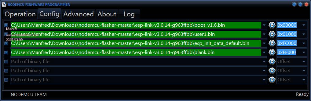

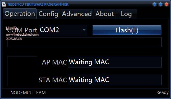

- **Flash the Firmware**:
 1. Open the ESP Flash Download Tool.
 2. Load the firmware:
    - Select the `.bin` file and set the address to `0x00000`.
    - Example: `esp-link-v3.2.x-1M.bin` at `0x00000`.

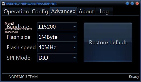

 3. Configure settings:
    - Flash Mode: DIO (or DOUT, depending on your ESP-01).
    - Flash Size: 1MB or 512KB (match your module).
    - Baud Rate: 115200.
 4. Click “START” to flash.
 5. After completion, switch the programmer to “UART” mode and reset the ESP-01 (remove and reinsert it).

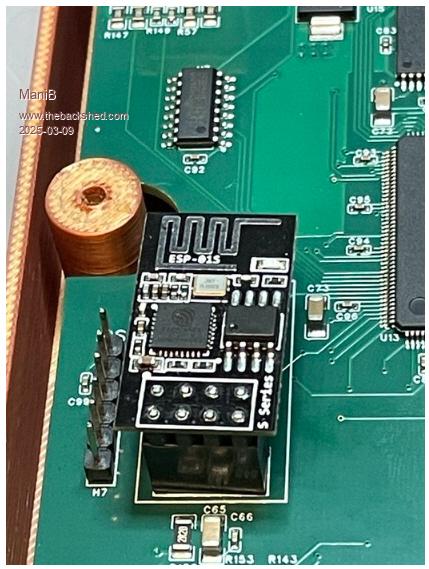

#### 4. Install on CMM2
- **Physical Connection**:
 - Place the ESP-01 into the CMM2 G2’s ESP-01 footprint (ensure TX on ESP-01 connects to RX on COM2, and RX to TX).
 - The CMM2 should power the ESP-01 at 3.3V via the footprint.

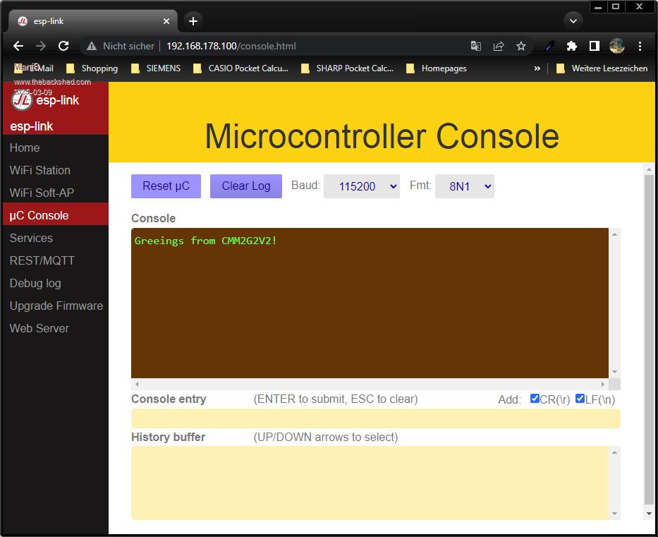

#### 5. Access the CMM2 Console Remotely
- **TCP Connection**:
 - On your computer, use a TCP client (e.g., PuTTY in RAW mode or Telnet):
   - Host: ESP-01’s IP address (e.g., `192.168.1.100`).
   - Port: 23 (ESP-Link’s default for transparent UART).
 - Connect, and you should see the CMM2’s console output (e.g., MMBasic prompt).
- **Test Commands**:
 - Type commands (e.g., `PRINT "Hello"`) and verify they execute on the CMM2.

The ESP-01 comes with default (but perhaps outdated) AT software, but that will not give you a transparent link. Peter Mather and others have posted several ways to use the AT software, but the process is quite convoluted.
If what you want is to be able to remotely access the CMM2 command prompt through the ESP-01, you want ESP-Link. You can find on the forum that several people have done this.
The process provided by Grok looks, in general, appropriate.
I assume that the pushbutton on the side of your programming module is there to put the ESP-01 into flashing mode--is that what the documentation says? In that case, you are likely to have to hold that button in when you insert the module into the USB socket. Then you can release and it should be in programming mode.

3. Put the ESP-01 module on the USB programmer and activate the programmer mode
4. Start the nodemcu-flasher tool and make these configuration:
5. Check also the advanced settings
6. Start flashing
7. After flashing is complete, disconnect the ESP-01 module and put it in your CMM2 G2
8. Turn on your CMM2 G2, take your smartphone to establish a Wi-Fi connection with the ESP-01.

10. The ESP-01 then connects to the WLAN and is assigned its own IP address (e.g. 192.168.178.100).
With the browser on your PC, this new IP address can be opened with http://192.168.178.100/home.html to make further settings.
