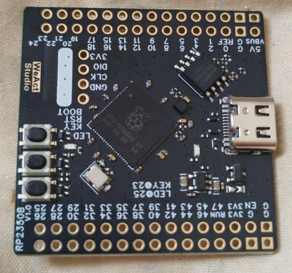

Hello.
I ordered this pcb from here.
https://pl.aliexpress.com/item/1005008404804398.html?aff_fcid=462c03b2748148e6b5581318d53135f1-1741081937572-06119-_oofC5PP&tt=CPS_NORMAL&aff_fsk=_oofC5PP&aff_platform=shareComponent-detail&sk=_oofC5PP&aff_trace_key=462c03b2748148e6b5581318d53135f1-1741081937572-06119-_oofC5PP&terminal_id=37e83931330948c2abe9075449702469&afSmartRedirect=y&gatewayAdapt=glo2pol
https://www.cnx-software.com/2025/02/03/tiny-weact-rp2350b-core-board-exposes-all-48-i-os-from-the-raspberry-pi-rp2350b-microcontroller/
I wonder if it will work on all pins.
PS Sorry for my English, but I'm old enough to use a translator. Best regards.

It will probably meet the Raspberry Pi specification. I wouldn't take any bets on it exceeding the specification though.
Personally I wouldn't buy one until I had the schematic.

Schematic shows USB-C. At first, I thought it was micro-USB.
RP2350B_SCH.pdf
Posts: 9328
Posted: 01:29pm 04 Mar 2025
Sensible people. They put PSRAM CS on GP0 and the LED on GP25.

I really like the layout of this WeAct as there is no need to route the traces on a PCB through the pins. It only lacks on having the bootsel broken out and that it has no PSRAM by default (but you can easily solder it).
The best layout (for Hobbyists) is Peters 64-pin dual-in-line RP3250B development board
Too bad that it wont't be produced, but hope dies last
@guma1975 Please report back when you got it how overclocking works.

A reliable board. I just bought 10 of them. The size reminds me of the Intel 486. WeAct PSRAM CS  is connected to GP0. Perhaps the PSRam option can also be set to GP0. If not—no problem—remove R14 and connect the solder pad to GP47, and the PSRAM will work. This is described several times on the forum.
RM2 Wi-Fi module. Connect the GP23, GP24, GP25, and GP29 to the RM2. To ensure the board runs without a reset, you’ll need to remove the zero-ohm resistor on the WeAct board (see photo).Firmware Webmite 7.0.00B8 works without any patches, etc., without any problems.
