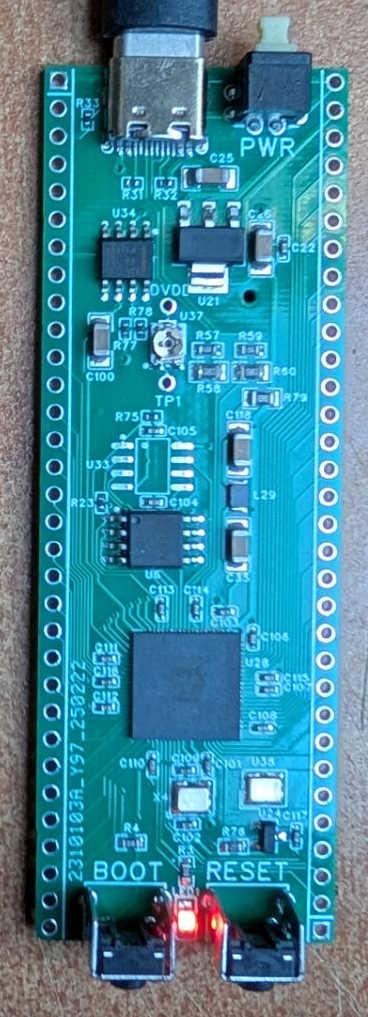

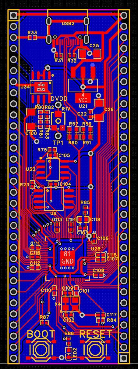

Pico2350DIL.zip
This file contains the design files, schematics, gerbers, BOM, and Pick&place files for two versions of the 64-pin dual-in-line RP3250B development board.
These boards can now be made by JLC who have stock of the RP2350B processors. The boards include positions for the APS6404L-3SQR-SN PSRAM chips but these are currently out of stock at JLC. See the link for the ones I purchased. They are SOP8 packages so easy enough to hand solder.
V1.1 is the board I have just had made
V1.2 is a cut down board designed to minimise costs (costed at $49 for 5 at JLC)
V1.1 is tested to 396MHz without the PSRAM and 378MHz with PSRAM as well as at 1280x720 resolution HDMI (372MHz).
IMPORTANT: before powering up one of these boards the potentiometer that sets the DVDD voltage should be adjusted. Connect a multimeter across the test points TP1 and DVDD and adjust the resistance  to set the voltage - DVDD = 1.0V + 0.1V per 6kohm
For overclocking to 378MHz you will need a voltage of 1.4-1.5V. NB: the firmware already does this using the internal regulator in the RP2350 so this is within known limits.
The board breaks out all 48 GPIO pins on the RP2350B except GP0 which is reserved for the PSRAM chip select. By default with the PicoMite firmware variants the heartbeat is not enabled for the RP2350B but you can use OPTION HEARTBEAT ON to enable it if required on GP25.

If using the V1.2 files in this post make sure you untick U34/U25 which are the 32-pin headers as they will install them on the wrong side. UPdate versions posted below
Footnote added 2025-03-01 03:15 by matherp
U35/U36

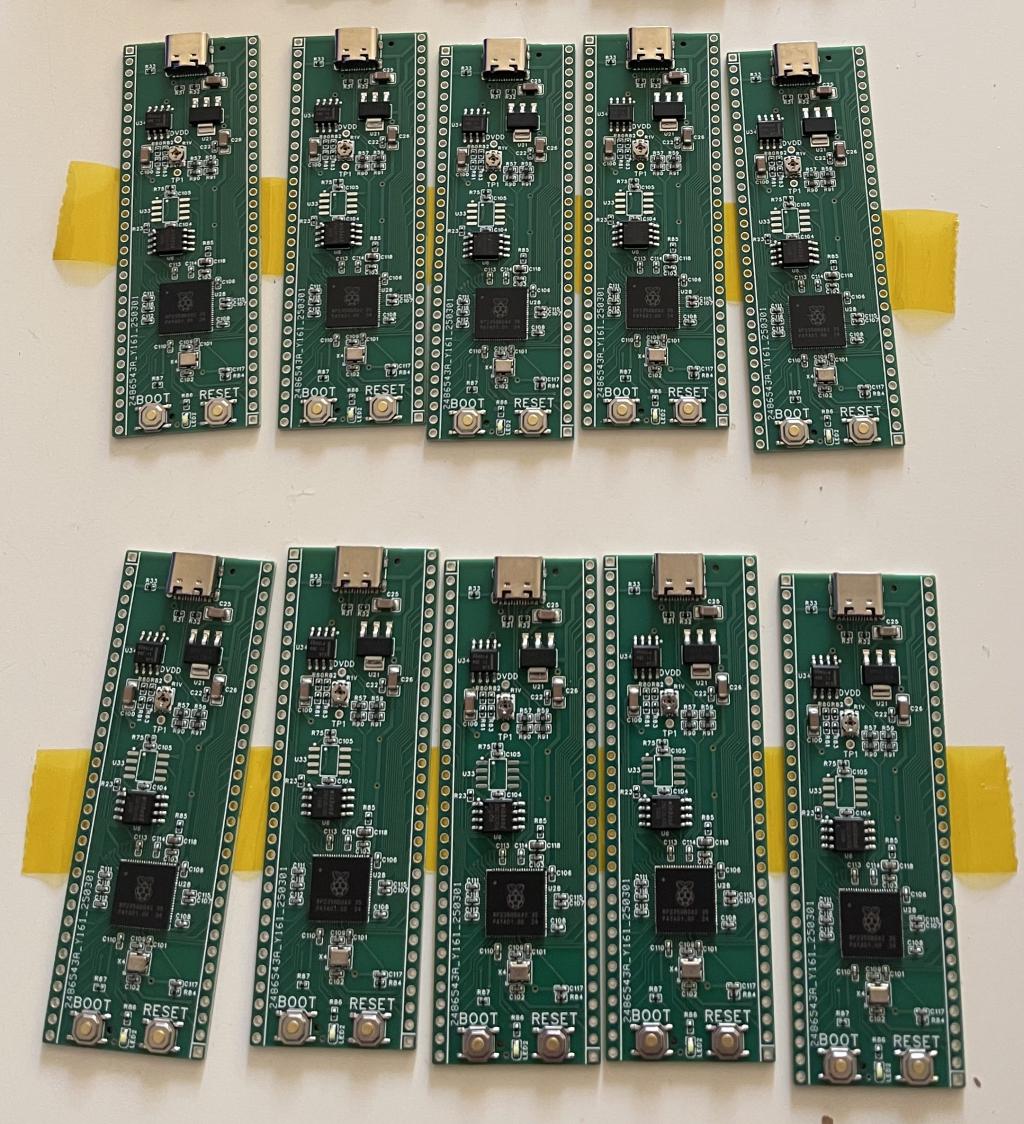

Posted: 07:52pm 28 Feb 2025
I misunderstood and sent the whole original zip file. Have now submitted the 3 relevant files from that file--gerbers, BOM, and pick & place. All successful--though I had to affirm a whole new list of items that I would comply with, including not re-exporting to Russia.

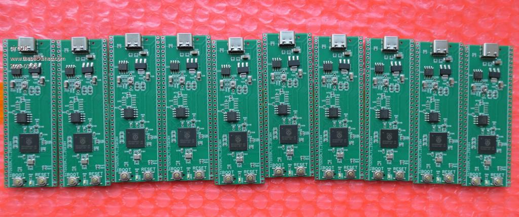

This is to confirm that I have just received the 2350B DIL modules from JLC (they look great Peter!).
Because JLC were out of stock of the PSRAM chips, I ordered genuine parts from Mouser; these arrived yesterday so I have everything needed to begin shipping these out.
For those of you that have been in touch via PM or email, I will start processing your units today with the intention of dispatching by end of tomorrow (Saturday).
For anyone interested, I am selling them at £12 per module as supplied by JLC (plus shipping). As mentioned above, the base module is without the PSRAM chip, and it is also without headers, but I can easily add any of these if required.

Can I suggest you set the pot before posting. Use a voltmeter between the DVDD test point and GND and set the voltage to 1.3V. This supports 378MHz operation using b16
Posts: 2998
Posted: 10:59am 07 Mar 2025
  matherp said  Can I suggest you set the pot before posting. Use a voltmeter between the DVDD test point and GND and set the voltage to 1.3V. This supports 378MHz operation using b16
What amazing timing - was just setting it as you were no doubt typing. I set it to 12K and then read your post.....

GP47 is much harder to route and the lines need to be kept as short as possible. A selectable link would increase the routing length and if you did that you couldn't then route both to I/O pins as you would have a long routing on the end of PSRAM SS.
As you identify I make sure there are no vias in the routes to the flash and PSRAM. I think this is important. You are of course free to modify the design in any way you want but it's on you if the overclock isn't as stable.

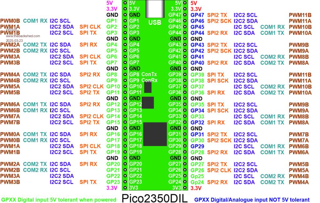

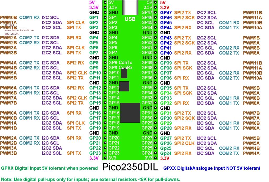

I rubbed the magic lamp and out came a genie (=genius) called Peter.  I wished for a DIL board for my 2350.  The genie sent me some magic spells and told me to send them to a mysterious place in China with some gold coins.  A week later, my wish came true and there they were, lying on the carpet next to the front door.
But seriously, Peter, I am totally delighted and thrilled to receive these boards; they were exactly what I had envisioned.  My gratitude knows no bounds, thank you.
I found that collating all the pin functions/designations for the board from the manual was a little challenging because some come from the 2040 diagram, others from paragraph text and the 5v tolerance from other threads.  I think that I have it right and therefore I enclose the mapping diagram below.  If anyone has the patience to check this out and proof read it, I would be most appreciative.  Corrections or an endorsement that is correct would be great.
Similarly, if it all correct and there is any space for it in a future manual then i would be delighted to upload a hi-res version in whatever format would be required.
Again, Peter, I cannot tell you just how much I value your work. Biggest thanks!

GP29,31,32, and 34 are 5V tolerant - RP2350 datasheet page 1321
Attached the data table that specifies pin use - it isn't impossible I've missed something but the definitive reference is RP2350 datasheet pages 18,19 and 20

I made a pin-out spreadsheet of the 2350 DIL last week. I probably should have waited but I'll check tomorrow night to see how many mistakes I've made.
However, I've already wired up an HDMI socket (on some proto-board & it's been a very long time since I last used a vero-pen) and it works perfectly attached to my 7" HDMI screen (the one with the strange VGA socket). Very clear text & graphics.
Next will be an SD card as I like to have one on my bigger Mites. It's a nice board.
Thank you Peter (& Phil for supplying it)
