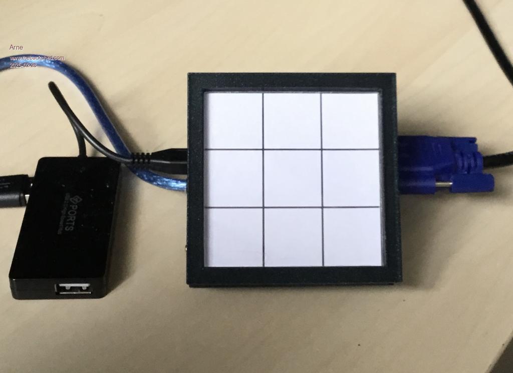

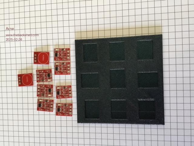

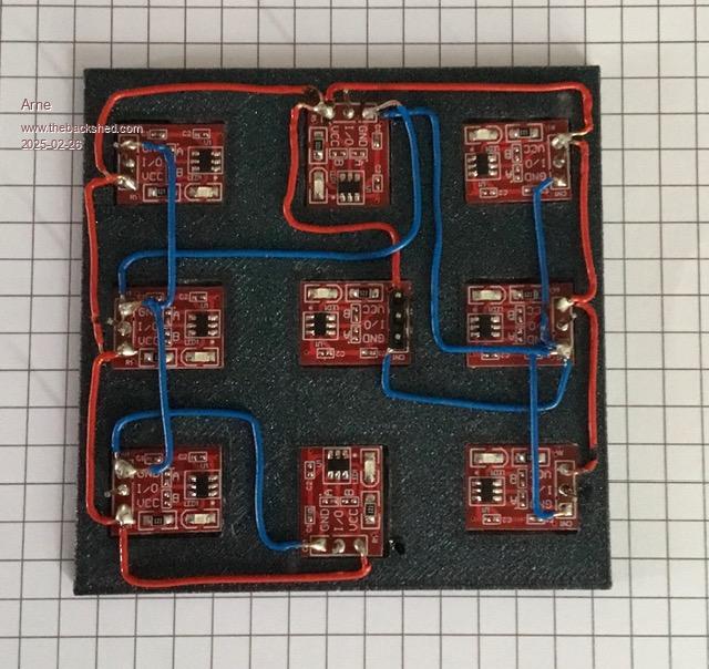

Based on TTP223 touch modules (100 pices for less than 8 Euros) I assembled following low cost touch panel for PicoMite:
Due to the fact that the touch sensors can be used behind different materials and located in different positions many use-cases are possible:
- Operation panels( e.g. touch pads/gesture controls/parallel button operation)
- Touch potentiometers(horizontal/vertical/round…)
- Fully covered PicoMite for wet environment
- Hidden touch operations
- etc.
The output of the touch modules are directly connected to the GPs of the Pico.
For test purposes a printed piece of paper was covered by a transparent 1 mm plastic-sheet sawed out of an old CD-case:
Everything worked without any problems.
Actually the Test-Pico is used as IR-remote control for my PC (control of different shortcuts via the touch pads). As USB-receiver a digispark programmed to understand Sony-protocol (which is integral part of MMbasic) is used.

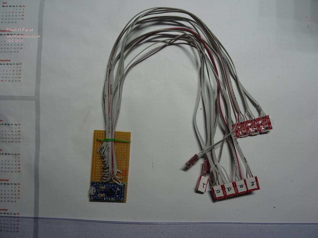

Yes, these things are really great! Two years ago, I used them to build a USB keyboard for a special application. The idea was to simply “press” 12 different letter keys...
