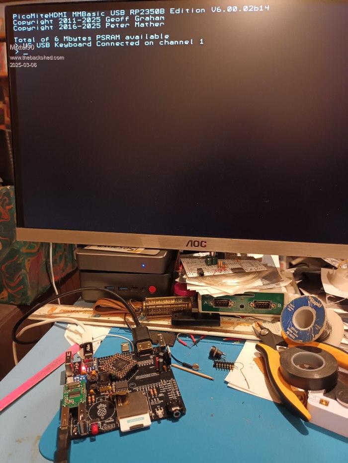

I've completed the previous proof of concept design and come up with this. It uses the Pimorini PGA2350 to build a sort of mini-CMM2. If you don't "do" SMD soldering you can use the Adafruit DVI breakout module to get the display. Only 3 USB sockets if you use the Adfafruit module though. I ran out of space. :(
There should be enough GPIO pins to keep most people happy, especially as all eight ADC pins are available if you build it as suggested. You also get the high speed counter input on GP1. GP0 is used for PSRAM_CS and instructions are included on exactly how to do this.
All the usual bits - USB hub, mini RTC & CR2032, IR receiver, full size SD card etc. No WII controller sockets though. USB should be fine.

It's getting there. I need to do the audio and I've run out of pins for the GPIO port. :(
A gotcha for those using the PGA2350. It has no pullup on RUN. That got me really confused. That's been the only electronic fault so far.

Hmmmm.....  :(
This project seems to have come to a sudden stop. I attempted to test HDMI at 1280 and, in spite of clearing the flash (I think), it seems to be bricked now. Even the console isn't working.
May that be a warning to you all - the PGA2350 mustn't be pushed!
I'll try a bit further but no promises. I'm unwilling to shell out for another PGA2350 at the moment, if at all.
Edit:
It's back but there is definite weirdness with HDMI. Mind you, I don't fully trust this monitor with HDMI. It's shown problems with the PicoMite version in the past and is very poor at switching between normal HDMI and the PicoMite version, taking a while to re-synch. I'm currently testing with 640, 252000 to give it the best chance.

Posts: 9136
Posted: 11:29am 06 Mar 2025
I've just done more or less that - going back to the original firmware (b14). You may have a point!

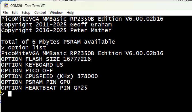

Posts: 11882
Posted: 11:41am 06 Mar 2025
Try this at 1280
PicoMiteHDMIUSBV6.00.02b16.zip

Posts: 9136
Posted: 12:24pm 06 Mar 2025
I've not managed to get it to run yet. In fact, it took a couple of reinstall attempts to get it back out of brick mode and back to b14.
I'll have another try now it's running again. :)
Posts: 9136
Posted: 12:37pm 06 Mar 2025
Nope. Nothing, not even the console. I tried wiping the flash first too. It will go back to b14 though!

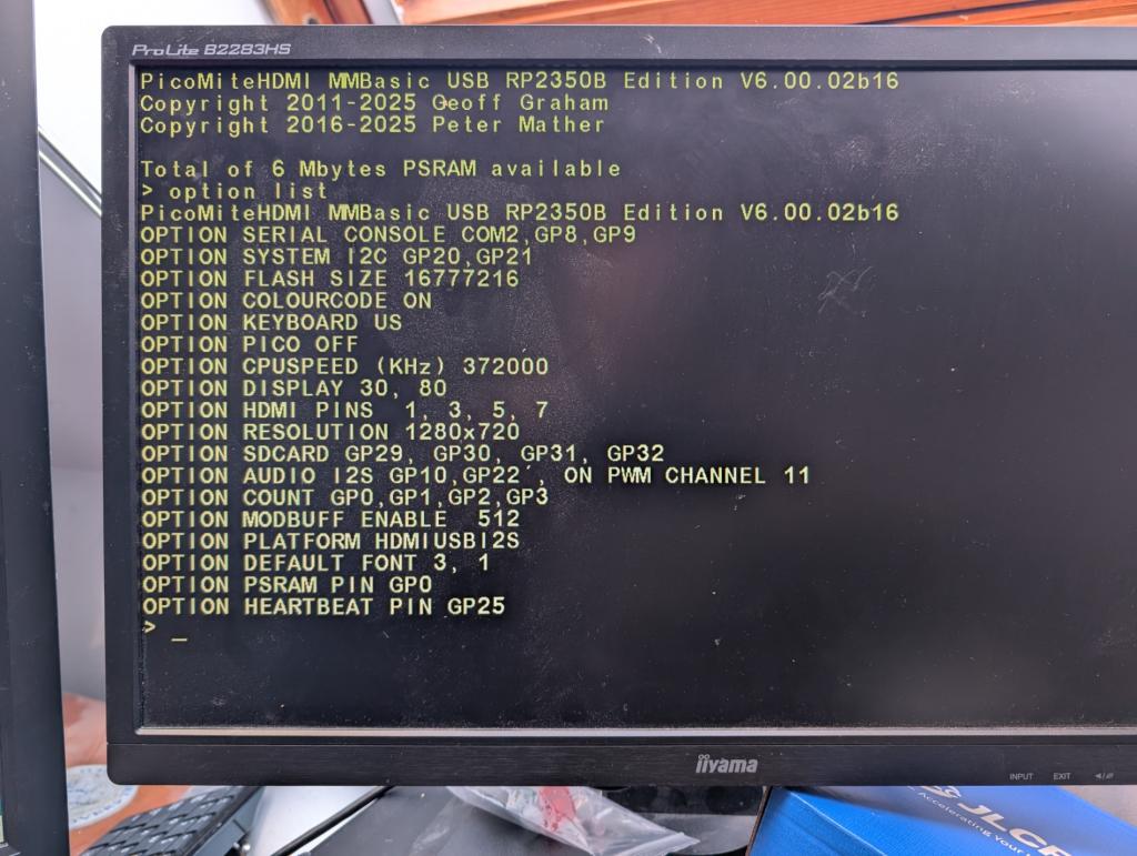

Posts: 11882
Posted: 12:42pm 06 Mar 2025
Works perfectly on my 64-pin DIL board

Posts: 11882
Posted: 12:56pm 06 Mar 2025
Full speed vga too...
