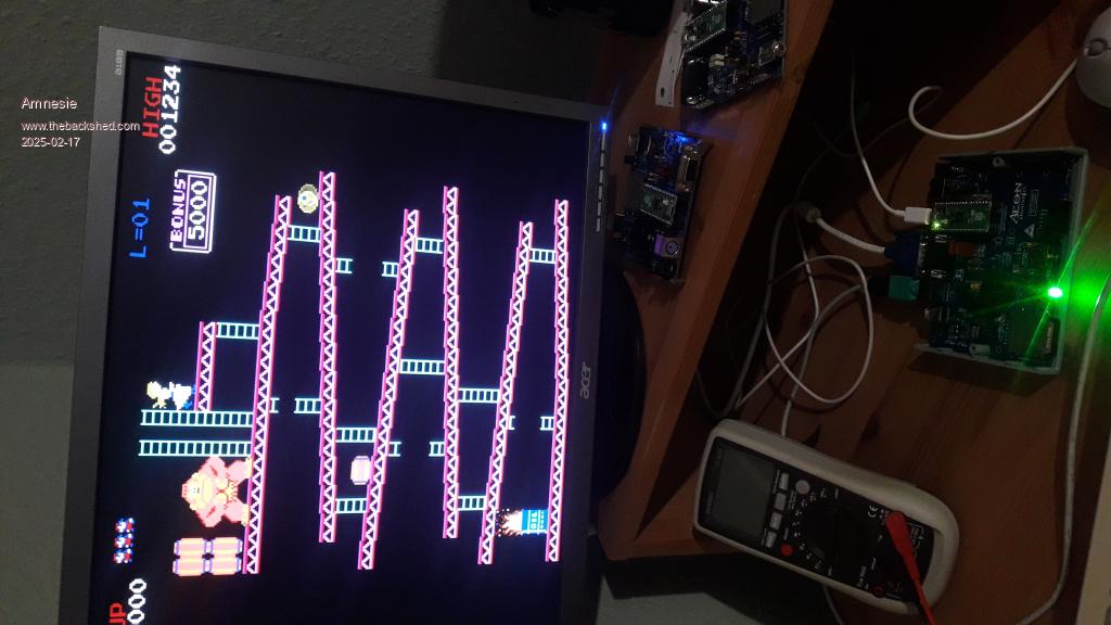

Posted: 05:35pm 16 Feb 2025
Hi Martin,
impressive work! I have no errors, but can't move the player (latest beta version).
You are the perfect game designer!
Greetings
Daniel

Posted: 05:48pm 16 Feb 2025
  Amnesie said  Hi Martin,
Daniel ,
This is still far from a finished game, rather a proove of the concept, whether and how the game could be created on the Pico. So, till now, you dont have a Player to move
Martin

Martin,
I am using the normal default modbuffer settings (no number specified) and have no problems with the latest beta version. So I can't replicate the "heap error"... Hm!
EDIT (!) I see you use "PicoMiteVGA MMBasic RP2040 Edition V6.00.01"
I tested only on Pico 2 board, no problems!
Greetings
Edited 2025-02-17 22:11 by Amnesie

Hi Volhout,
no problems on the Pico 2 (2350) on the latest beta - I let it loop over 4 cycles (and more for many times).
Maybe because Martin uses the RP2040?
Greetings
