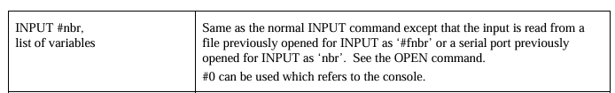

I'm being a bit thick - and this is almost certainly operator error, but I was trying to write out multiple integer values to a file and read them back in.
If I'm reading the manual right, I should be able to do
INPUT #1,a,b
to read values into a and b
But when I run the code below, it writes the variables out okay to the file. But when I do the reading back in, it loads a but not b

Well, don't I feel a bit foolish.
I re-read an old BASIC page and they used this line:
PRINT #1,a;",";b
to write out the data. An I just tested it and it worked fine.

  Peter63 said  You found a solution to this yourself   . I was just wondering if you checked how the variables were stored in the file the first version you used?
/Peter63
Yes.
PRINT #1,a;",";b
Stored it as
1, 2
PRINT #1,a,b
Stored it as
1   2
