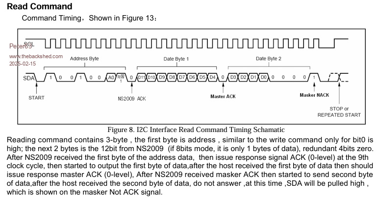

Need help
How to convert this C function to a MMBasic version?
//read 12bit data
unsigned int ns2009_read(uint8_t cmd)
   uint8_t buf[2];
   ns2009_recv(&cmd, 1, buf, 2);
   return (buf[0] << 4) | (buf[1] >> 4);

The c function is simple.
take the value in buf[0] and shift it left by 4 bits
(shifts everything along leaving the lower 4 bits clear)
Take the value in buf[1] and shift it right by 4 bits
(moves the 4 lsb bits into the upper 4 bits)
biwise OR the two bufs and return the result.
giving you the 12 bit result.
You can do the same thing with the MMBASIC Shift operators, and the OR operator.
Andy
Posted: 11:18am 15 Feb 2025
I think the 2nd explanation should be
(moves the 4 upper bits into the lower 4 bits)
(And because uint8_t is unsigned 8-bit type the upper bits shifted in will be zeros.)

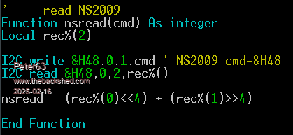

Posted: 09:25pm 15 Feb 2025
Assuming
option base 0
and I2C is opened at the start of the program and closed at the end
FUNCTION nsread(cmd) AS INTEGER
 LOCAL rec%(2)
 I2C WRITE &H48,0,1,cmd
 I2C READ &H48,0,2,rec%()
 nsread = (rec%(0)<<4) + (rec%(1)>>4)
END FUNCTION

Reading from NS2009 now works / thanks Jim
/Peter63
Posts: 9328
Posted: 08:42am 16 Feb 2025
That's a very neat solution, Jim. Mine was way too clumsy (and wrong as expected, of course). lol

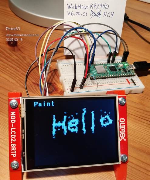

Posts: 220
Posted: 03:11pm 17 Feb 2025

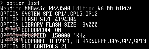

' Test program to read from NS2009
' 4-Wire Touch Screen Controller with I2C Interface
' using WebMite MMBasic RP2350A Edition V6.00.01RC9
CLS
Font 3
Text 0,0,"Paint"
SetPin GP0,GP1,I2C ' set I/O pins for I2C
screen_x_pixel = 320 ' 320
screen_y_pixel = 240 ' 240
Dim x As integer
Dim y As integer
Dim z As integer
I2C open 100,5000
z=nsread(HE0) ' read press-value
If z > 150 Then
 x=nsread(&HC0) ' read x-pos
 y=nsread(&HD0) ' read y-pos
 ' landscape mode screen_pixel flipped
 xx = Int(x * screen_y_pixel / 4096)
 yy = Int(y * screen_y_pixel / 4096)
 Circle yy,xx,2,1
End If
Loop Until Inkey$<>""
I2C close
End
