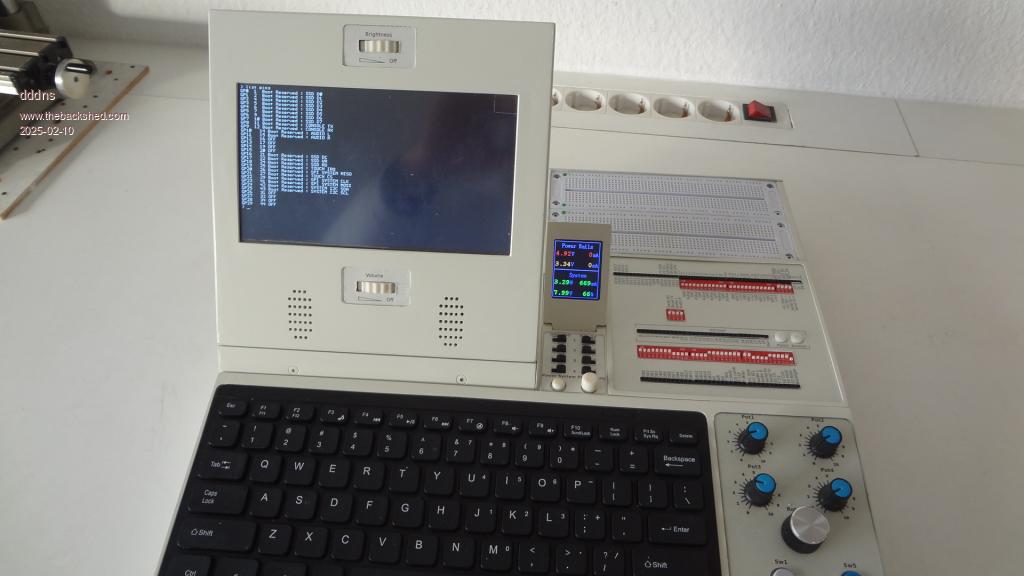

Hello!

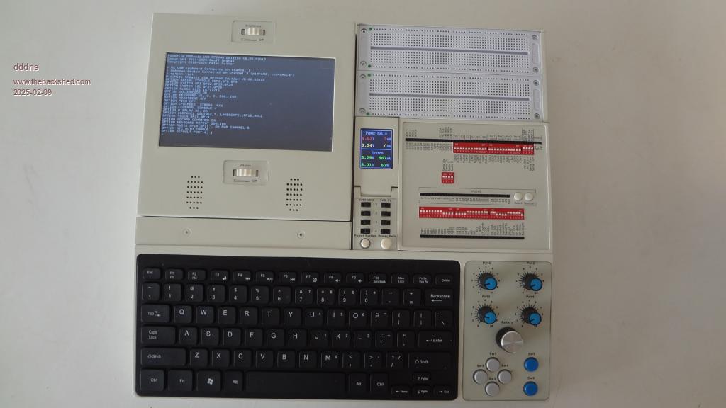

I finished my project and would like to share some pictures.
Only some polishing is left to do but it works already very nice.
I don't want to fish for compliments but maybe give some inspirations for the interested.
Have fun

Hi,

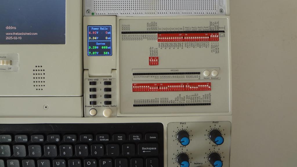

Impressive work of detail, I really like it!
Especially the breadboard area is cool, I have something similar in mind but not this big as yours. Cool to see some actual projects. For what are all those red DIP switches?

Hi dddns,
Looks very rugged and is beautiful painted. As an experimenters tool, you can't wish for any better. How many pico's are in there ? 1 for development, and 1 driving the screen (some sort of terminal)?

Posted: 06:39pm 09 Feb 2025

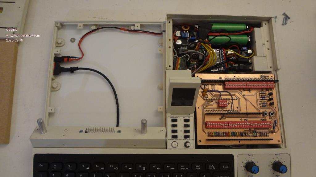

Thanks to everybody.
Each pin of the builtin peripherals goes to the outlet and
is then connected to the builtin pico through the switches.
So the pico and/or the peripherals can be used separately if the
according switches are off. You can have as well your own pin assignment by
interconnecting the according sockets with jump wires.
The power monitor is driven by an Atmel328p, the display is the 128x160 St7735
Edited 2025-02-10 04:45 by dddns

Nicely thought out and engineered.

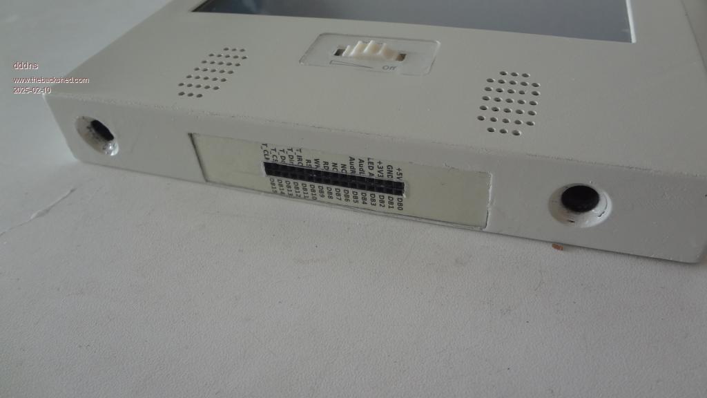

I'm intrigued about what exactly is in the main display screen module. It seems to be mountable in both landscape and portrait. My guess is 7 inch? touch screen- but how is it driven? The screen connector seems to have touch signals and a 16 bit i/o bus, along with led and power.

Thanks.
The display module consists out of a ssd1963 7" 800x480 touch lcd, a 3W amp and
two speakers and it will have its own pwm controller for the backlight.
It is mountable in portrait and landscape or usable stand alone.  it was below 40€ at the time i bought it.
It can be used in 8 or 16bit mode. So when configured in 8bit mode, there are 8 free GPs including all 4 ADCs. That why i have choosen to implement a second dip switchable pin config to free the ADCs which is regarding GP8 - GP11 and GP26-GP29.

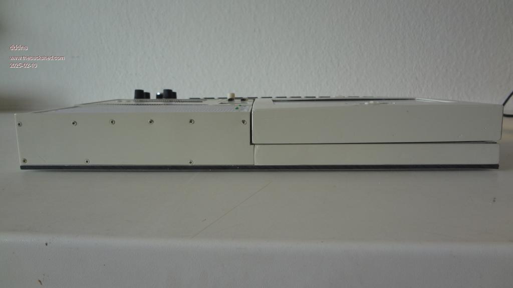

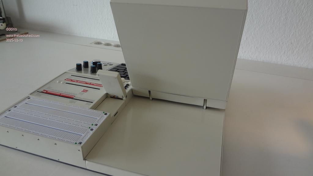

Posted: 08:36pm 10 Feb 2025
Everything is done by me at home. The body is made out of printed ABS/ASA parts.
The base plate, the backcover of the display and the cover for the space beneath the
display is a compound Alu/Platics material in 4 and 2mm, normally used for e.g. traffic signs and ideal for painting them after. All plastics are sanded, then a plastics primer and then paint from the car paint area.
