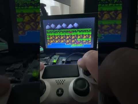

 Here I have set up the pico-infonesPlus project for PicoMite HDMI USB, please check its operation on your device?
Attention! HDMI video signal comes with sound and will only work on devices that are suitable for this, such as a TV ))
piconesPlus4picoMiteHDMIUSB.zip
USB keyboard and some gamepads work.
SD CARD is connected to ports:
CS    -- GP22
SCK   -- GP26
SPITX -- GP27
SPIRX -- GP28
Wii Classic Conroller:
I2C0 SDA -- GP20
i2C0 SCL -- GP21
NES Controller 1:     NES Controller 2:
NES1_CLK  -- GP0      NES2_CLK  -- GP3
NES1_LAT  -- GP1      NES2_LAT  -- GP4
NES1_DATA -- GP2      NES2_DATA -- GP5

Amnesie
Joined: 30/06/2020
Posts: 763
Posted: 10:49pm 07 Feb 2025
Mario does not work for me (yes exactly this version from your link, when I press X on usb keyboard), screen gets black and I am back in the menu.
BUT: I'm glad I also tried Zelda. This works with "X" key AND the most important thing you wanted to know:
SOUND works via HDMI! And it is great, no glitches, perfect quality. Imagequality is also perfect and rock solid (I tried bending the breadboard wires wildly) - no problems. Even played a round Zelda
Cool!
