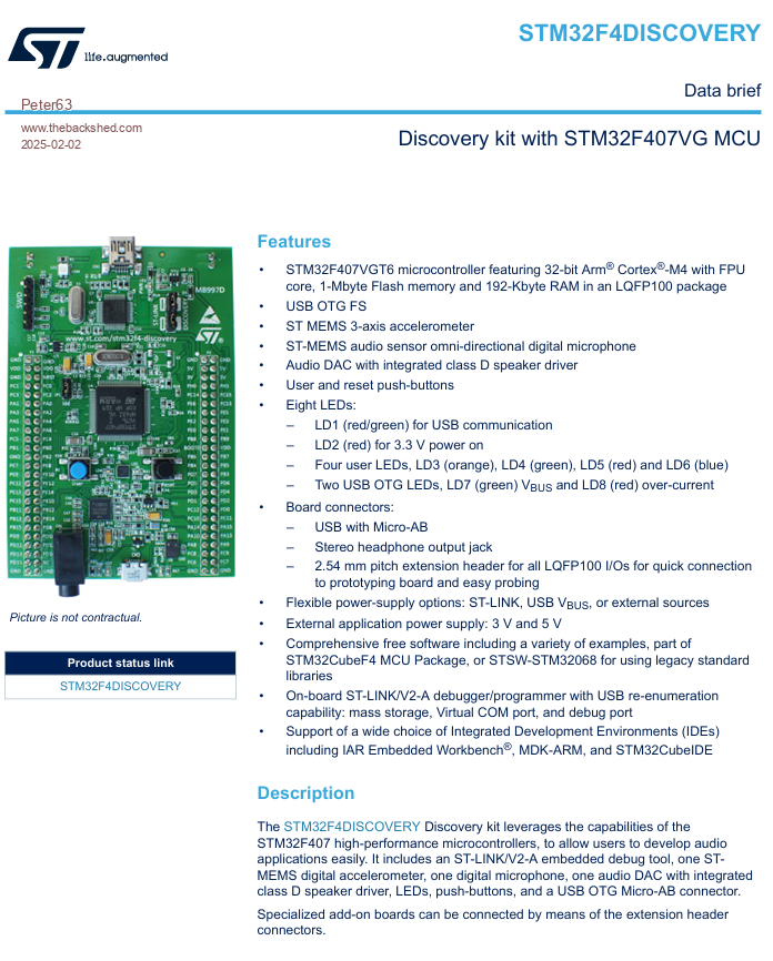

Is it possible to run mmbasic on stm32f4discovery ?

I suspect it might, using MMBasic for the ArmMite. The VET6 on that has 512K ram, the VGT6 has 1M RAM. However, that board might have things connected to pins that are allocated to something else on the ArmMite.
NOTE: Although it might run it may not support anything on the board!

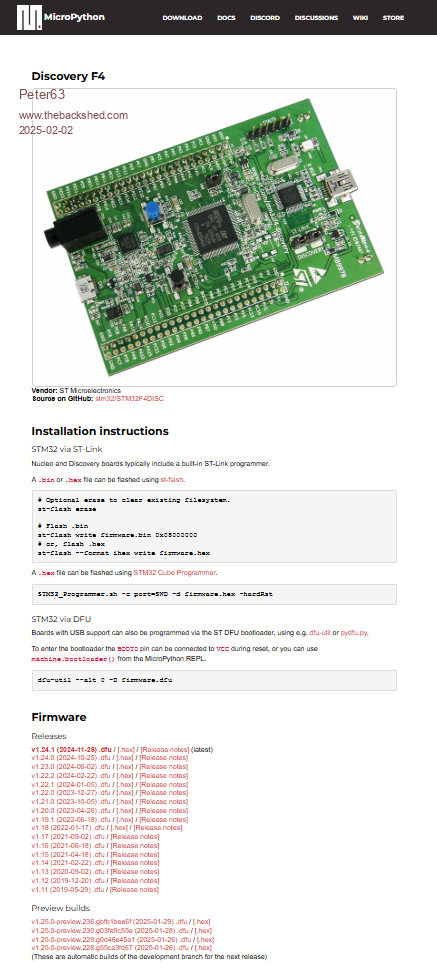

Thanks for the answer/Mick
There is micropython for stm32f4, which I might try.
Anyone who has tried programming stm32f4 in another way?
