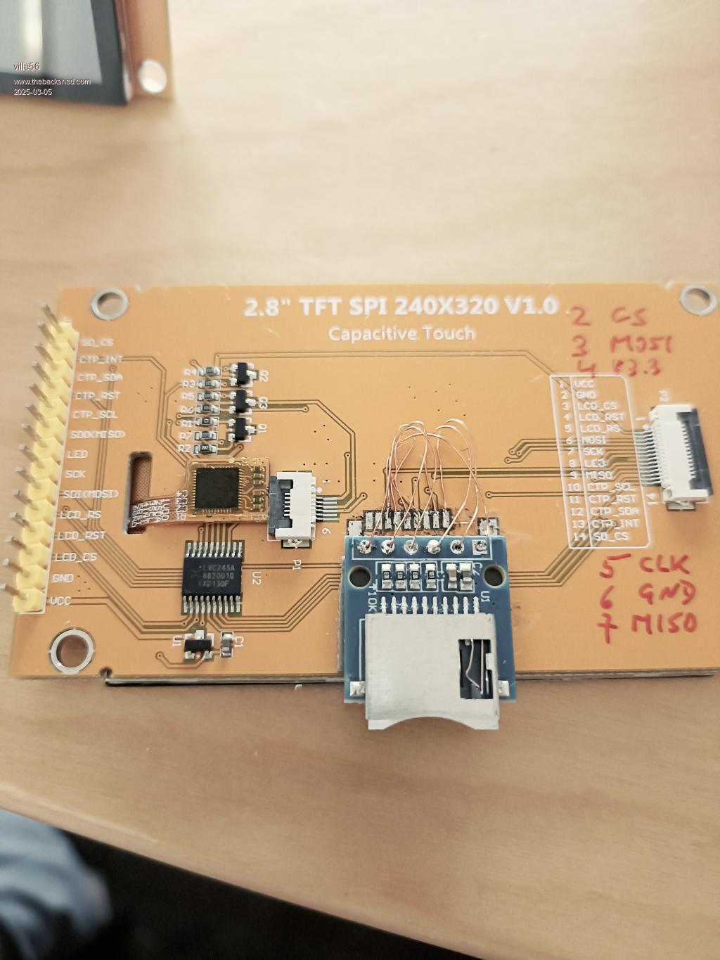

Just rewired the SD card connector correctly. The original wiring was rather weired, to be honest .... no idea what is should have been used for.
Removed the original connector completely and used a micro SD breakout board instead. Now the SD card is connected via the on board 74LVC245A and it works like a charm. So this type of level shifter (LVC245) seems to be compatible with the pico.

the DIR input of the LVC245 is not controlled at all, it is fixed to one direction, just tied to Vcc. The trick is that only signals going FROM the pico to the display/SD/CTP are level shifted. Signals from the display/SD/CTP TO the pico are left unchanged. So there is no need to control DIR pin. As the Display, CTP and the SD card are running with 3.3V this is no problem for the pico.
The touch chip has an additional level shifter composed of 2 MOSFET for the I2C SDA and CLK and only uses the LVC245 for the RESET signal. For the SDA signal the MOSFET is necessary as this signal is bidirectional. Again, the CTP IRQ signal to the pico is not level shifted.
Attached is the schematic diagram I am using ....

Posted: 11:54am 05 Mar 2025
  dddns said  Do I get that right, SPI MiSo of sd and tft are tied togethter on the board?
How long are the wires you connect it with?
yes, tied together.
As of the schematics every signal name beginning with 3V3 is level shifted. The MISO signal ist named TFT_SDO in the schematics and thus
a) not shifted and
b) the same for the TFT screen and the SD card.
The wires I use are about 3cm long and is a VERO-pen wire. This wire is about 0.1 mm in diameter and has the advantage that the insulation melts away with soldering iron temperatures. Normal magnet wire is a PITA to get the insulation off. Soldering to the SMD pads on the board was no problem, I did not even change to the SMD soldering tip.
