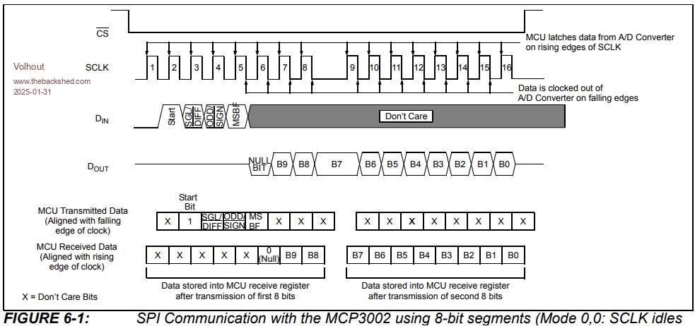

So summary:
- do not use a clock higher that 1MHz (the chip does 2 MHz max at 3.3V)
- use 16 bit transfers (or 2x8 bit transfers as below)
- you need to mask the read ADC value, since the MSB's are determined by pullup or pulldown.
- you need to use SPI mode 0 (called "0.0" in the datasheet). in essence this chip understands SPI mode 0 and 3, but not 1 and 2.
- you need to receive data while sending. use the function
value = SPI2( data )
 Do not use commands SPI WRITE and SPI READ, since these do not operate at the same time.
as TassyJim said: SPI2 OPEN 1000000,0,16
Edited 2025-01-31 18:24 by Volhout

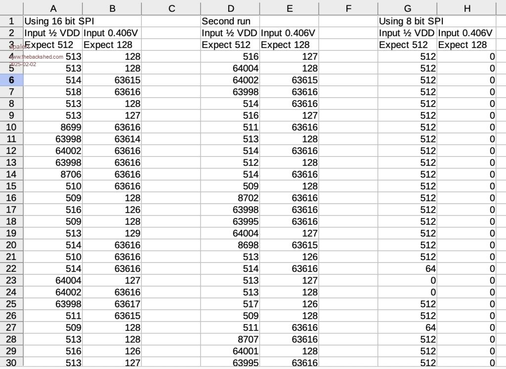

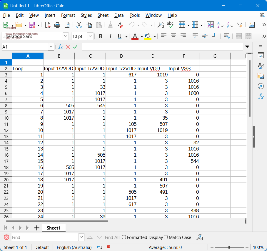

Many thanks for all suggestions, new version of code below. Hours have been spent tweaking. New ADC chip tried, wiring triple checked. Unfortunately output is still garbage :(
Below the code is a table of data returned. I put the code in a For x= 1 to 40 loop and ran it multiple times with 1/2VDD, VDD and VSS test voltage inputs. There is a curious pattern to the garbage!

Posted: 02:15am 02 Feb 2025
Including the start bit, you need 4 bits to set the configuration, one null bit and 10 data bits
By adding a low bit before the start bit, you have 16 bits nicely aligned
You can choose to use 8 bit spi or 16 bit spi. Either will work,

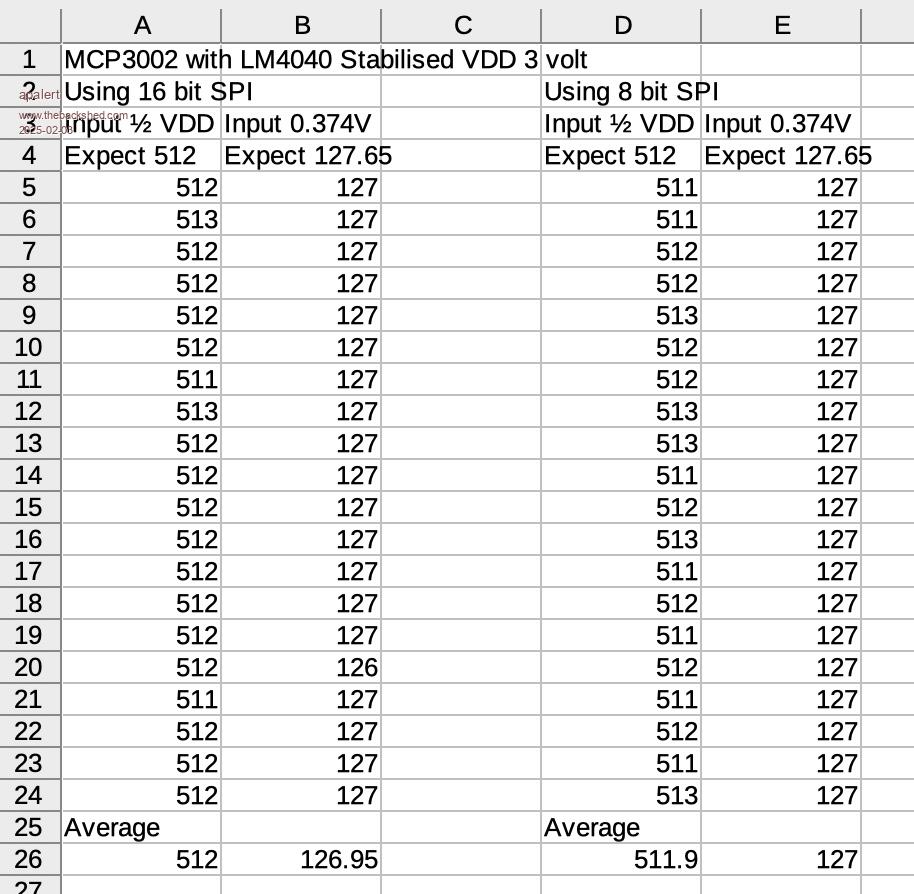

First time I have seen a result using 16 bit SPI. Playing with pauses all through the code varied correct data from 9/20 readings to 15/20. When I say correct, they are a tad off, expected 512 actually ranges from 508 to 515.
8 bit initially gave about 2/20 matching expected result. Playing with pauses lifted that to 18/20. And the good results were perfect 512! Second channel not working with the 8 bit though.
The way there is a run of good results then bad has me baffled. It's not related to run time.
Yes, I did have to cycle CS pin between reading the channels.

Pluto
Posted: 08:11pm 02 Feb 2025
I forgot to mask off the higher bits in the 16bit code
data0 = data0 AND &h3FF
etc
doing that will get rid of the obviously wrong readings.
In the 8 bit version I should have masked of bits for each SPI read before adding them together.
For some reason the second call to SPI2() is returning zero
This is why the v/2 readings are too constant at 512 and also why the 0.4V reading is 0 instead of ~128

apalert
Joined: 06/07/2023
Posts: 47
Posted: 09:31am 03 Feb 2025
  TassyJim said  I forgot to mask off the higher bits in the 16bit code
etc
Jim, did as you suggested and you have nailed it! Results are amazing.
Initially results were +/- 3. However I stabilised VDD on the VDC at 3 volts with an LM4040 and forced Pico into PWM mode while reading, now we get +/- 1 as per spec sheet.
Was able to remove all pauses and bring clock back up to 1000000. Time to take 20 readings around 7.5m/s when not printing result of each loop.
Hard to say which is better, 8 bit SPI or 16. Accuracy seems the same. 16 bit is a tiny bit faster.
Thanks so much for your input.
