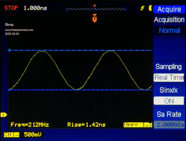

Posted: 02:27pm 03 Feb 2025
Hi Harm,
Thanks very much for the PIO Frequency test program, I can confirm the PIO on my 2040  will run at full clock frequency at 420MHz.
so I have 'Option CPUCLOCK 420000' and 'f0 = 420E6' in the code, which give me this. :-)
Which is probably not too bad, all things considered.
Thanks again.
Regards, Kevin.

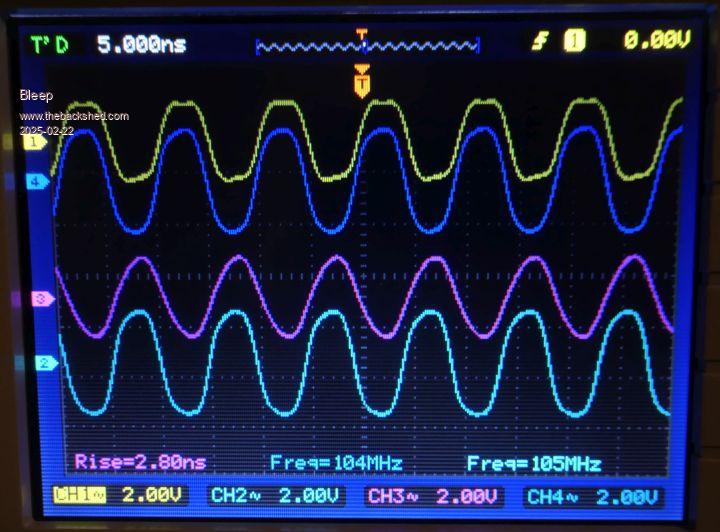

Posted: 02:45pm 19 Feb 2025
Hi Harm or Peter,
I've been experimenting with the PIO and Assembler.
Just because it looked like I could and I have a 4 channel scope, I wanted to modify your original code to now toggle 5 GPIO pins simultaniously, along with another 5 GPIO pins as Side Set, but out of phase.
I was originaly using the old assembler, but it looked as though there had been problems with compiling SideSet with that, so I've now swapped the the latest B11 and the new assembler.
This code was also to test the various drive strengths and speed settings, to see if there was a noticeable difference.
I have managed to get the 5 consecutive pins GPIO0 to GPIO4 all toggeling together, but have completely failed to get GPIO5 to GPIO9 to toggle using Side Set.
Any sugestions appreciated. :-)
Regards Kevin.

Posts: 6253
Posted: 06:50pm 19 Feb 2025
Your proble. Is that gpio 5..9 are not set as output.
In the new assembler Peter has added a funtion that automatically sets pins defined in pinctrl, as output. Very handy in your case.
You have to look for details in the 6.00.02 beta thread. It is invoked by adding some additional ,1,1,1 to one of the pio commands.
You could also remove the set pindirs.

Posted: 05:53pm 21 Feb 2025
Hi Harm or Peter,
I've spent all day trying to get this working, I've read and Re-read the Beta 02 thread.
Just to be quite sure, this is on a RP2040, running latest B11.
If I remove the "Set pindirs, &b11111" I get no GPIO toggeling at all, so for the moment I'm leaving that in.
I've reduced the side set to only toggle 1 GPIO, just to make it simpler.
Reading the Beta 02 tread, it appears I need to set a bit at the end of the "Pio(EXECCTRL GP0,Pio(.wrap target),Pio(.wrap),0,1)" to enable Side set?, but this appears to do nothing?
If I add the opt command ".side set 1 opt" I no longer get a square wave out from the GPIO0 to GPIO5 being driven with "Set pins" I now get a pulse every fifth clock, so a 20MHz pulse, So I have no idea what that is actually doing? again I have removed it.
So I'm back to where I was, I have got all 5 "Set Pins" GPIO0 to GPIO5 toggeling, giving a reasonable square wave at 100MHZ, but I cannot get any life out of the side set pin or pins?
Any help appreciated.
Regards, Kevin.
