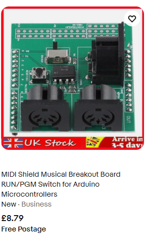

So, although not a sound module, we should be able to hook-up a MIDI shield to the PicoMite, right?

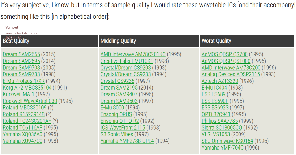

@Peter,
There is a sound quality difference between the 1053 that is implemented in PicoMite, and the SAM2695 when it comes to MIDI.
See this
I can imagine people looking for the SAM chip.....
