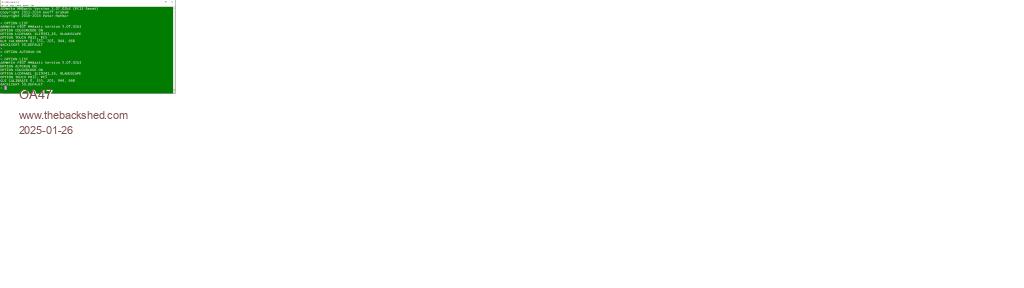

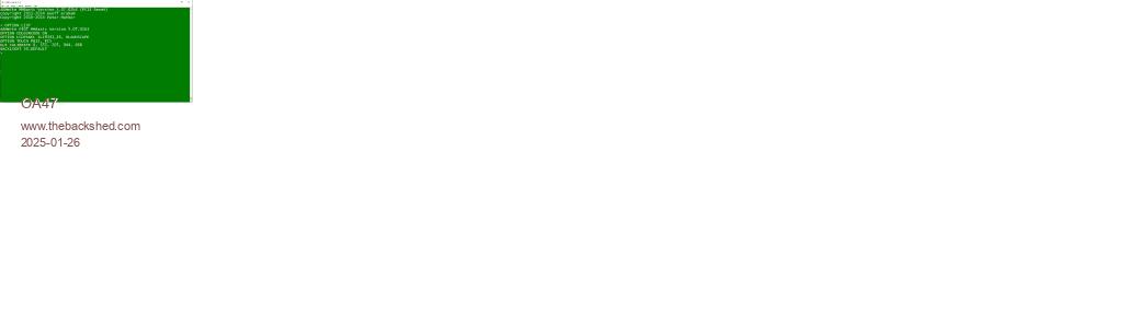

I have just noticed an issue with (PC13Reset) in that if I set OPTION AUTORUN ON it is lost when power is removed.
After applying power.
OA47
Posts: 3382
Posted: 02:43am 26 Jan 2025
I vaguely remember a flat coin cell causing a problem.**
Replaced the cell holder with a CR2032 one. Lasts much longer.
** I guess all coin cells are flat but you know what I mean ;)
disco4now
Joined: 18/12/2014
Posts: 1151
Posted: 03:54am 26 Jan 2025
A grounded PE3 will switch to the Serial Console and disconnect USB console on the normal firmware. Should not do anything on the PC13Reset software.
Options are still stored in battery backup ram so option AUTORUN is lost if battery is gone. Use MM.STARTUP to ensure a dead battery is not fatal.
SUB MM.STARTUP
OPTION AUTORUN ON
END SUB

OA47
Joined: 11/04/2012
Posts: 1051
Posted: 03:58am 26 Jan 2025
New battery seems to have been the answer to the AUTORUN issue.
  Quote  Options are still stored in battery backup ram so option AUTORUN is lost if battery is gone. Use MM.STARTUP to ensure a dead battery is not fatal.
SUB MM.STARTUP
OPTION AUTORUN ON
END SUB
Have added to the code.
Thankyou
