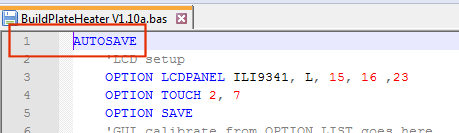

As already mentioned, Notepad++ is a great tool and the editor of choice for me. I like the way you can configure it for all sorts. Being able to edit multiple areas of the same file is a godsend not having to shovel large chunks of text back and forth. Bearing in mind, I develop straight into a console window, not a file transfer or anything... I embed commands and control codes in the source and deploying is simply a matter of Ctrl-A, Ctrl-C, right click in the (PuTTY) console window. Deployment takes 2-3 seconds which makes for a really quick dev environment
first line of file

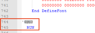

last line(s) of file
(that "SUB" is embedded CHR(26) - Ctrl-Z and so terminates the transfer)

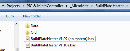

Each project lives in its own folder. The source lives at the top level, below which there will be two folders: "Old" for older versions and code fragments from experimentation etc... and "Data" whch will be pix, grabs, notes, PDFs for special components etc.
here's a real example... current milepost version and an alpha:
