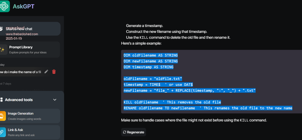

I'm editing this camera program written by Led_bloon. I'm trying to get it to generate automatic jpg captures that are sent to the B: SD card. I figured out how to rename the Test.jpg file after a fews days of trying (LOL , I'm very rusty).
I joined chat GPT and asked " how do I use a timestamp that varies as the name of a file" The answer gave me a clue.
here is the program. down around line 60 I have copy "*" to "b:" which i found out was illegal.  I tried to directly enter copy "*" to "B:/test".  It starts to copy but hangs, and never completes.
> copy "*" to "b:"
Copying 18-01-2025 17:50:32.jpg......just hangs here
I'm wondering is the name of my jpg file incorrect?
here's my screeen from chat GPT.  I can't find any books on basic so chat GPT helps with concepts.
I hope this helps someone.  My thanks again to Led_bloon!
