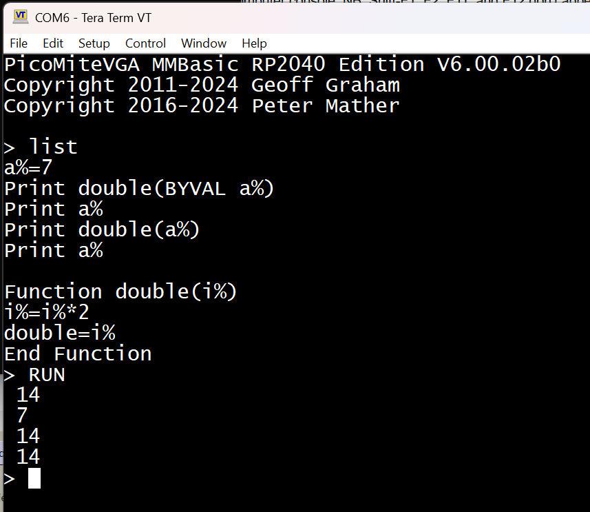

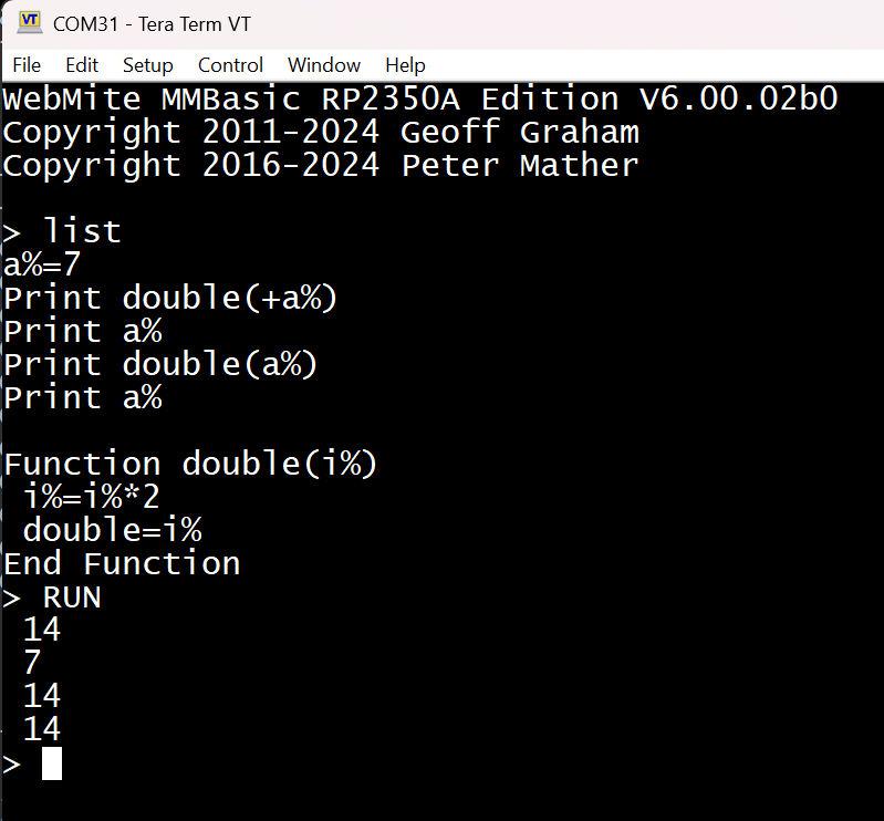

I've also played with this - does it make sense?
Note that BYVAL is effectively a unary operator and must be included in the call and can't be specified in the subroutine itself

Posted: 12:52pm 15 Jan 2025
  matherp said  I've also played with this - does it make sense?
Note that BYVAL is effectively a unary operator ...
Do we need that? Isn’t that identical to
a%=7
Print double((a%))
Print a%
Print double(a%)
Print a%
Function double(i%)
 i%=i%*2
 double=i%
End Function
Isn't a note in the manual enough?
causality ≠ correlation ≠ coincidence

Posts: 4369
Posted: 07:31pm 15 Jan 2025
  vegipete said  Suppose there were a preprocessor. Then we could
#define ByVal 0+
plus many other silly things.
This works in MMB4L:
MMBasic for Linux x86_64 v0.7-alpha.1
Copyright 2011-2024 Geoff Graham
Copyright 2016-2024 Peter Mather
Copyright 2021-2024 Thomas Hugo Williams
> load "byval.bas"
> list
#define "ByVal", "0+"
a%=7
Print double(ByVal a%)
Print a%
Print double(a%)
Print a%
Function double(i%)
i%=i%*2
double=i%
End Function
> run
14
7
14
14
It should also work on the CMM2, MMBasic for Windows, and possibly the PicoMite using the "CMM2 RUN" command.
