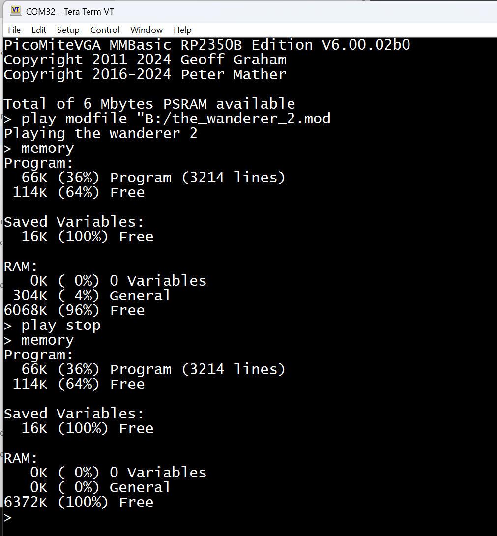

Posted: 04:41pm 15 Jan 2025
To play music in MOD format, a MODBUFFER is used, which is located in the Pico flash, and each time a composition is loaded, this area of ​​​​flash memory is reflashed, which is not good for intensive listening to many compositions.
Is it possible to make it so that if there is a PSRAM, this MODBUFFER is located in it?

Posts: 609
Posted: 05:10pm 15 Jan 2025
  Volhout said  A system is in place to only reprogram when changed.
Yes, but I wrote a music player and just listen to this music for hours and the compositions change one after another continuously.
And I'm already starting to worry about the state of Pico's flash memory!
That's why I'm saying that it wouldn't be bad to have this MODBUFFER in RAM in a configuration with PSRAM.

Posted: 05:25pm 15 Jan 2025
  Quote  To play music in MOD format, a MODBUFFER is used, which is located in the Pico flash, and each time a composition is loaded, this area of ​​​​flash memory is reflashed, which is not good for intensive listening to many compositions.
Wrong thread - but good idea
