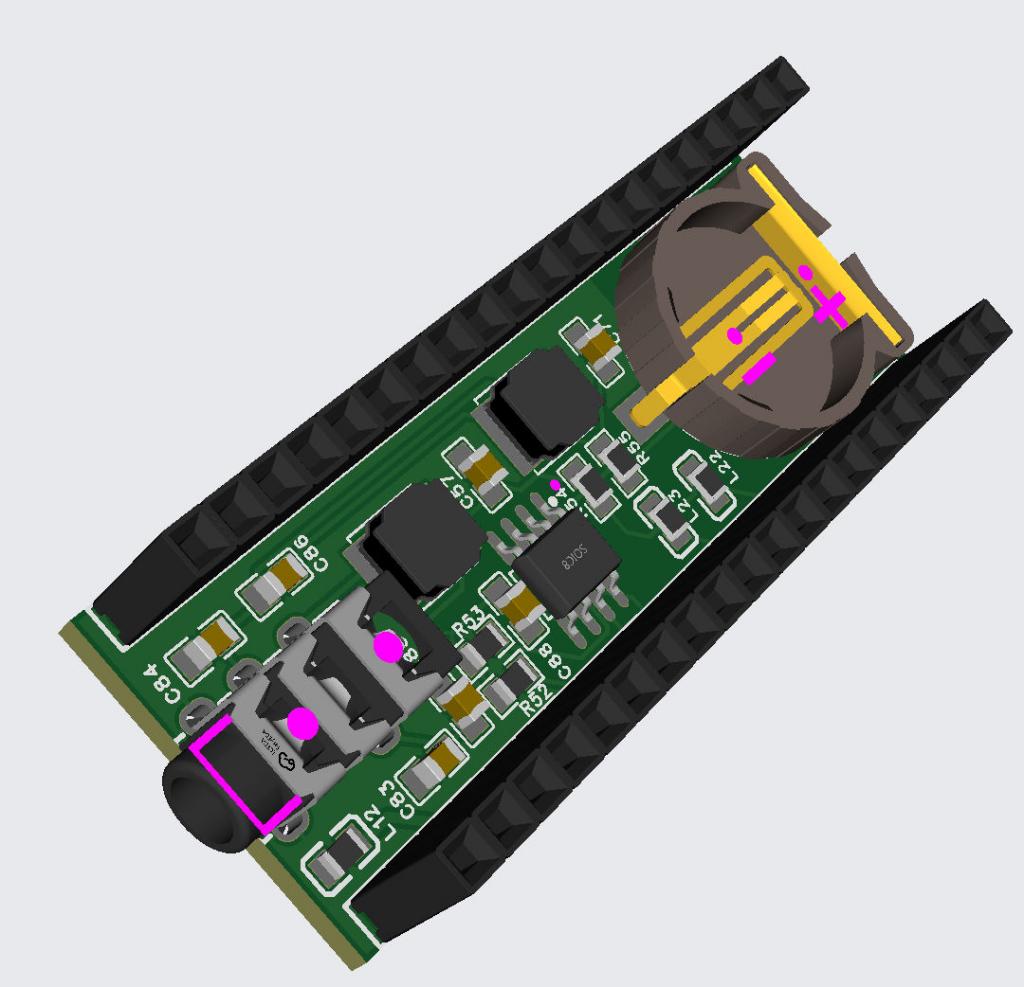

Geoff's VGA board is simple and effective but it doesn't include an RTC or audio output.
This is easily remedied
Gerbers
Gerber_PCB1_2025-01-11.zip
BOM and Pick-and-place
BOM_Board1_PCB1_2025-01-11.zip
Schematic
RTCAudio.pdf
Cost from JLC USD57 for 5 fully built. Can be hand soldered as no parts smaller than 0805

Posts: 11541
Posted: 07:33pm 11 Jan 2025
Oops. Got the pins wrong for the audio. Corrected below
RTCAudio.pdf

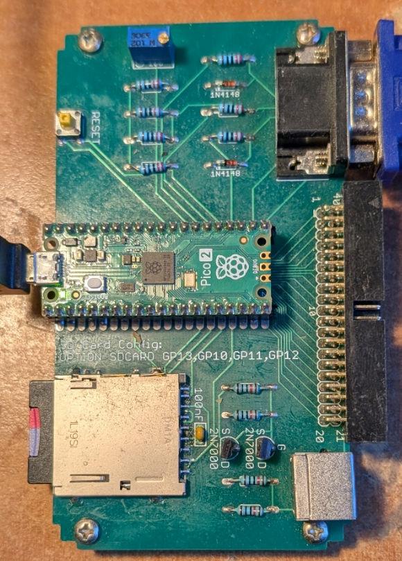

Posts: 5944
Posted: 09:24am 12 Jan 2025
Hi Peter,
It may be me, not understanding the details. But in case you connect audio to GP6/GP7 and I2C to GP14/GP15, VGA reference design 1 configuration is identical to VGA reference design 2.
Makes it a lot easier to configure. OPTION RESET VGA DESIGN 2. In stead of manual configuration.
Posts: 11541
Posted: 10:12am 12 Jan 2025
  Quote   But in case you connect audio to GP6/GP7 and I2C to GP14/GP15, VGA reference design 1 configuration is identical to VGA reference design 2.
Good idea. The previous design is still valid though for use on things like the Waveshare 2.8 and 3.5" displays.
RTCAudio.pdf
Gerber_PCB1_2025-01-12.zip
BOM_Board1_PCB1_2025-01-12.zip
Edited 2025-01-12 21:59 by matherp

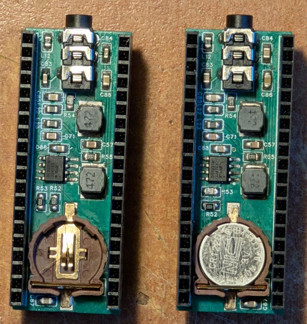

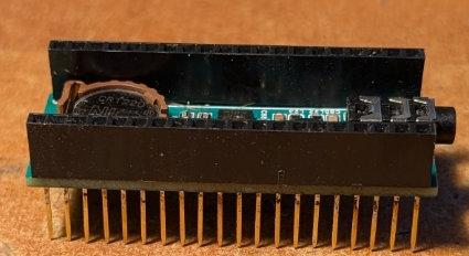

Posted: 04:25pm 21 Jan 2025
The boards have arrived and work perfectly.
These were hand soldered and for the first time I used a low temperature solder paste and the heat gun. As you can see it worked perfectly and is pretty much indistinguishable from "factory".
The PCBs cost £4.02 for 5 including tax and postage to the UK
The 20-way sockets I've installed have long legs so the boards can be stacked
There are two variants of the design as posted above.
The last version uses the configuration
OPTION AUDIO GP6,GP7
OPTION SYSTEM I2C GP14, GP15
and is compatible with Geoff's VGA board pictured above and on that board can be completely configured with OPTION RESET VGA DESIGN 2
The previous version is designed to be compatible with various of the Waveshare SPI displays like the Pico-RESTOUCH-LCD-2.8/3.5 and is configured with
OPTION AUDIO GP4,GP5
OPTION SYSTEM I2C GP6,GP7
Edited 2025-01-22 02:28 by matherp

  Quote   I used a low temperature solder paste and the heat gun
Can you let us have the product details, please, Pete. Just wanna get it right first time
Posts: 11541
Posted: 06:50pm 21 Jan 2025
Solder station
Solder paste
With the solder paste the thing to look out for is must be Sn42/Bi58
PhenixRising
Joined: 07/11/2023
Posts: 1963
Posted: 06:33am 22 Jan 2025
Cheers, I need to start playing with this stuff. The way I understand it is that a stencil can be ordered with the PCB to keep the components squared-up(?)
Posts: 11541
Posted: 08:40am 22 Jan 2025
  Quote  The way I understand it is that a stencil can be ordered with the PCB to keep the components squared-up(?)
The stencil is just used to apply the solder paste. Then the components still have to be added by hand. Alignment isn't critical as they will self-align when the solder melts. In a perfect world you can use a heated table or oven rather than a heat gun
e.g. Heated table
Edited 2025-01-22 18:41 by matherp
Posts: 8913
Posted: 09:37am 22 Jan 2025
You could, of course, always get confused (like I did) and end up with 183°C tin/lead rather than 138°C lead-free. :)  No, I didn't throw it away, I'm using it anyway. I don't solder SMD LEDs if I can possibly help it.
I've never attempted to use a stencil for the paste. The main thing that I've found is don't put too much paste on or you can get Mr Blobby problems, especially around HDMI sockets. :(
Posts: 5944
Posted: 09:45am 22 Jan 2025
Paste mask is essential for larger IC's, and fine geometies. For individual components as 1206, 0805 or even 0603, the syringe is fine. Also for pin-in-paste application (through hole components).
Do not use the bismuth solder paste for power components. Components may desolder themselves and drift off to sandy beaches. (sunny beaches pop up again... wonder why).
Edited 2025-01-22 19:47 by Volhout
