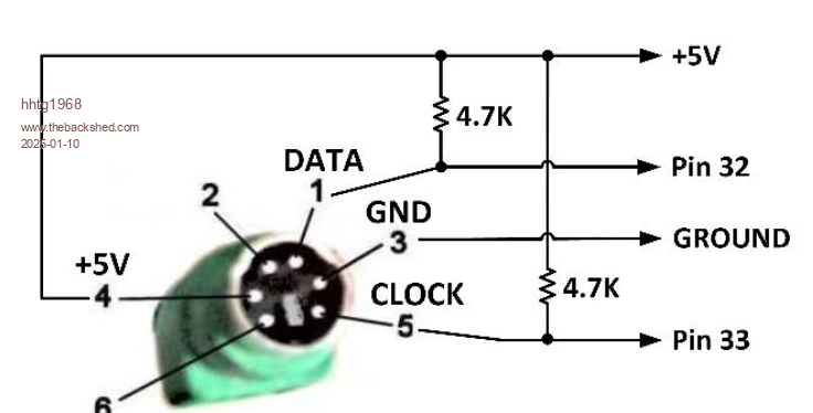

Hello. I want to connect a ps/2 mouse to my cmm2 gen1.
in the documentation i found an doc image.
i can connect to pin 33 and 32 and ground on the gpio. but where can i connect the 5v from the mouse?
there are 3.v pins, no 5v pins...
sorry for the silly question.

Posts: 4336
Posted: 03:50pm 09 Jan 2025
I think it means you need to provide 5V.

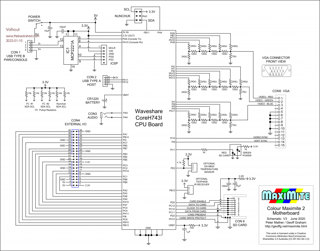

Posts: 8913
Posted: 04:05pm 09 Jan 2025
Pin 2 or pin 4 (manual page 10)

Posts: 5944
Posted: 04:07pm 09 Jan 2025
Hi
+5V is available at pin 2 and 4 of the 40 pin connector.
Posts: 8913
Posted: 06:38pm 09 Jan 2025
My brain must be going...
Of course the CMM2 supports direct connection of a PS2 mouse. Technically it's a USB mouse that supports the PS2 protocol though. It works fine - I modified my CMM2. It's on channel 0.

Posted: 08:22pm 09 Jan 2025
  Volhout said  Hi
Thank you very much.

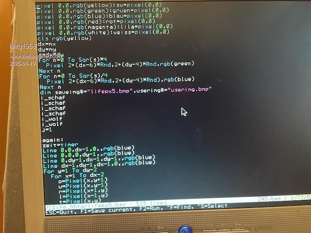

Posted: 09:11am 10 Jan 2025
And it runs well...
you can see the mouse "cursor"...
Thanks again.
Posts: 4369
Posted: 09:26am 10 Jan 2025
Just an observation @hhtg1968 but NEXT statements in MMBasic don't require the variable name, e.g. you can just write:
For i = 1 To 10
 For j = 20 To 30
   Print i, j
 Next ' No j required
Next ' No i required
And by doing so you would save 110 variable lookups, which is a worthwhile saving as variable lookup is quite an expensive operation.

hhtg1968
Joined: 25/05/2023
Posts: 204
Posted: 10:26pm 10 Jan 2025
  thwill said  Just an observation @hhtg1968 but NEXT statements in MMBasic don't require the variable name, e.g. you can just write:
For i = 1 To 10
 For j = 20 To 30
   Print i, j
thank you for the notice. i had measured it, it is actually faster...
