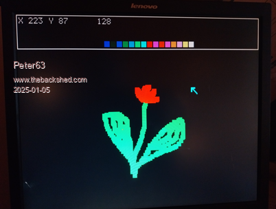

I'am using MODE 2 (320x240), VGA screen
tested Blit read 1,0,42,319,198
then Error: Not enough Heap memory
tested Save compressed image "pic1.bmp",0,42,319,198
crash , black screen , have to reboot Pico2
/Peter63

Tested  Save compressed image "pic2.bmp"
it works  jippi
Why didn't it work with, Save compressed image "pic2.bmp",0,42,319,198
i only want to save a part of the screen
/Peter63

  Peter63 said  I'am using MODE 2 (320x240), VGA screen
crash , black screen , have to reboot Pico2 ...
save image "pic3.bmp"
would work.

Tested again and it works with: Save image "pic1.bmp",0,42,319,198
This saved the part of the screen i wanted
/Peter63
