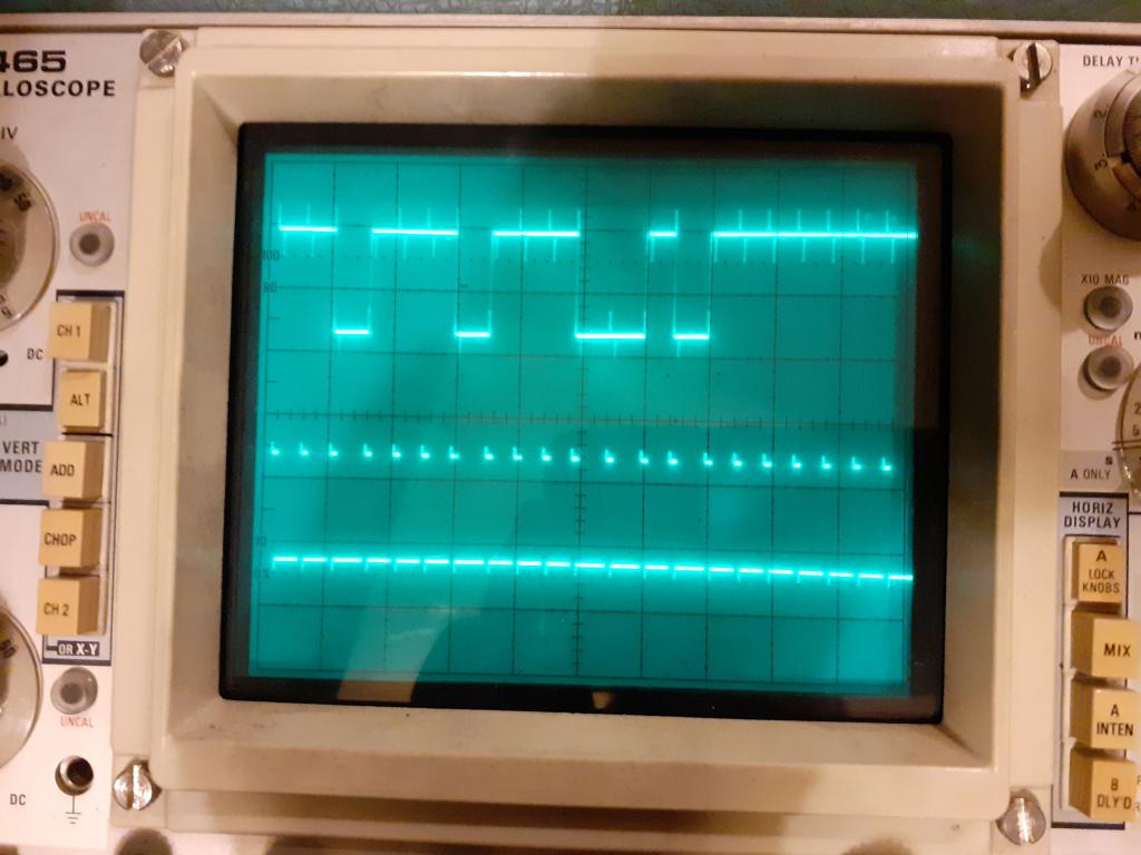

A quick update.
I built the protoboard USB rig tonight to have a look at the signal flow between the DRO and LCD Display. A combination of noise and my lack of skill (I seem to have forgotten everything I once knew about using a scope) slowed progress quite considerably. I eventually re-rigged things and the noise improved but synching was still a problem. It finally dawned on me to dig out a second scope probe and use the clock line to synch on the signal line.
So, there it is, a 21 Bit clock signal that runs for 2ms, followed by a 4ms gap. The data signal occurs during the clock period. So I now have something to work with on the software side.
The iGaging 21Bit Arduino code should therefor be a good starting point but I'm sorry to report that (as you both expected I think) the CoPilot MMB translation isn't going to to work out the box, although there is probably still a helpful framework there for me to work on. That's for another night now though.
IanT
Posts: 3382
Posted: 12:00am 05 Jan 2025
The clock noise on the data line is actually helpful here.
Makes it easy to see that you read the data on the falling edge of the clock.
