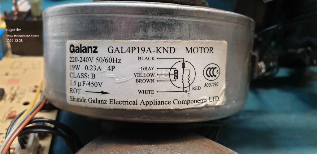

Hi Guys, I’m looking for some help with a fan speed controller please.
When I built my Warpverter I scored a barrel fan from the indoor section of a split system aircon  …  as well as the circuit board and supply.
I thought I’d be able to cobble something together but no success so far.
It will definitely run flat out  …  and I can use a cheapie on/off controller to switch it  …  but it would be nice to have it run at a civilised speed rather than flat out or stop.
The motor is a Galanz GAL4P19A-KND 240V 19W
Apart from the 3 motor winding connections, it also has a 3 wire connector with 5V, Signal and Gnd.
If I power the signal wires with 5V, I get 3 nice clean switching pulses per revolution. Goes from gnd to 5V cleanly.

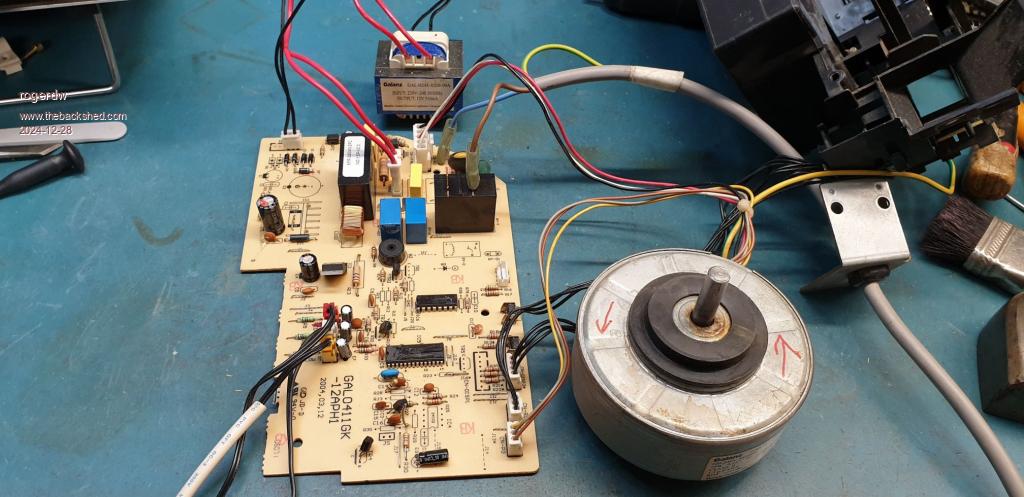

I have the circuit board  …  but it is for the whole aircon control and not just the fan  …  so not much help in this situation.

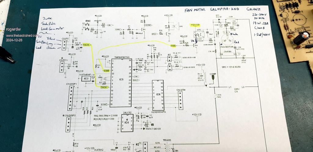

I also have a circuit diagram I found which is the same or extremely close to the board I have.

The circuit is conventional leading edge phase control of a split-phase motor.
Power to the motor is varied by synchronising the MCU with the 240VAC zero crossings and delaying switching the optocoupler to trigger the triac.
Compare the frequency of the feedback signal with the desired speed and vary the trigger delay accordingly.
