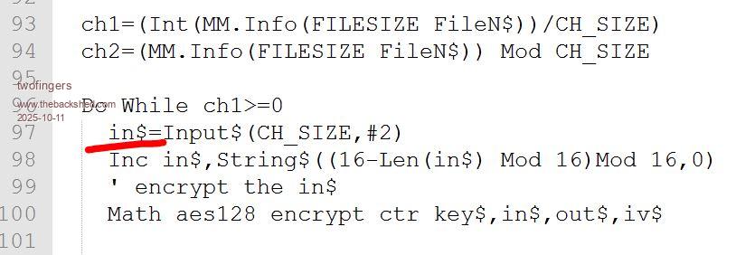

I wanted to try out your AES FILE encryption but only get an Error:
[97] In $=Input$(CH_SIZE,#2)
ERROR: Missing Program Statement

Hi Daniel,
There seems to have been a transmission error.
For me, it shows the following:
in$=Input$(CH_SIZE,#2)
Or is "in" a reserved word now?
Kind regards
Michael

Posted: 12:04pm 11 Oct 2025
in is a reserved word as it is a PIO instruction

Posted: 12:08pm 11 Oct 2025
None of the PIO Instructions can be used as variable names.
Internally MMBasic treats them as commands as part of PIO Assemble. e.g.
PIO assemble 1,"IN null,32 side 2" 'set ISR to 0, GP1 high (load), ‘GP0 l
All these variables will be save internally as Commands.
in$="123"
out$="123"
jmp$="123"
wait$="123"
push$="123"
pull$="123"
mov$="123"
irq$="123"
set$="123"
Paste the above in via AUTOSAVE , and then open in the editor and you will see them stored as commands.
In and Out are the ones you will most likely stumble accross.
In $="123"
Out $="123"
Jmp $="123"
Wait $="123"
Push $="123"
Pull $="123"
Mov $="123"
IRQ $="123"
Set $="123"

@Peter & Gerry
Thanks both of you for the confirmation! The strange thing is that the program worked for me (I'm pretty sure it was with V6.00.01RC10). I've just tested again. "In$" is converted to "In $" with V6.01.00b5.

Ah, ok I understand!
So I just have to change the variable name.
EDIT: I changed the variable name and now the program works just perfect, thank you! I think this could be a great thing to convert it into a GUI application. I have plenty of use for this, for example in my diary / journal program. But first things first...
