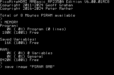

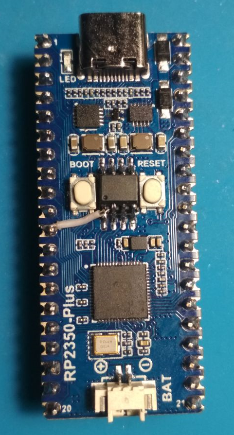

Today I received a parcel with RP2350-Plus and immediately soldered another PSRAM chip on top of the flash memory chip installed on the board.
I have this chip ESP-PSRAM64H
I also soldered the PSRAM chip selection control pin to the GP8 port for my circuit.
The initial welcome screen and the MEMORY command say that all PSRAM memory is available to the user.

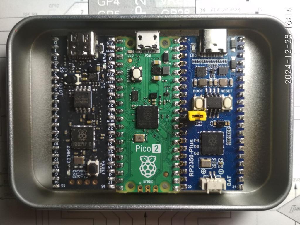

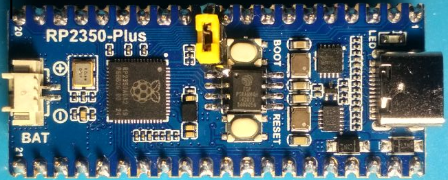

1) Yes, the "Pico2" port pin of the GP8 is connected to pin 1 of the PSRAM chip (ESP-PSRAM64N). Later, I improved this life hack with a jumper that disconnects the line from the GP8 and a pull-up resistor for the CS pin on the PSRAM chip. So that it could be disconnected and connected when needed.
Other Pico2 clones with flash memory in a large case have appeared on AliExpress, to which you can solder a PSRAM microcircuit on top in a similar way.

"Black Pico2" from WeAct RP2350A-V10 or V20 is also suitable for soldering the PSRAM memory chip on top and is not expensive.
https://www.aliexpress.com/item/32778272059.html
https://www.aliexpress.com/item/1005008142140656.html

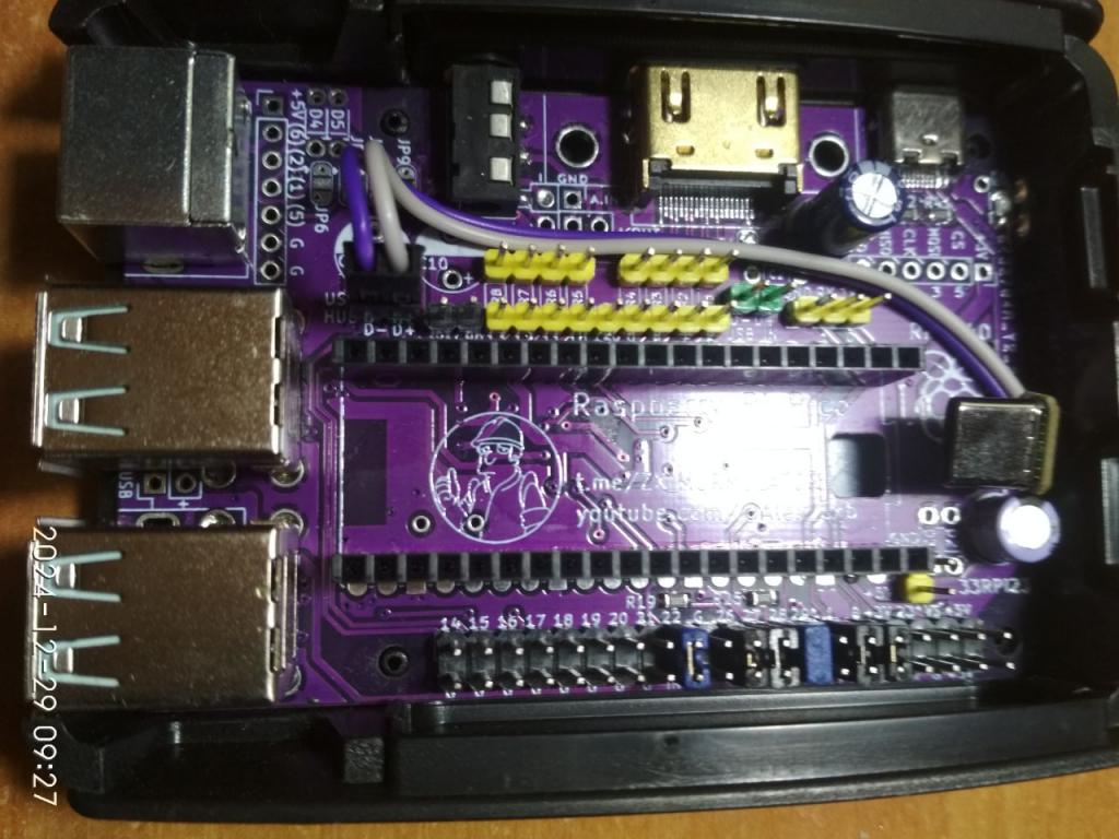

I have an HDMIUSB main board system with stock PICO 2 and would like to get this ram option on that.  Is that possible? That board needs some solder points on the bottom of the PICO 2 so that seems to be an issue. Is there anyone who could make a new board with a socket for the PICO 2 instead of using the Tessellated points?

  mclout999 said  I have an HDMIUSB main board system with stock PICO 2 and would like to get this ram option on that.  Is that possible? That board needs some solder points on the bottom of the PICO 2 so that seems to be an issue. Is there anyone who could make a new board with a socket for the PICO 2 instead of using the Tessellated points?
I think that with desire and due skill everything is possible!
You can solder a PBS connector to the board pads and put a Pico2 module with soldered PLS pins on it.
These Pico2 clones also have USB line pads at the bottom, but they do not match the original Pico2 board. Therefore, you can solder wires to them or take them from the USB Type-C connector itself (as shown in the photo)
