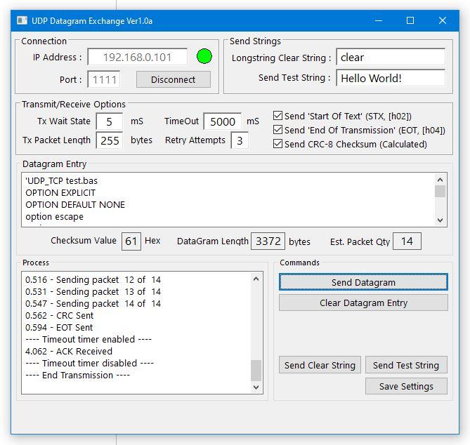

I've been fooling around with the UDP in WebMite lately and wrote some code in TwinBasic that might help some others to test UDP functionality.
Disclaimers :
1) It's my first time using TwinBasic and according the blurbs, there's no RunTime necessary (like VB6 needs) so it SHOULD run 'as is' as a stand-alone .EXE
I don't know if that's true, so if you have any problems running it, please let me know
2) It's a windows app. It's also a 32bit version. Sorry, that's all my TwinBasic version will allow me to do.
3) It's dirty.... very little error traps, it makes a few assumptions and it doesn't ALWAYS work how my mind thinks it should.
Anyway, here's a screen shot
... and the files if there's an interest to try it out
UDP Test.zip
... consisting of the App, the WebMite code and a ReadMe file

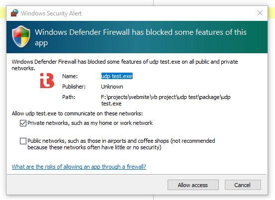

If you would like to install it, you might get windows defender complaining on the first run
Up to you if you want to block it or not
I presume if you block, the App won't function.
Give it a crack, see if it's an option for anyone doing WebMite code. It might be helpfull if you're just looking to send simple commands via WiFi
As a post note, anyone (like me) that's entrenched in VB6, TwinBasic seems to be a great modern-day alternative
Edited 2024-12-28 17:42 by Malibu
