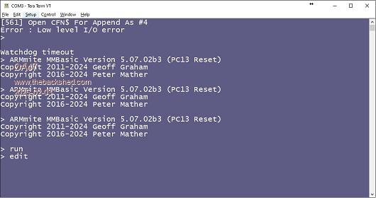

I did try to take a screen shot and lost it with the remote access but I dont think I had to CNTRL-C, there was an error created during a write to the log file with a message something like:
[189] Open CFN$ for Append As #4
Error : A hard error occurred
The console had its banner with a prompt and I typed RUN to no avail and when I typed EDIT it showed no basic program.

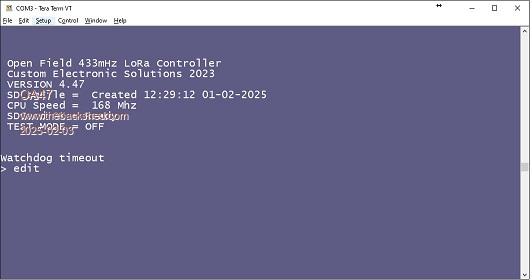

I managed to scroll through the TeraTerm screens and found the screen info for the error the other day.
But I have had the program wiped twice since then around 12 hours apart with just the watchdog notification.
Im a bit lost here.
