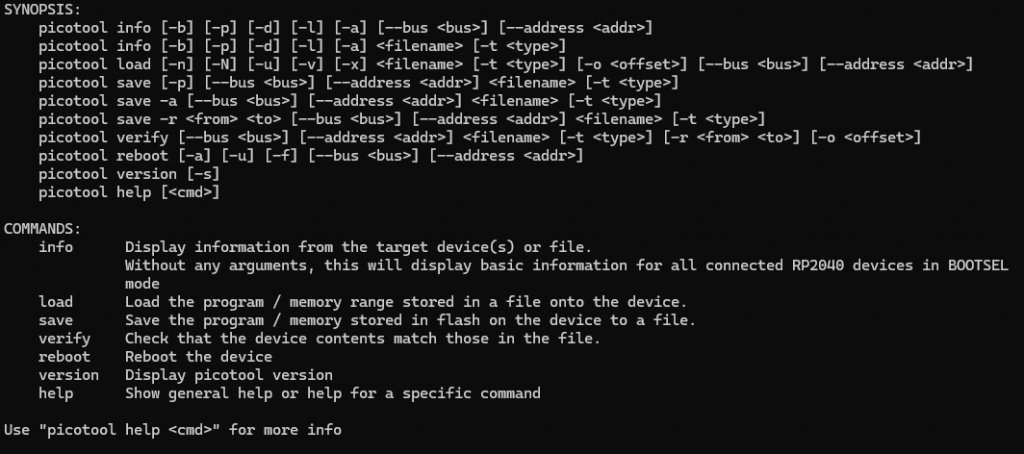

Posted: 08:19am 16 Dec 2024
Hmm, what do I have to enter for "Source device selection"?
       --bus <bus>
           Filter devices by USB bus number
       --address <addr>
           Filter devices by USB device address
Frank

Posted: 09:41am 16 Dec 2024
Hi Frank,
I believe that is optional:
However, if you try running Picotool with the device NOT in Boot mode:
It should be as simple as the example given by Geoff but I suspect that he has SDK-2 with the updated Picotool.
I haven't pursued this due to trying to stay focused on what I should be doing
