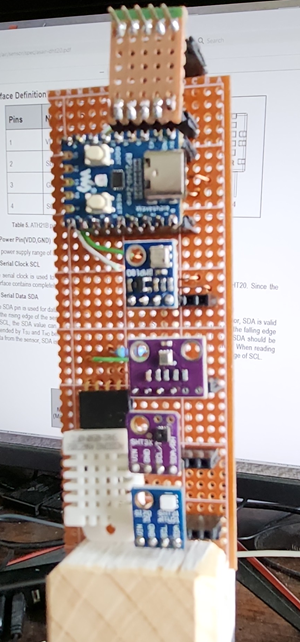

This pair of programs gathers 8 data values from various devices and sends them via 4 Humid commands.
Synchronization is achieved by having a long pause between each group of 4.

Data collector and DHT22 Emulator
Print "multi sensor data collector with DHT22 emulator output v02.bas"
Print MM.Info(cpuspeed);" Hz"
' "DHT11 and 22 Emulator for AHT10 input.bas"
'  One pin version. Link DHTpin and Gnd. to other Pico.
'  If wires are short no pullup resistor is needed.
Const DHTpin = MM.Info(pinno GP6)

I have been comparing various sensors, looking for reliable temperature, humidity and pressure in the one chip.
The DHT20 is worth a try but pinout is odd and I will have to make a special socket for it. I need to redo the board anyway so not too bad. I will be dropping the DHT22.
I like it when all the modules can be interchanged easily. It makes comparisons easier.
My test results so far:
Temperature BME280 20.5, HTU21 20.1, BMP180 21.6, DHT22 20.5, SHT31 20.6
Humidity    BME280 50.4, HTU21 63.7,              DHT22 43.4  SHT31 60.8
Pressure    BME280 1011.0            BMP180 1010.2
The temperature on all modules compare very well.
The SHT31 humidity is the most believable so far.
On another BME280, the humidity has gone to 100% without any recovery. I don't expect much better with this one.
DHT22 humidity varies from 40 to 75% depending on the module I choose. All were "new"
Putting the pico at the top stops it's heating upsetting the readings when the cover is on.
Next step is to move the sensors out into the real world.
