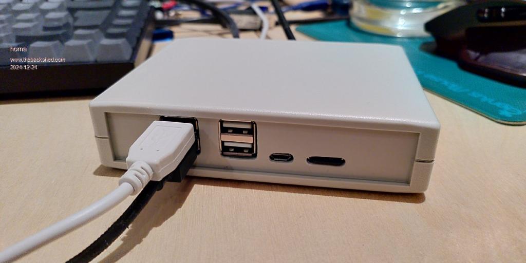

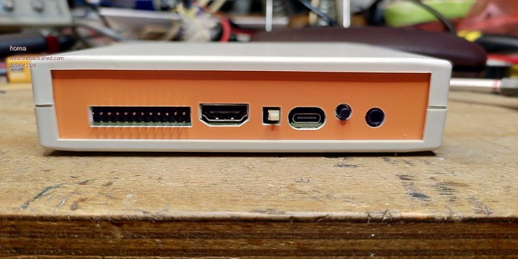

Front housing and cnc with plastic are not compatible, I prefer to stick to milling wood with my modest skills.
Now I have to find someone with a laser ...
The order and completion of the project are completed so far.
Matthias
@Michael (twofingers): Noch Interesse an einem kompletten Bausatz (Board, rp2350, Gehäuse)? Dann schreibe eine PN. Löten und die Fronten musst du selber machen oder ich finde die Tage noch jemanden mit Laser.
Still interested in a complete kit (board, rp2350, housing)? Then write me a PN. You'll have to do the soldering and the fronts yourself or I'll find someone with a laser in the next few days.

  Quote  Front housing and cnc with plastic are not compatible,
It can work OK. You need a 2mm single flute bit and turn it quite slowly

PS: Maybe it would be enough if I printed the front panel
'no comment
Posts: 9328
Posted: 01:01pm 24 Dec 2024
If you print the front panel, laminate it and cut it out neatly it can often cover slightly oversize holes in the plastic. I've done this before and it worked ok. For this sort of case you really need to stick the print down then trim it so about 0.5mm of plastic shows top anb bottom and about 1mm at each end. Any reasonable double sided tape is fine.

  Mixtel90 said  If you print the front panel, laminate it and cut it out neatly it can often cover slightly oversize holes in the plastic. I've done this before and it worked ok. For this sort of case you really need to stick the print down then trim it so about 0.5mm of plastic shows top anb bottom and about 1mm at each end. Any reasonable double sided tape is fine.
Yes, there are various good options for creating the front panels.
I was thinking of 3d printing instead of milling and drilling. You can also get a label by changing the filament for the last 2 layers.
Happy christmas holidays
