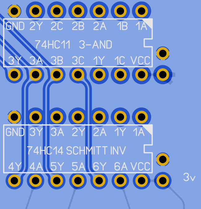

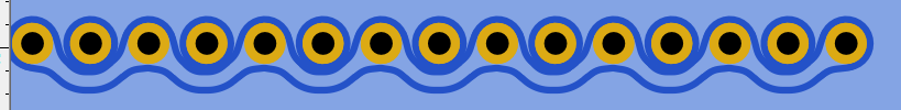

Trivial, yes but there's just something satisfying about this:

I tried it but we didn't get along. If you start doing things like moving traces around or deleting them once the teardrops have been applied they become a track plus two triangles, which have to be deleted separately. You can remove all the teardrops at once but not individual ones.
I'm flippin' rough, me. No niceties. :)

  Mixtel90 said  I tried it but we didn't get along. If you start doing things like moving traces around or deleting them once the teardrops have been applied they become a track plus two triangles, which have to be deleted separately. You can remove all the teardrops at once but not individual ones.
I went through that, Mick but I have mastered it and now it's 2nd nature. Not a hassle at all. Probably not important in this context but I just don't like abrupt transitions. Comes from machine designing, I guess.

PCB manufacturers do not like this:

  Volhout said  Phenix,
The pointy bits? Do they reject the design or do they make changes?

Pointy bits can cause the copper to peel during etching, you tend to get bad edges.
Also watch out if you are running parallel tracks and there is a miniscule area of ground plane between them - it can get etched away. In fact it usually doesn't matter, but you might be affecting the ground plane in some cases and lose a connection.
Whether a design gets rejected depends on how good the checking is, I suppose. :)
