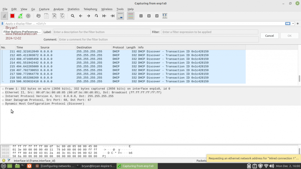

Well my old laptop with ubuntu has a ethernet port so brought that up to the shed and thats when the fun started.
Also brought up the ethernet bridge so connected the S9 to it and the laptop but for some reason the ethernet port on the laptop refused to see the S9. So got online to get some pointers on how to get it going.
So lfup eth0 came back with device not found
doing a lfconfig -a showed enp1s0 as the ethernet port so did a
lfup enp1s0 came back with device not found.
Now thanks to Andy I downloaded wireshark for linux in the software centre and doing a scan on enp1s0 there is no activity. I was fooled at first as the scan was pointed a wsp1s0.
When the S9 is turned on I can see from the led it is trying to broadcast but the laptop just isn't seeing it. So tried out that wifi dongle where it showed up as wifi straight away but no net but even when the etherent cable is inserted in the router wireshark still shows no activty. Also on the bridge the S9 is showing up but the cable from the laptop doesn't show as active.
So if any linux guy's can help out to get this ethernet port going on the laptop it will be great.
Regards Bryan

Andy-g0poy
Joined: 07/03/2023
Posts: 86
Posted: 06:10pm 02 Dec 2024
The DHCP Discover packets are from something looking for a DHCP server so that it can get an IP address.
So that's why you are not seeing any IP addresses yet, it has not found a DHCP server so no IP address has been issued.
Shove in a manual IP address, mask, and gateway, that should poke things into life.
Or find out what is supposed to provide the DHCP server functionality and check that it is working.
Remember it is very bad news to have TWO DHCP servers on the same network you will get all sorts of IP address clashes. It can be done but you have to limit the DHCP address ranges very carefully on each server.
Many if not most routers will provide a DHCP service, as will a lot of "range extenders" Some are very configurable others not so.
Andy
